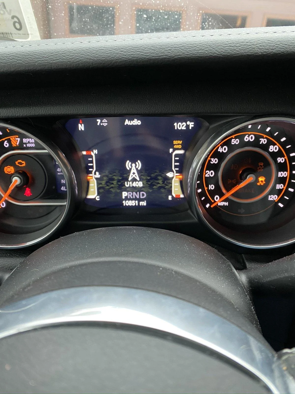

I have a 2018 jeep jlu Sahara and I had problems with my taser jl. Just wanted to know if anyone else has had this problem. I bought a tazer jl lite and installed it in my Jeep. I followed all the steps in the instructions but what I didn’t know was that the tazer was married to another vehicle before mine. When I was going through the menus I accidentally pushed full reboot and I got a service 4wd light, service electric stability control, and a abs malfunction. I took out my tazer and used a scan tool to find the code implausible data from wheel speed sensor. I sent my tazer jl to z-automotive got it back properly married it and no luck. I tried everything. I’m just confused on why this happened to my jl. Was there a problem before that wasn’t recognized by the security gateway module or did the tazer jl cause a fault in the computer. I had tried to clear these codes but they are hard codes that wouldn’t clear. I took it to my dealer and they said it was a wheel speed sensor. I know some people have had problems with their wheelspeed sensors but it seems pretty ironic that the peedsensor went bad when I rebooted the jl system. Anyissues like this?
If a wheel speed sensor is bad, it will throw a code. Did they read the codes?

Update from my previous post. I took my Jeep to the dealer and it turns out a wire was shorted out and corroded and bonded to the frame. The dealer said it’s just the way some of the Jeeps were wired. If you get any codes make sure they check for shorted out wires!!
