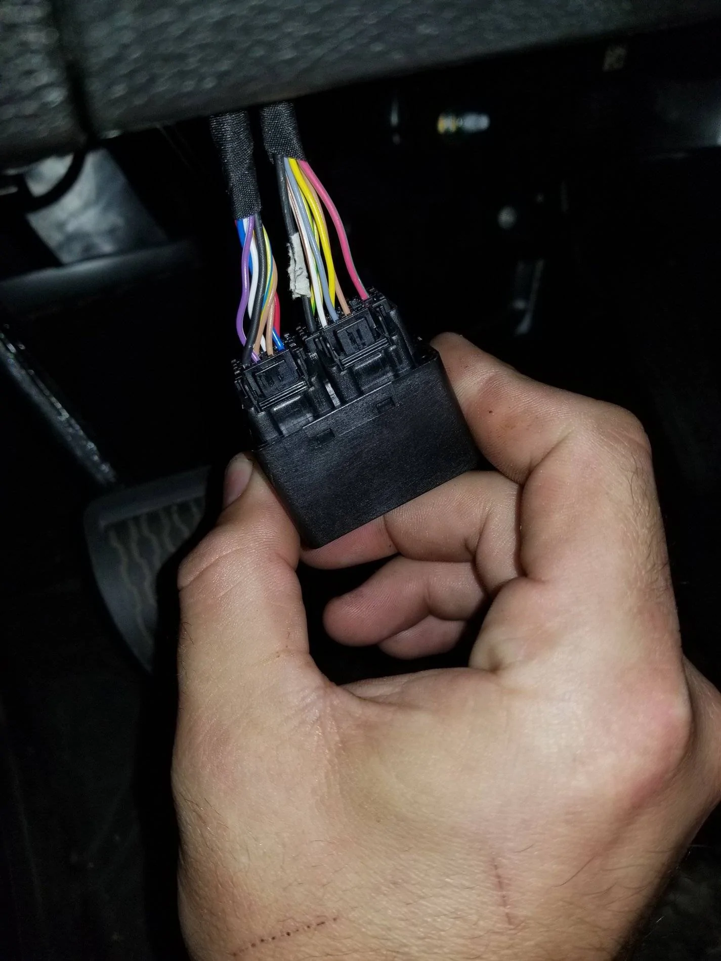

Thank you for the information, ordered the JL mini however it just arrived and I think it is not the correct one in the box, I checked all the plugs under the dash by the OBD port and could only find one plug that would fit into the tazer. Is anyone using the Tazer JL Mini if so could you send a pic of the plug in side of the tazer so I can see if it is different or if I am just a moron.
Circled in red... Both Tazer JL Lite and Tazer JL Mini connect to the 2 cables you de-tach at the security gateway in the circle.
Tazer JL attached ...
Jeep Wrangler JL Tazer JL Lite 20180426_194230

Thanks, I figured it out after searching YouTube videos.
