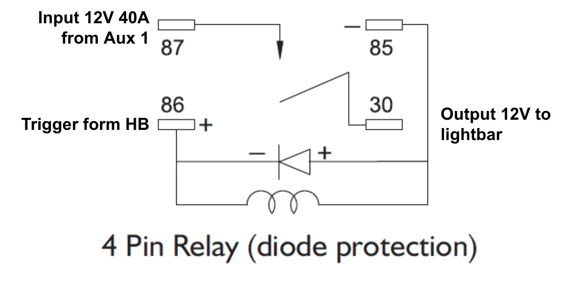

Just revisiting this discussion. To make sure I understand...
On a JLUR with the Aux switches, could you use the output from one of the 40A Aux switches (Aux 1 or Aux 2) as input (pin 87) to the relay and then trigger the relay (pin 86) using input from the highbeam? So, I single 4 pin relay with diode protection. For good measure, include an inline fuse between the Aux 1 output and the relay.
Jeep Wrangler JL Tapping into headlight wiring 1625729787692
Thanks
