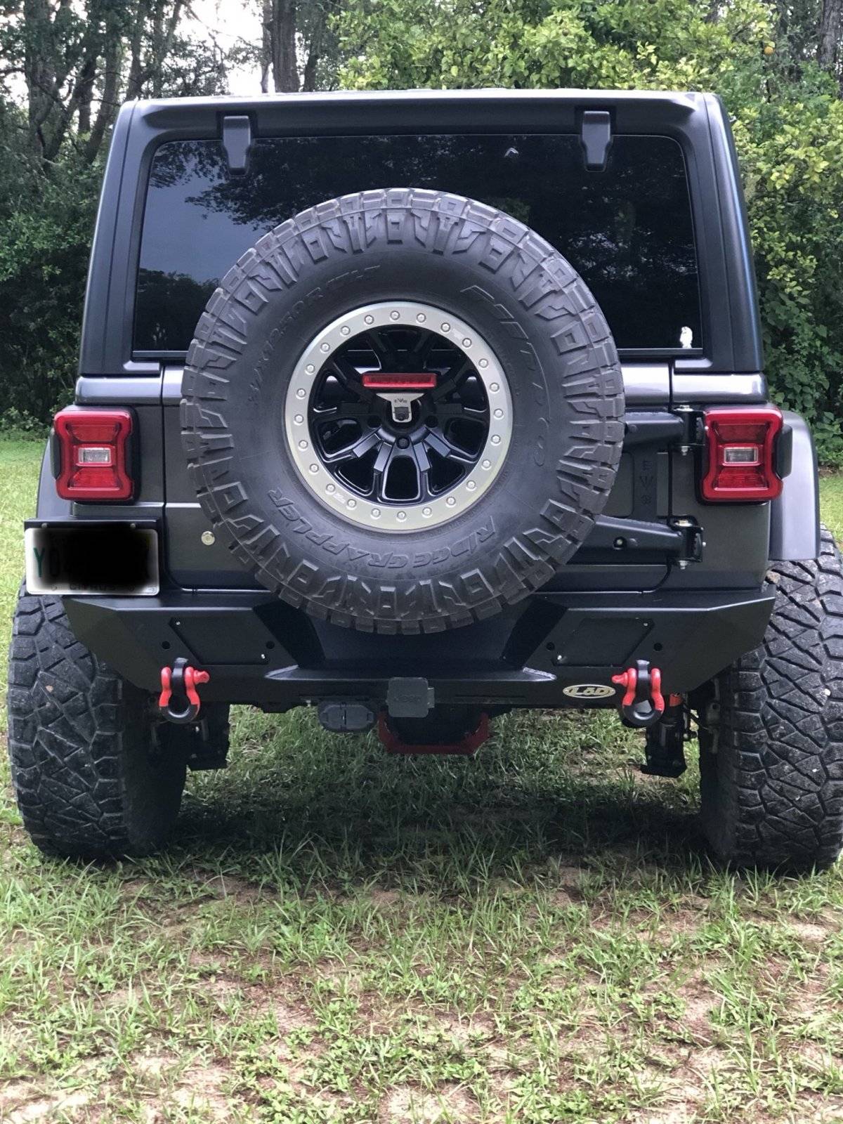

i have 35" bgfs km3 on 17" steel wheels, i went with the rockhard 4x4 with a tire carrier. Mainly went that route because i like its license plate mounting (one of the few on the bumper and not in the way of trees, and i dont like spare tire mounting of plates), relocation of the trailer hitch and plug, and i want to carry more on my rear than the spare (jerry cans, hi lift, cd antenna, with space for additional jerry can and basket) which their carrier gives
i was looking at tailgate reinforcement and hinge replacement brackets, and decided if i was going to get one it would be for a whole hinge replacement not just reinforcement reason being even with just the added weight of the spare i could tell the tailgate was sagging when opening and closing and did not trust the stock hinges to be up for the added weight. but i decided not to go for the hinge replacement carrier because of price, after you factored in the cost of a bumper and the carrier i was looking at the price of the rockhard 4x4 bumper/carrier

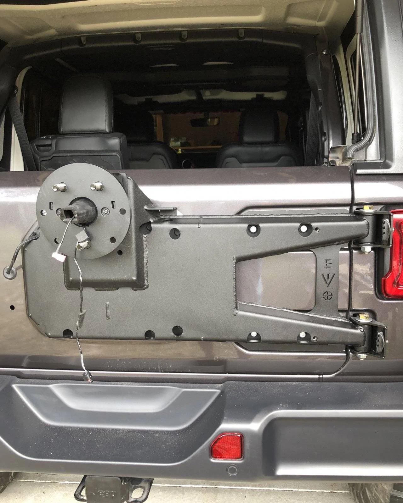

I agree. I love that it replaces the hinges and is quality support, but mine is rusting like crazy.
Damn that is insane. The protective coating on that got demolished, and the hardware on the side of the hinge is rusty too.
I actually really liked the form and function of this unit, but that looks bad. I wonder how well the coverage is for the powder coat inside the frame, yours is rusting like crazy where the bolt cutouts are too. You must live in Michigan or something and the salt did work lol
