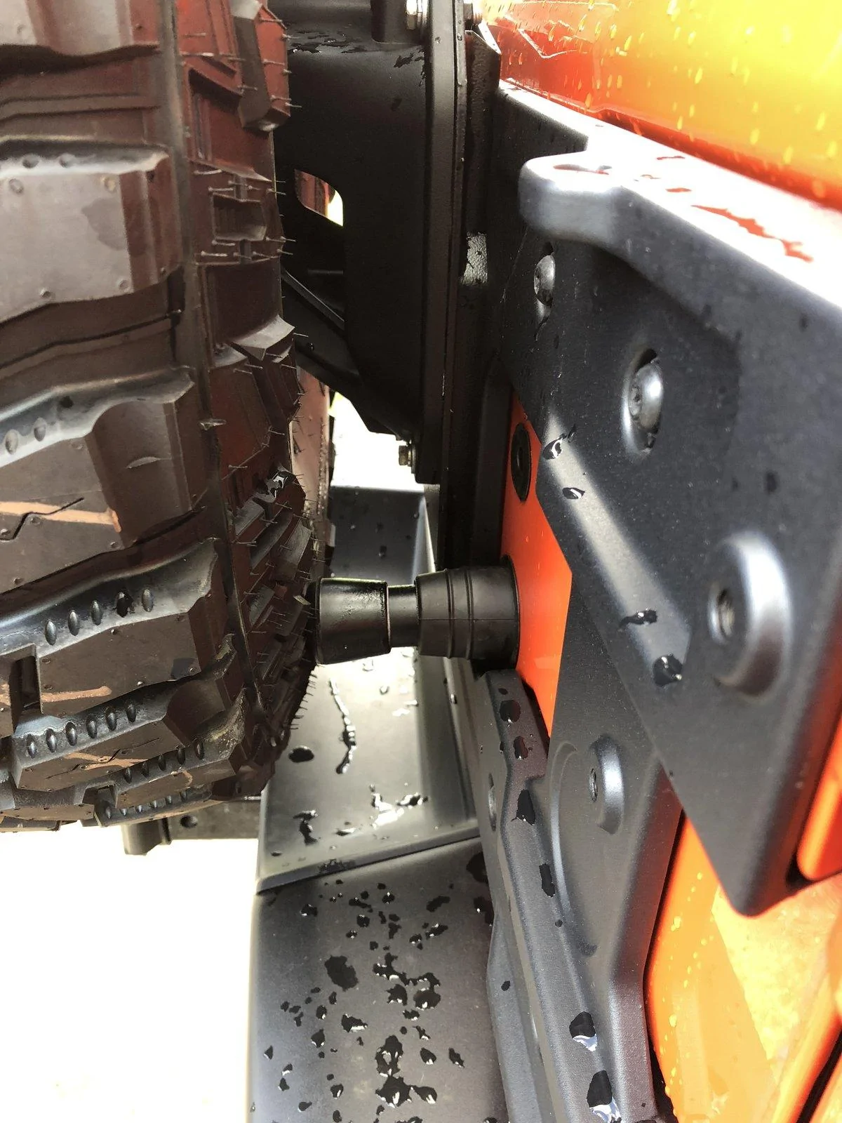

Hey, sorry it took so long to get a picture here. Like I said, I had just white PVC 1.25" and then put them into these white rubber chair tips I got. Painted them both black with rustoleum and fit them into the existing bump stops. I'm glad they're not an annoying white anymore.
Jeep Wrangler JL Tailgate strength IMG_3731

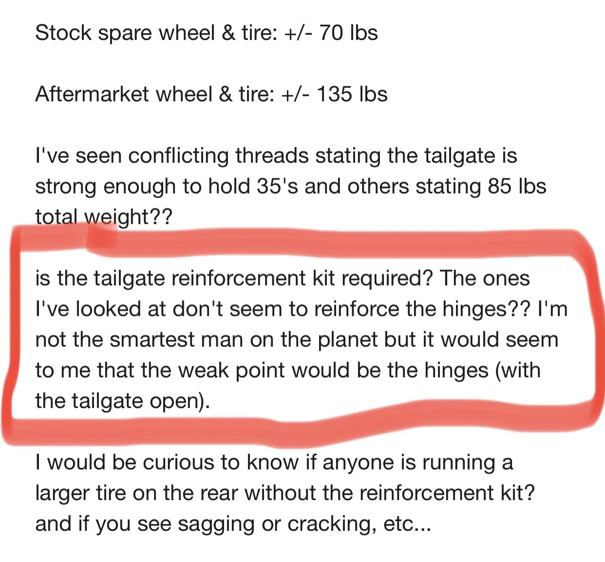

This is correct, but it is correct in the same way that saying brighter colors do not make you go faster. Reinforcing the hinges was never the point.
From the original post:
Jeep Wrangler JL Tailgate strength B204EB36-8B12-4811-A6EC-9986DA0B0358

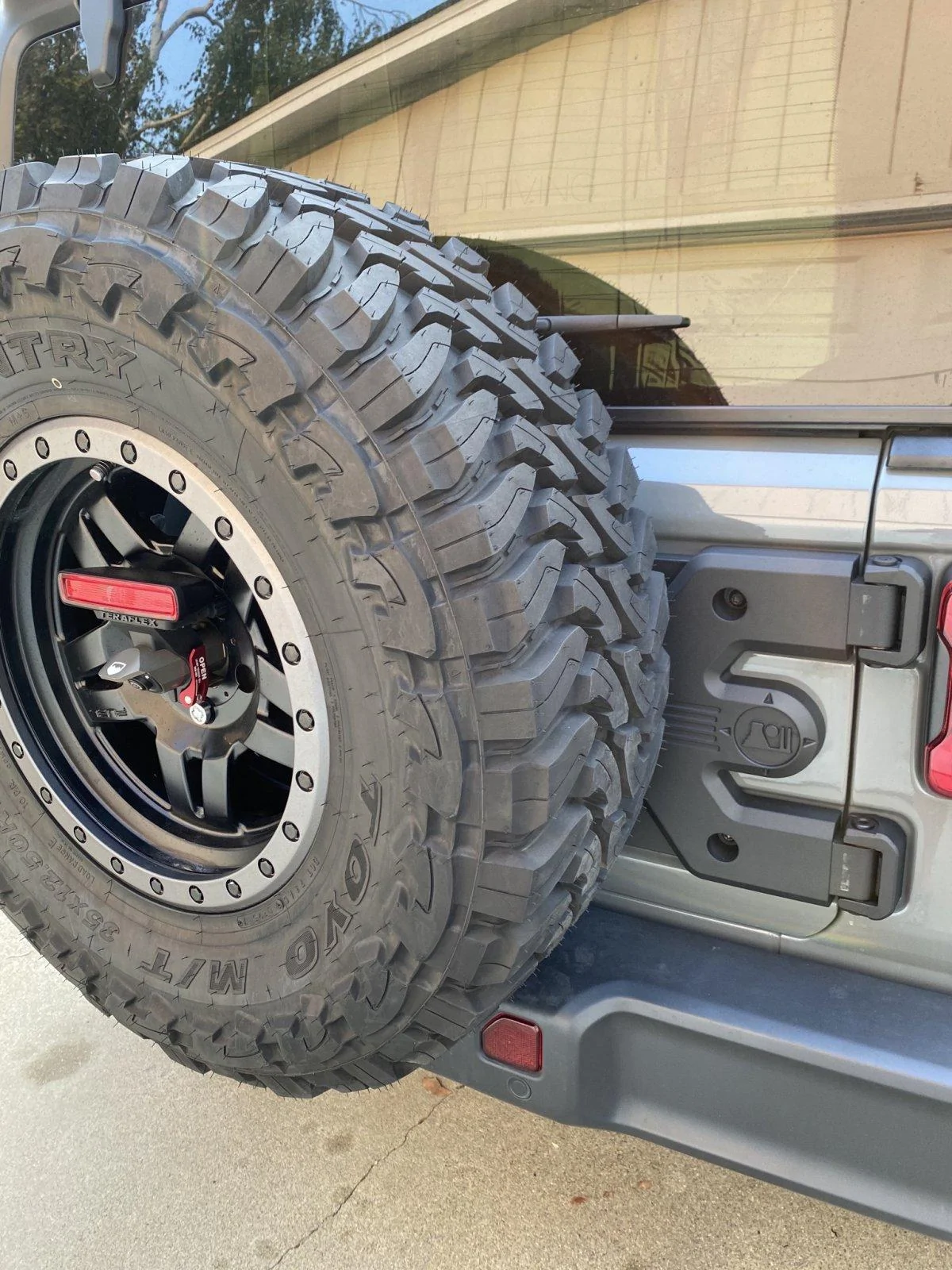

The Rugged Ridge Spartacus reinforcement kit replaces the factory hinges, with much more substantial ones. That is what i am using with 35s and Methods. Rock solid.
easy weekend afternoon job. heavier hinges integrated into tailgate reinforcement. Rugged Ridge was smart to be first to market with this.
Jeep Wrangler JL Tailgate strength 8528CDBB-675B-402C-9CD6-734E9C24F505
I stand corrected, wasn’t aware.
