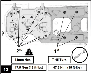

Does anyone know the torque specs for those bolts? thanks

From the mopar tailgate reinforcement instructions:
Jeep Wrangler JL Tailgate bottom rubbing - paint coming off upload_2020-1-23_17-20-44
