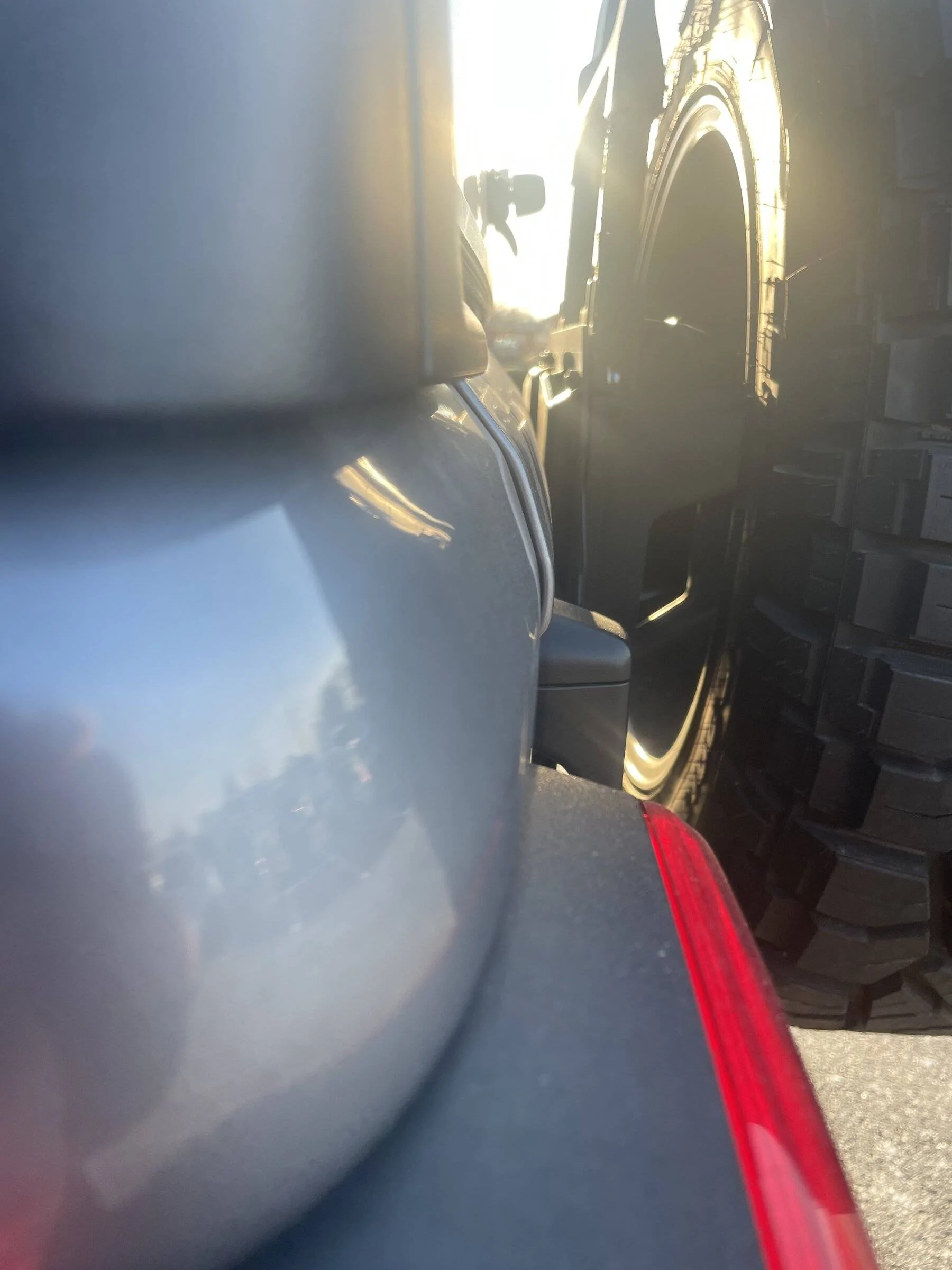

I live in the city so I experience a lot of bumping. With a stock tire carrier, the tailgate is starting to bend out. If you look at your wrangler for reference, you shouldn’t be able to see the tailgate like you can in this photo. The bottom part is still in place, suggesting the bumping of the spare is causing this. I have a 35x12.5R20 with a -44mm offset wheel. I finally got a hinge reinforcement, but am looking for suggestions on a spare tire carrier that would bring the tire closer to the tailgate and minimize the wobble of my spare when going over bumps. I would get a rear bumper with a carrier
if I could, but I just can’t afford to spend the $1500-2500 on one. Thank you in advance!

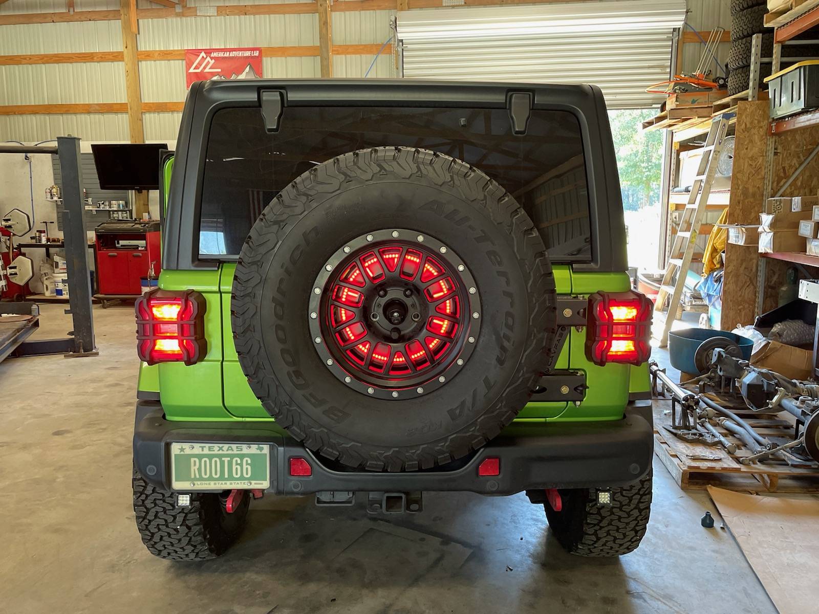

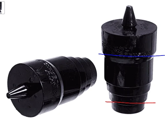

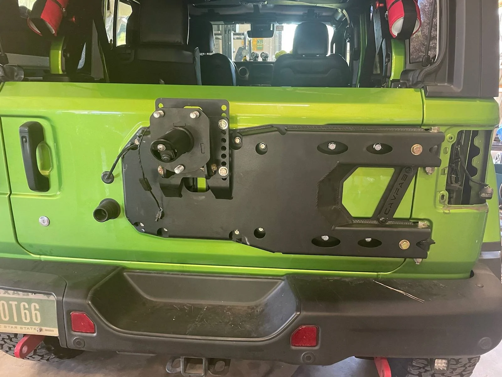

I used the same ones, as @DrBob said they go in the existing holes. For reference, when I first put them on with the aftermarket wheels on the stock carrier, I trimmed to the red line.
Going to the TeraFlex HD Alpha carrier, I pulled the tire in much closer so my backup sensors would work again. I had to trim them to the blue line.
Jeep Wrangler JL Tailgate Bending with Oversized tires 1643653455370
Wheels are 4.75" backspace and 0mm offset according to the manufacturer.
