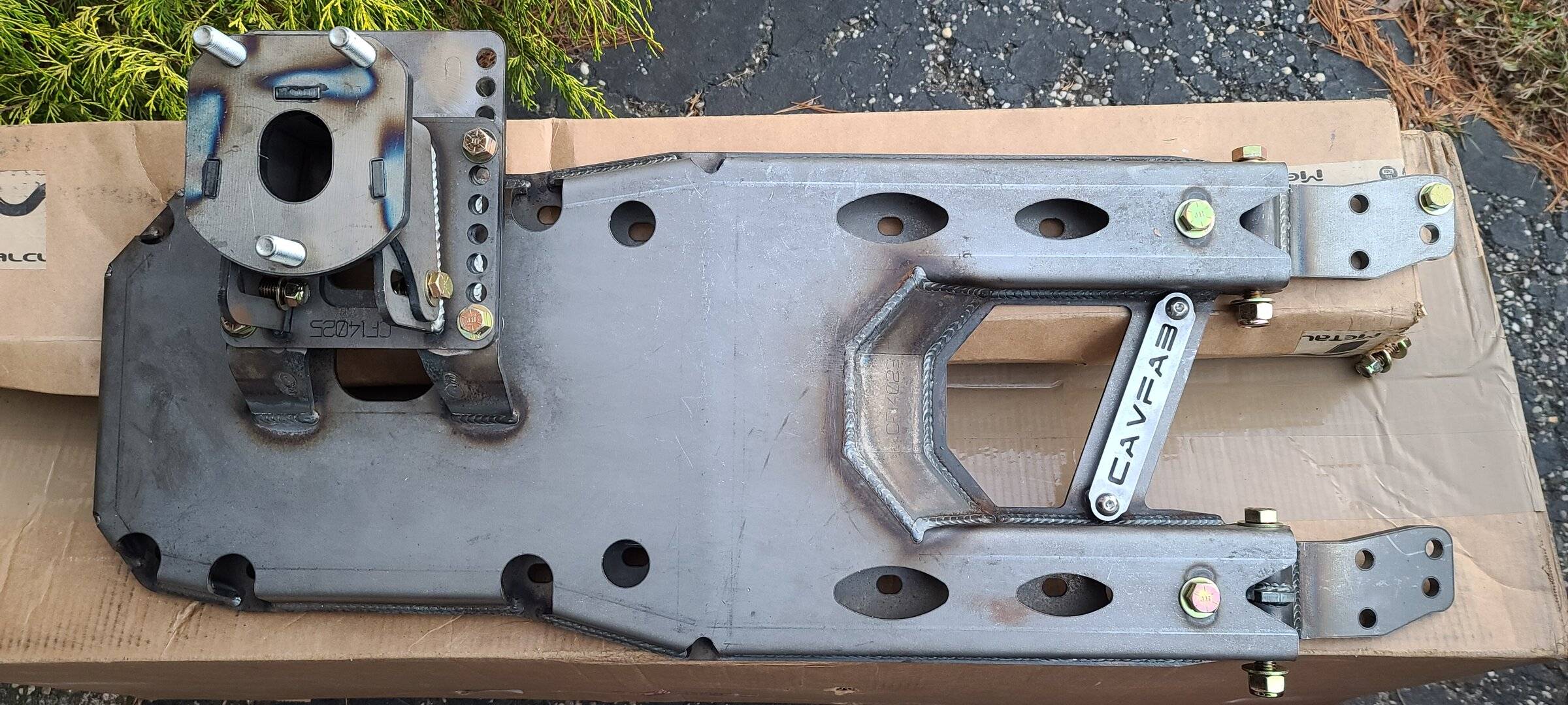

The Cavfab Elite is an awesome product. It gets delivered in raw steel, so you'll have to find a reputable finisher to powder coat it for you. It's still a great deal, as the product is incredibly strong and well designed and it leaves it to the owner to have it finished however one wants. I had mine powder coated to match the lightly textured black of the mopar steel bumper with the nameplate matching the gloss red factory tow hooks.

I chose it for the 38's I had at the time, and the 40's I have now. If you don't plan on running at least 37's, the Cavfab is a bit of overkill.

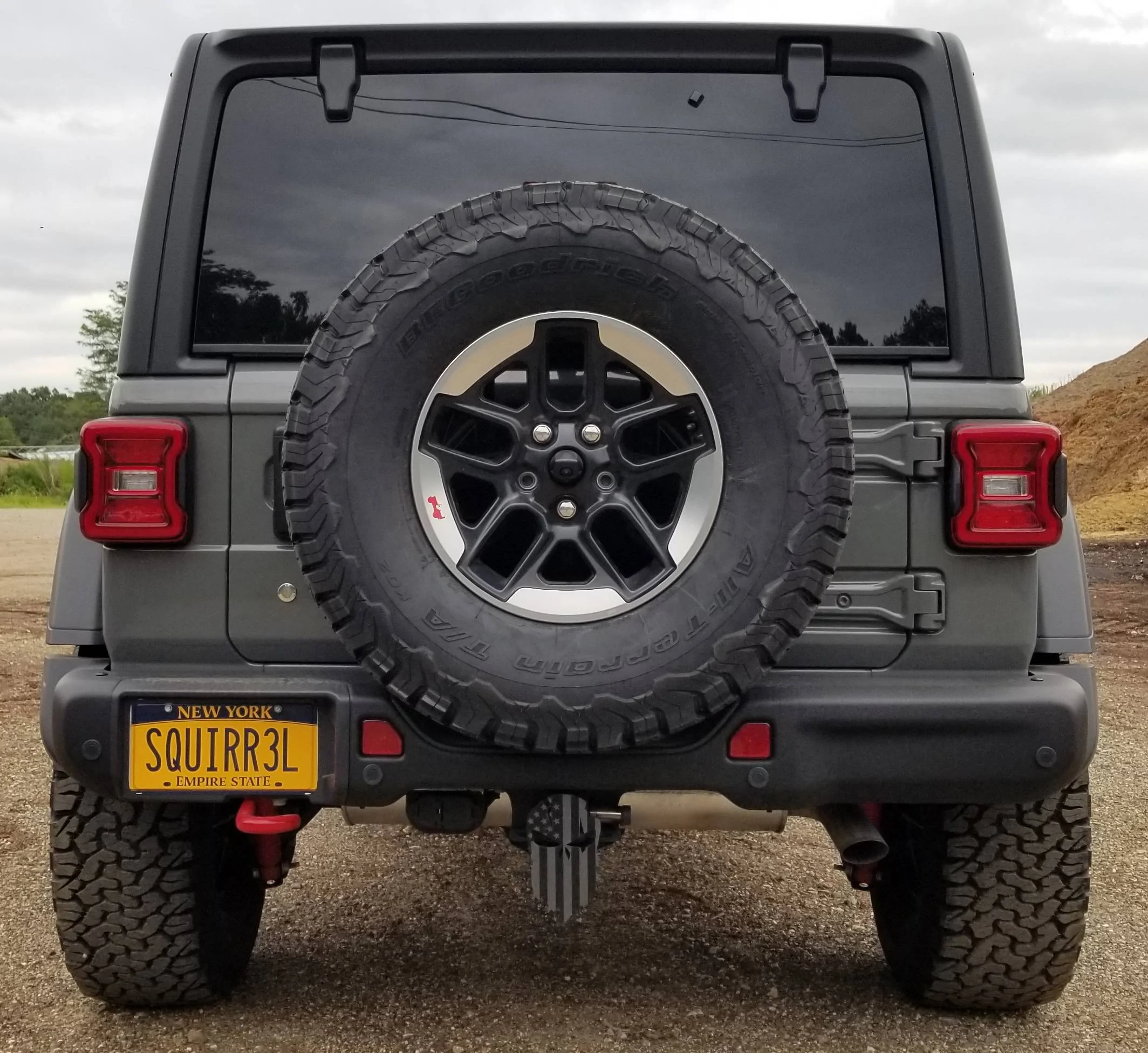

A simpler solution for 35's, is the Teraflex Alpha HD carrier. Just the carrier, without their higher priced tailgate reinforcement. I had that carrier when I had 35's, and it worked great. It's fully adjustable so it can be set high enough to clear the bumper, but more importantly, it adjusts to accommodate different tire widths and wheel backspacing. This allows the spare to be as close to the gate as possible and fully pressed into the rubber gate bumpers, which minimizes the cantilever effect that amplifies physical weight and also minimizes movement.
Here's comparison pics of both the factory carrier and the Alpha HD set to the highest position with my 35" ko2's.

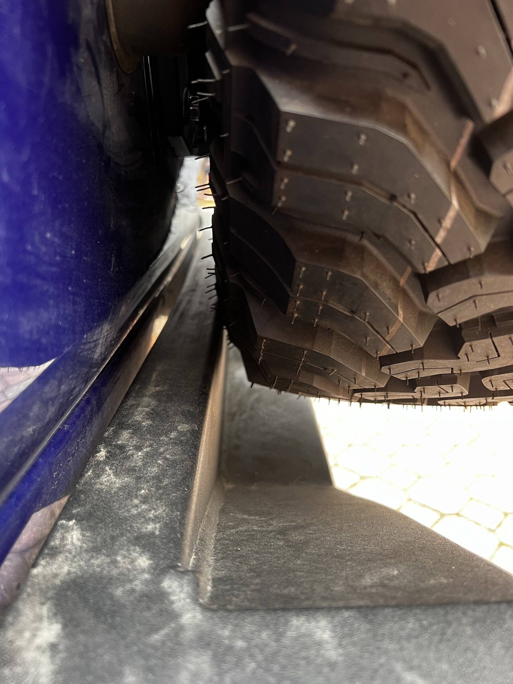

So, I picked up a used rubicon tire carrier for like $20 and installed it. It definitely pulled the tire closer in, so it seems to have done its job in that regard. Does anyone know the factory torque specs for tightening the plastic carrier to the tailgate? When installing the RC relocation bracket (which I was finally able to take off)it was 18 lb ft of the bracket-to-tailgate, so I just used that, but I'm not sure if this is correct.
Secondly, I noticed that the tire is still making contact with the rear bumper. It doesn't interfere with actually closing it at all, but it definitely shakes the tire when I close it. Is this necessarily a problem? Is it worth it trying to move the bumper closer into the body?
Third, I can't help but think I'm still hearing a thunk coming from the back every time I go over a sharp bump. It sounds like the tailgate. It's not really a rattle so much as a "thunk". I've seen people adjust that little black wedge under the striker or line the trunk with weatherproof door seals to stop vibrations, but I'm not really sure if any of these will work of if it even is the tailgate making that sound.

Jeep Wrangler JL Tailgate Sag With Rubicon Take-Offs F9738909-DF81-4EC8-BDA4-49B9C253A6A0
Here’s a photo.

Here’s a photo.
It may be possible to get a bit more clearance between the tire and that edge of the bumper by loosening the bumper bolts and pushing the bumper towards the body as they are retightened.
18ft/lbs sounds about right for the carrier mounting bolts, as the nut plates inside the tailgate aren't very strong.
