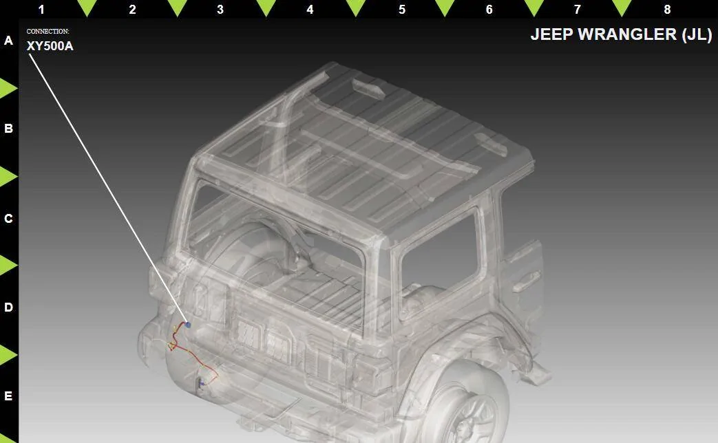

I have a 2024 Rubicon. I changed the rear bumper and tire carrier. The new tag location is in the spare tire now. I need to know the wire location and color for the tag light. I can't seem to find what I'm looking for. Does anyone have any actual experience with the 2024 wiring?

This what you're looking for? You can also tap into "LICENSE PLATE LAMP DRIVER" on connector XY500A.

XY500A
Connector Details
  • Harness Family:
    REAR BUMPER
  • Color:
    BLACK
  • Gender:
    FEMALE
  • Part Number:
    807-479-501
  • Part Description:
  • Connector No:
    X500A
  • Option:
    Standard
  • Repair Kit Part Number:
    Mopar Connector Repair Kits
  • Cavity Count:
Connector Views
Mating Side:
Jeep Wrangler JL Tag Light Wiring {filename}
Wire Insertion Side:
Isometric View:
Location Views
StandardView
PinCircuitWire ColorGauge/SizeFunctionOption
1D704WH/DG0.35PARK ASSIST SIGNAL 10
2D701WH/BU0.35PARK ASSIST SIGNAL 8
3D703WH/OG0.35PARK ASSIST SIGNAL 9
4L3WH/DB0.50LICENSE PLATE LAMP DRIVER
5D710WH0.35PARK ASSIST SIGNAL 11
6L898WH/DG0.50FOG RR LAMP FEED 2
8Z915BK0.50GROUND
9X700GY/OG0.35REAR PARK ASSIST SENSOR SUPPLY
10X750GY/BU0.35REAR PARK ASSIST SENSOR GROUND
12L899WH/OG0.50REAR FOG LAMP FEED
XY500A
Connector Details
  • Harness Family:
    Body
  • Color:
    BLACK
  • Gender:
    MALE
  • Part Number:
    807-378-511
  • Part Description:
  • Connector No:
    Y500A
  • Option:
    Standard
  • Cavity Count:
Connector Views
Mating Side:
Isometric View:
Location Views
StandardView
7N0NA0NO CONNECT
8Z915BK0.50GROUND
11N0NA0NO CONNECT
1Z915BK0.35GROUND
2L3WH/DB0.50LICENSE PLATE LAMP DRIVER

The connector should be right where you removed the bumper. The lamp light wires are white with a dark blue stripe and a black wire.
I forgot to mention, if you disassemble your original rear bumper, you should be able to remove the harness that powers the light. It might be long enough to extend up to the spare tire.
Thank you, I will look next time i go out.
I had to extend mine.
