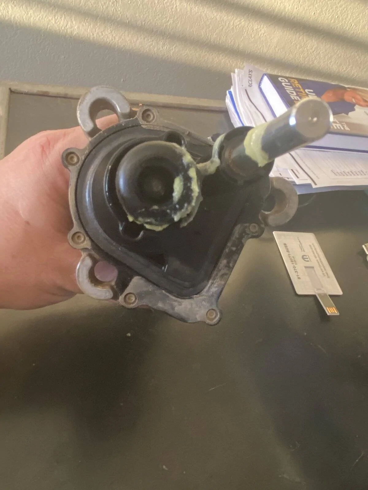

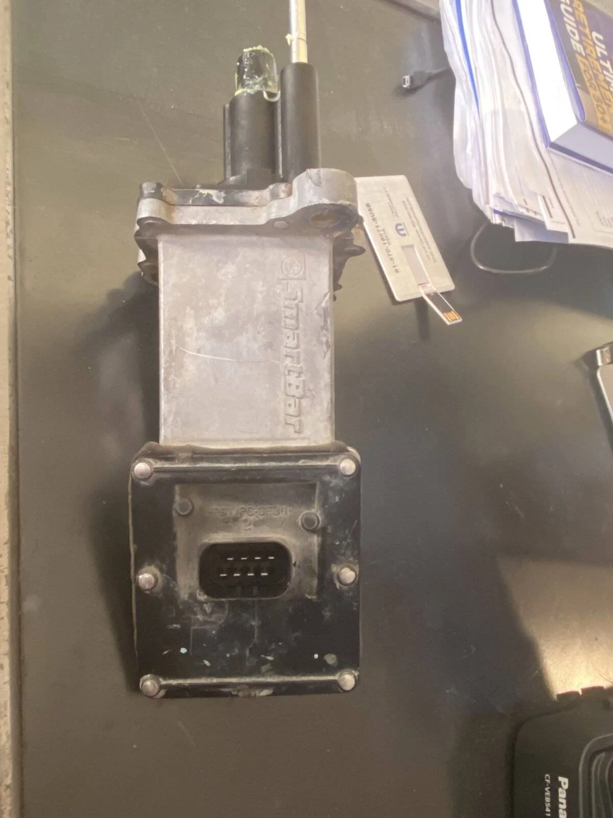

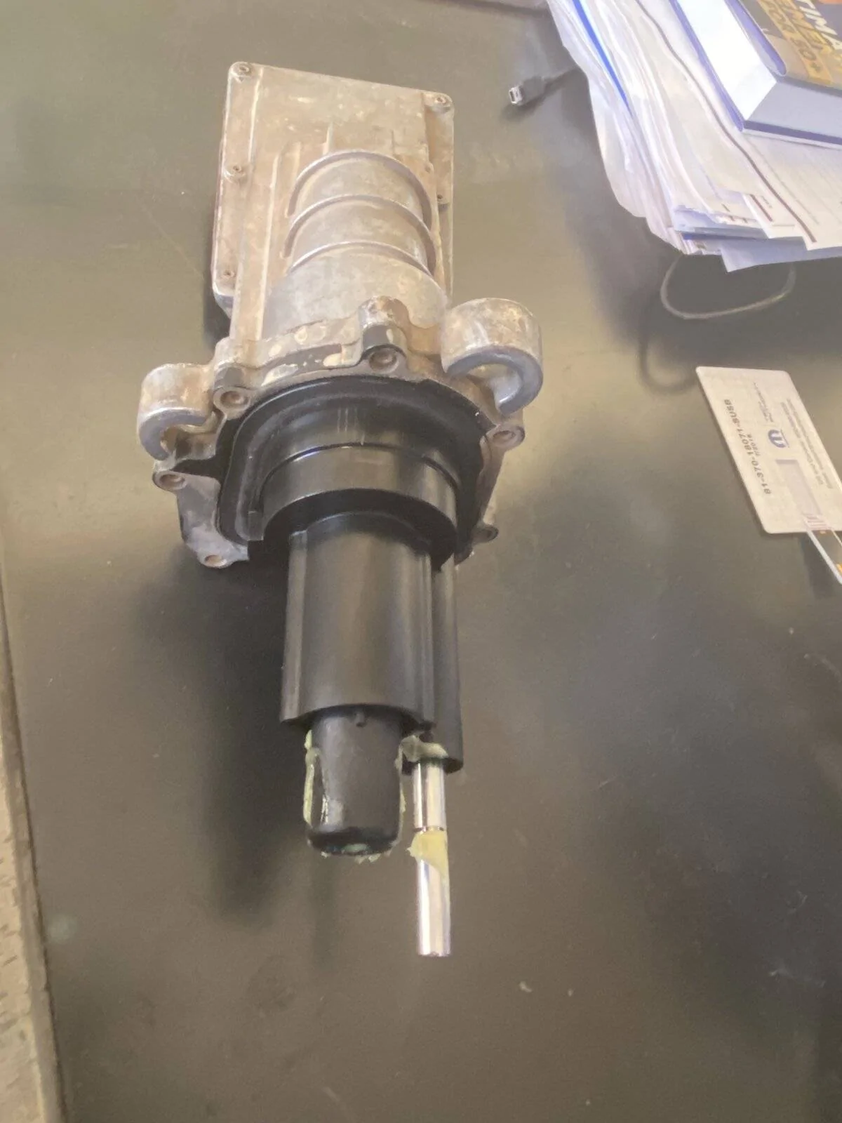

Having issues with an error code on my dash which says Swaybar Disconnect Not Available. I have done some troubleshooting:
  1. Put it in 4 high and pressed the pressed the sawy bar button.
  2. Made sure the jeep was level and tried again, also stretched out the suspension to see if it would work.
  3. Checked the fuse called 'Smartbar', It's intact and seated properly
  4. Removed the sway bar and the gearing and sliders inside are clean and well lubricated, looks new inside
  5. Separated the electronic module and hooked it back up to the wiring, pressed the sway bar button, nothing changes. Also depressed the electronic sensor on the motor while pressing the sway bar button.
I do have an aftermarket bumper and i noticed when I flex the sway bar the wiring that runs to it rubs up against the edge of the bumper. The wiring looks intact and I don't see any obvious damage. I tried wiggling the wire and still nothing. The motor looks well sealed so hopefully no water intrusion.
Any ideas? I'm not much of a electrical trouble shooter but I do have a bit of diagnostic equipment, multimeter, circuit tester and power probe.
Any help much appreciated. Don't want to go down a rabbit hole of replacing expensive unavailable parts for no reason if possible.
Jeep Wrangler JL Swaybar Disconnect Not Available IMG_3994
Jeep Wrangler JL Swaybar Disconnect Not Available IMG_3995
Jeep Wrangler JL Swaybar Disconnect Not Available IMG_3996

And you are getting signal to the motor? I assume you’ve checked the connector on the wire harness to see if it’s getting signal? That would help narrow down if it’s the motor or the jeeps wiring or computer.

I have not tested the connector on the wiring harness yet. Not sure if I know how to do that.
