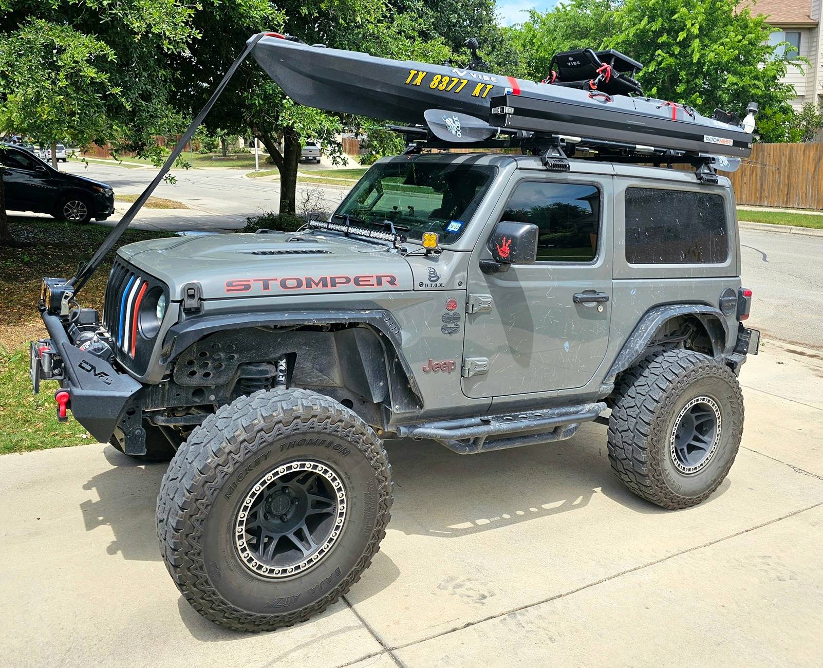

SUPs on Amazon chineseum bars, kayak on Rhino Rack HD bars. 75+ mph, 100s of miles. No problem other than the gutter mounts on the Rhino Rack bars don't stay on tapered freedom panels for s**t.
