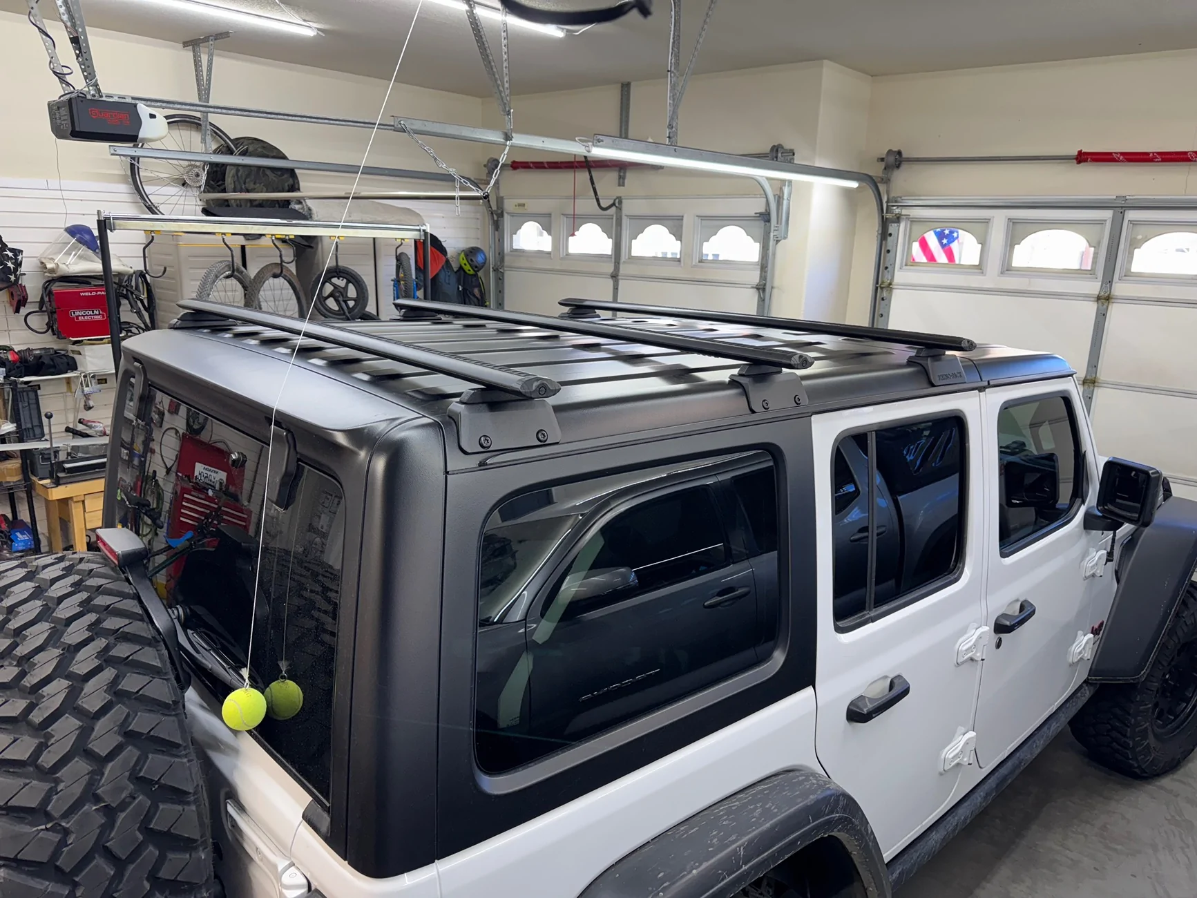

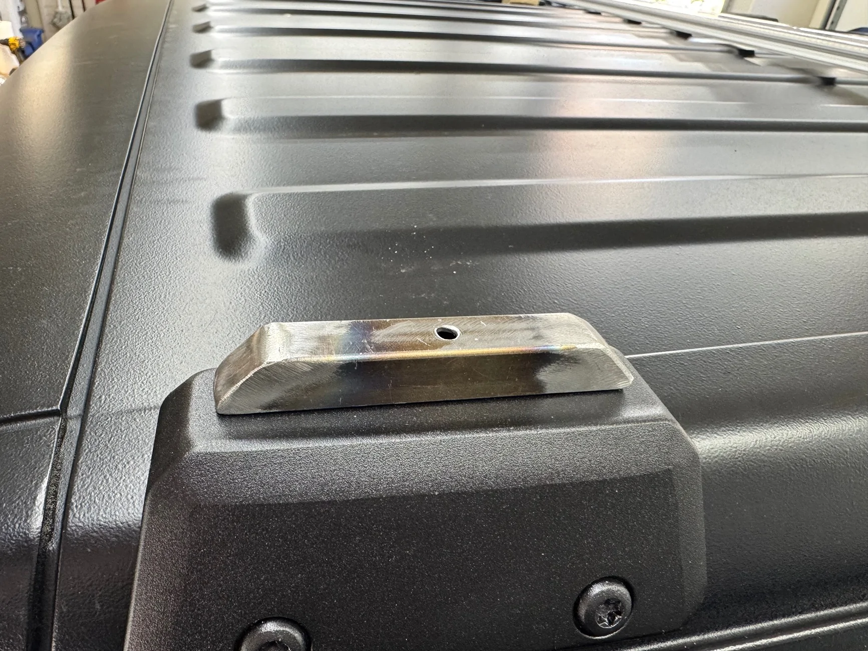

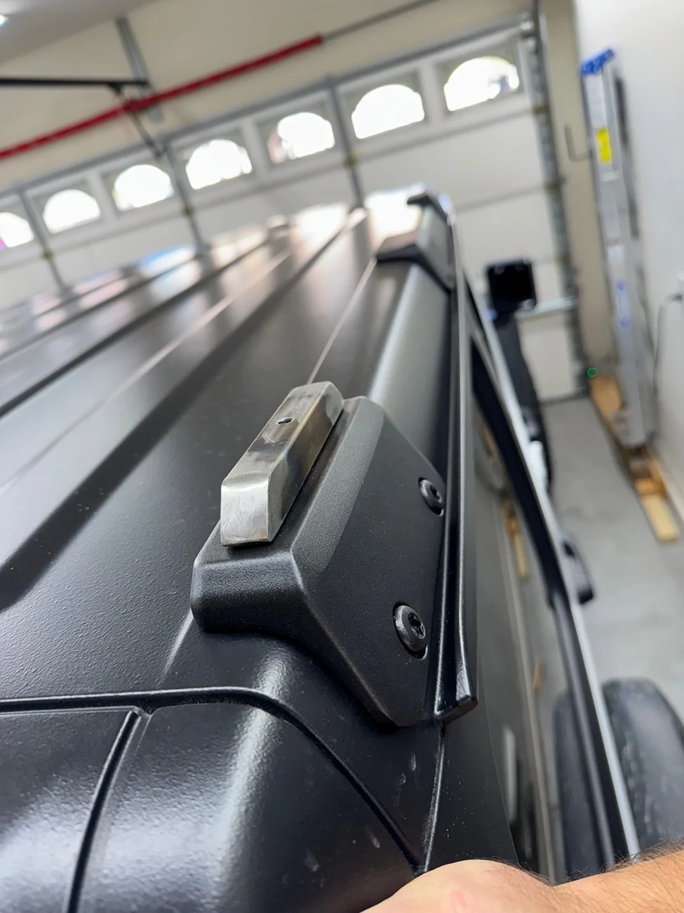

I ended up finding a deal on open box Rhino rack vortex 59” bars. I picked them up and fabricated some low profile mounting feet. I used 3/4” square stock, cut at a 45 and capped. I drilled them and the crossbars for the mounting bolts. I finished the feet in spray on rubberized bed liner. It has a grippy texture and is soft enough that it should seal the base from trapping moisture on top of the base hardware. It’s definitely lower that the lowest feet rhino rack makes and is quiet on the highway. If anyone wants to copy this just let me know if you need any info.

I just got the tent a couple weeks ago. I did have to cut the mount bolts by about 1/2”, but I like how it turned out. I just need to figure out an easier way to bolt it up and unbolt it with how tight the space is. I will probably use standard nuts and then nylon lock nuts so the clamps are easier to tighten without moving around.
