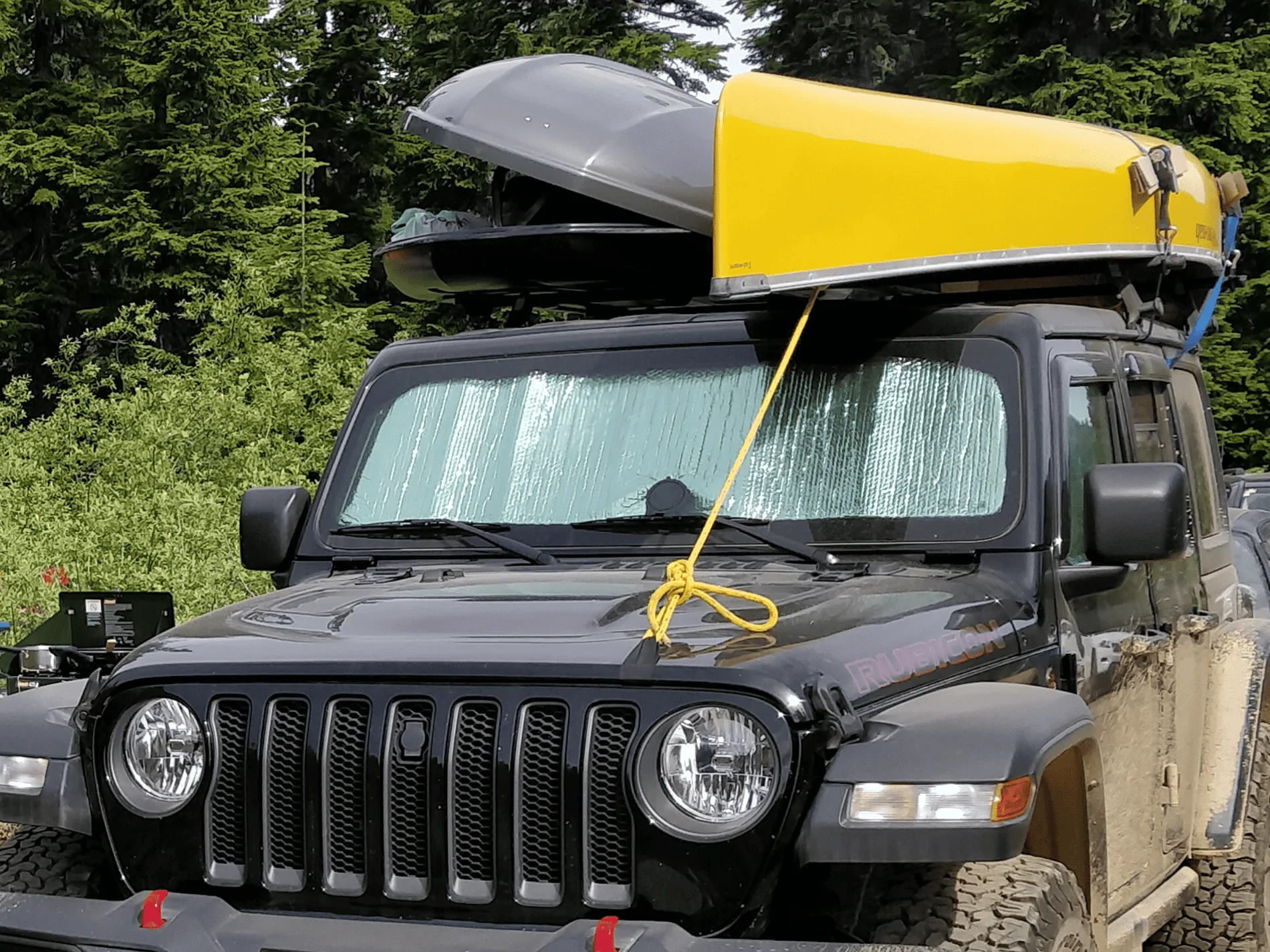

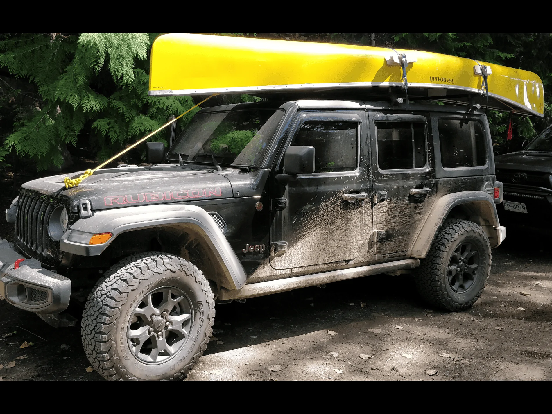

I'm currently using a Rhino Vortex SG. It's a great rack which is very sleek and priced competitively.
The mounts clamp down onto the rain gutters and although they don't have any provisions for a lock, they at least use a security torx bit. I've used it to carry a canoe throughout last summer.
My only regret is it's limited carrying space since the cross bars do not extend beyond the towers. The bars are wide enough for most applications but I realized that I can't mount two kayaks side by side.

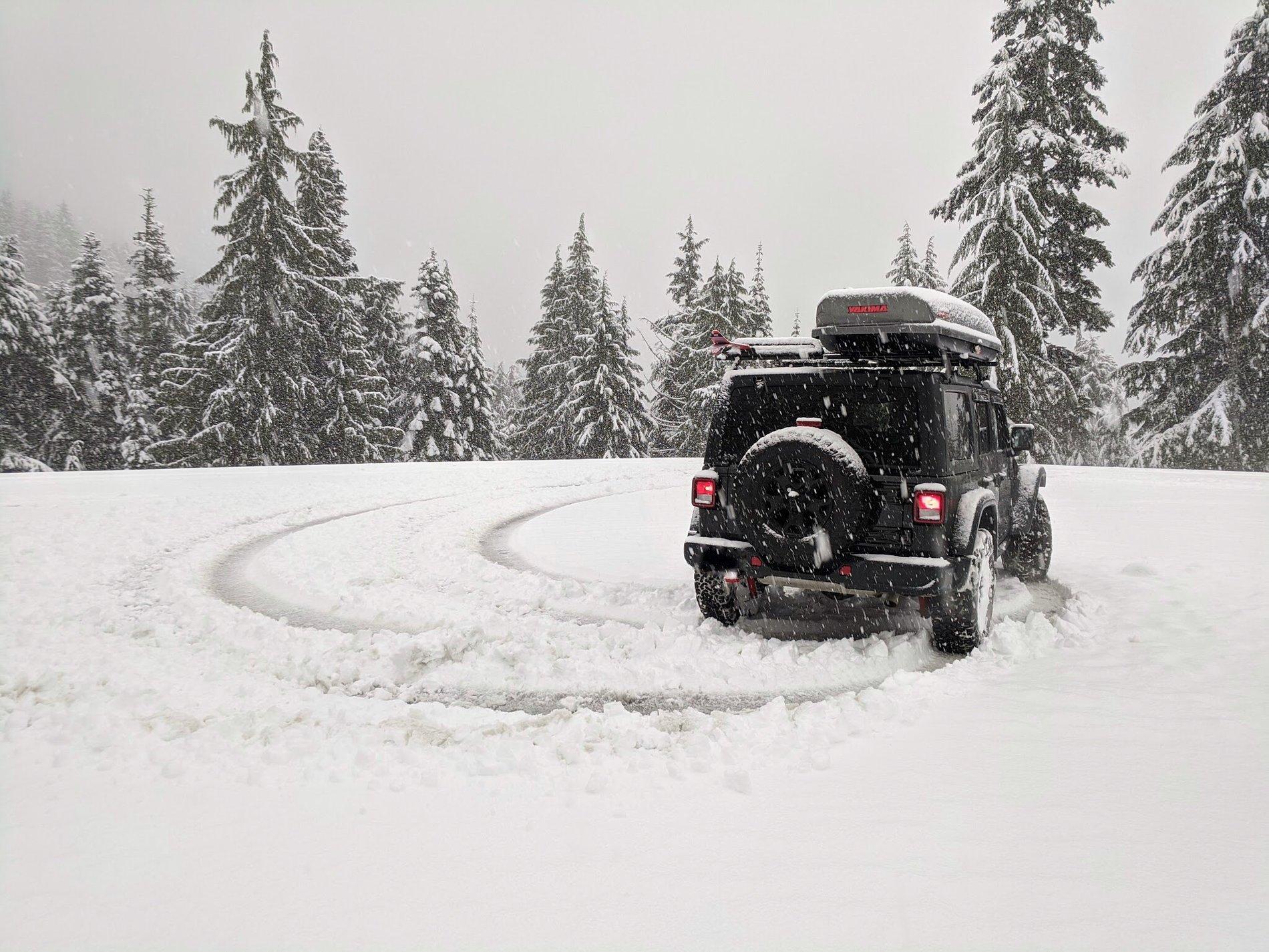

This is with both box and canoe loaded on the Yakima bars for camping. Inside converted to sleeping quarters with air mattress and bug screen window vents. Makes a very nice overnight setup without a tent.

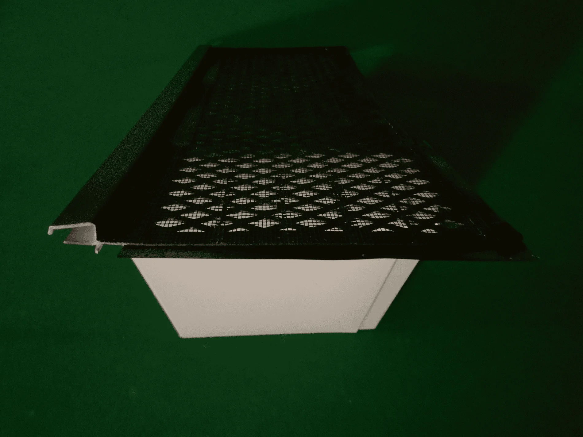

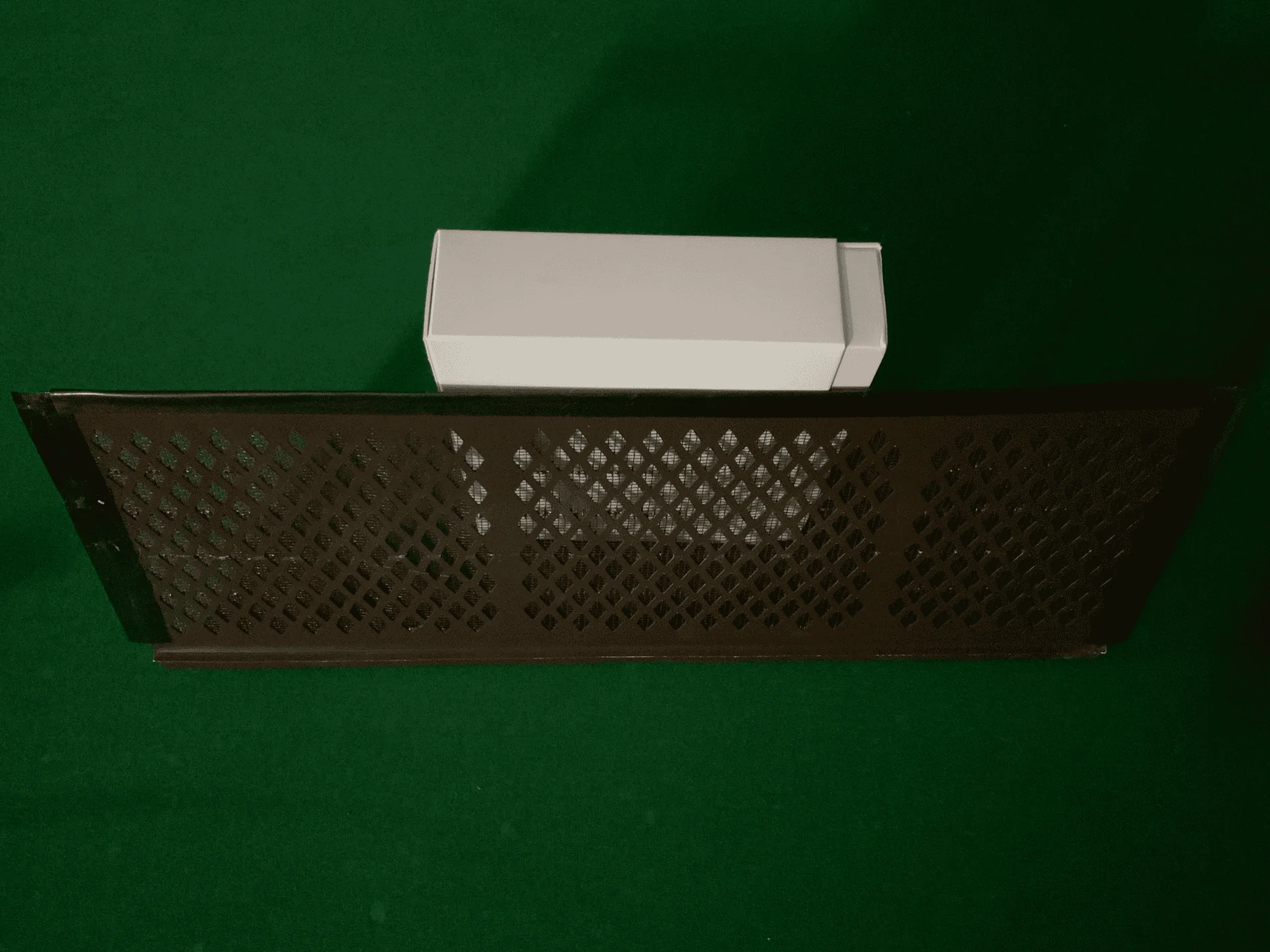

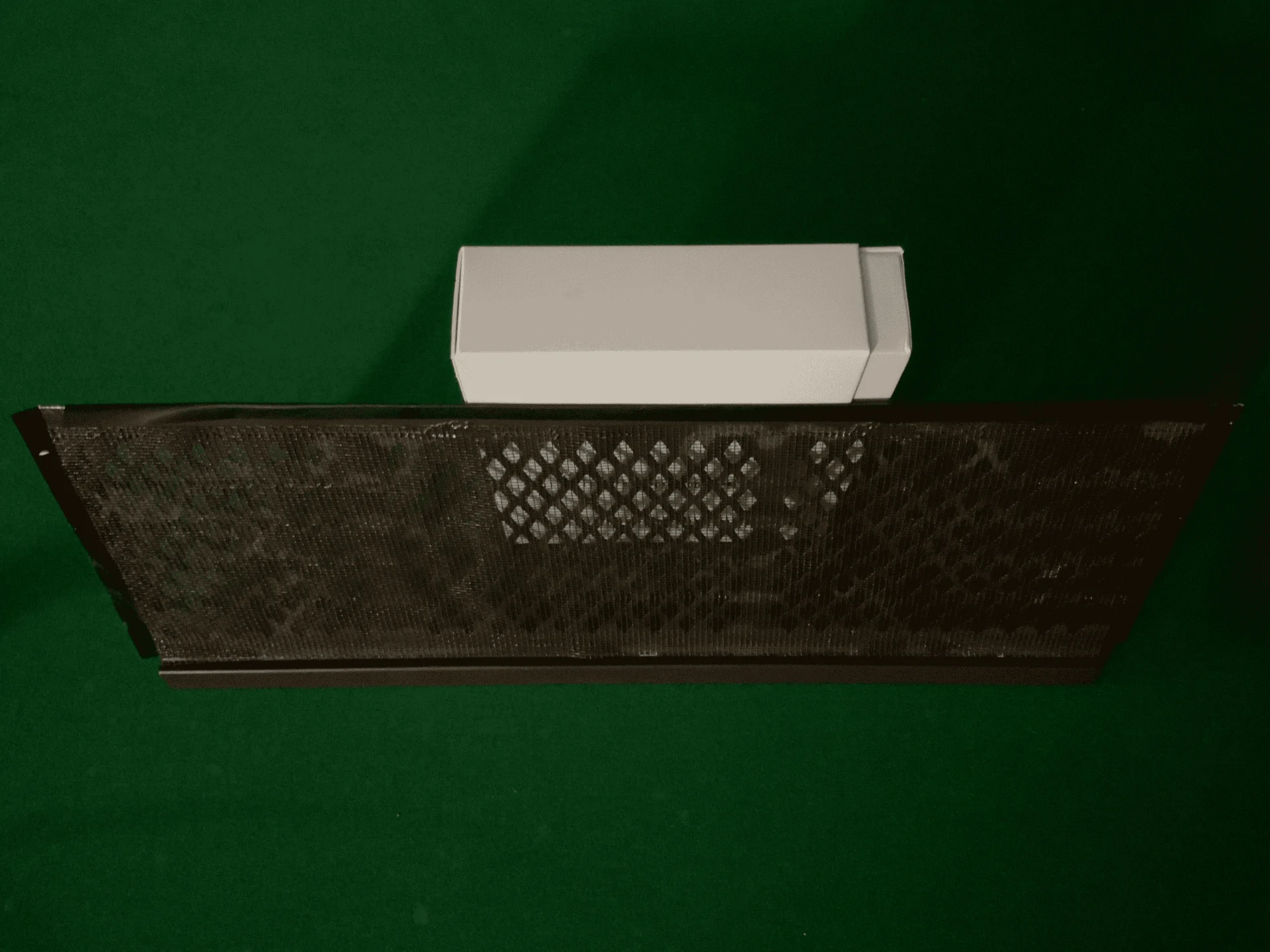

Sorry about this slight thread detour, but what bug screen window vents do you use?
Thanks!
BRuby
Nov 28, 2019
252
254
Backcountry Mtns
JLUR Benz Porsche Subie +
My son and his GF fashioned these from soffit vent material they purchased at Home Depot. They also sewed drape material to reflective backing. Actually quite ingenious and well put together. The cross-flow ventilation worked fine and the many bugs stayed outside.

Thanks for posting Ken. May I ask which canoe clamps/supports you used on the crossbars? Pros/Cons as compared to the Rhino RLH2 holders?
Thanks
ian
Ian,
I am using the Yakima KeelOver.
It pretty much does the same thing as the RLH2 while costing over twice as much. However, it's very easy to mount, remove and slide around since it uses a clamping system which works with any aero bar.
I carry a different mix of canoes and kayaks so I was willing to pay the premium for the flexibility...
