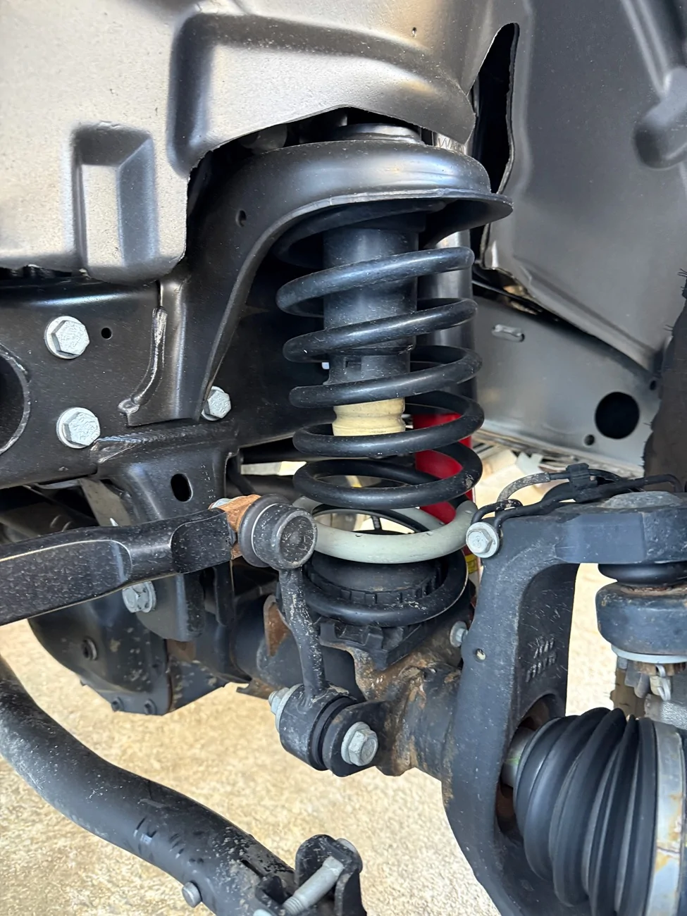

Someone earlier said I should post a picture of the front springs to get some opinions, here we are:
Jeep Wrangler JL Stupid question: Rubicon vs. non-Rubicon height? IMG_1198

Could simply be that your Sahara has some suspension sag due to age.. or added mods. Doesn’t take much to drop 1/2”.

See, now I've got two different answers in this thread. It's not tires, because I kept my tires and wheels from the 4xe when I traded it, so it is literally the same wheels and tires. Not just the same size/brand, the same literal tires
And when I say it feels taller, I am talking about getting in and out of it, and sitting in the Jeep looking out the windshield. I get that the fenders make it look taller because they are higher, but that is not entirely what I'm talking about
I really wish I had taken some measurements on my 4xe Sahara before trading it in. The Rubicon has the upgraded Mopar "step" rock sliders, which having to kind of climb over to get into the Jeep may account for some of the perception as you get in and out of it, but my wife swears it's higher
Again the Rubicon is ~1.5" taller from a Sport/Sahara. Its why on Aftermarket lifts that are 99.9% based off a Rubicon you get an extra ~1-2" of lift on anything but a Rubicon.
Factory part numbers on springs arent reliable because there is no "Rubicon" spring they are all dependent on options, engine, trans, body style. There was a thread a while back that some dude lost his mind because his "xr" has regular "rubicon" springs and refused to listen to everyone.
