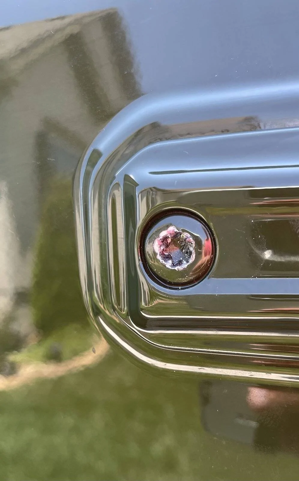

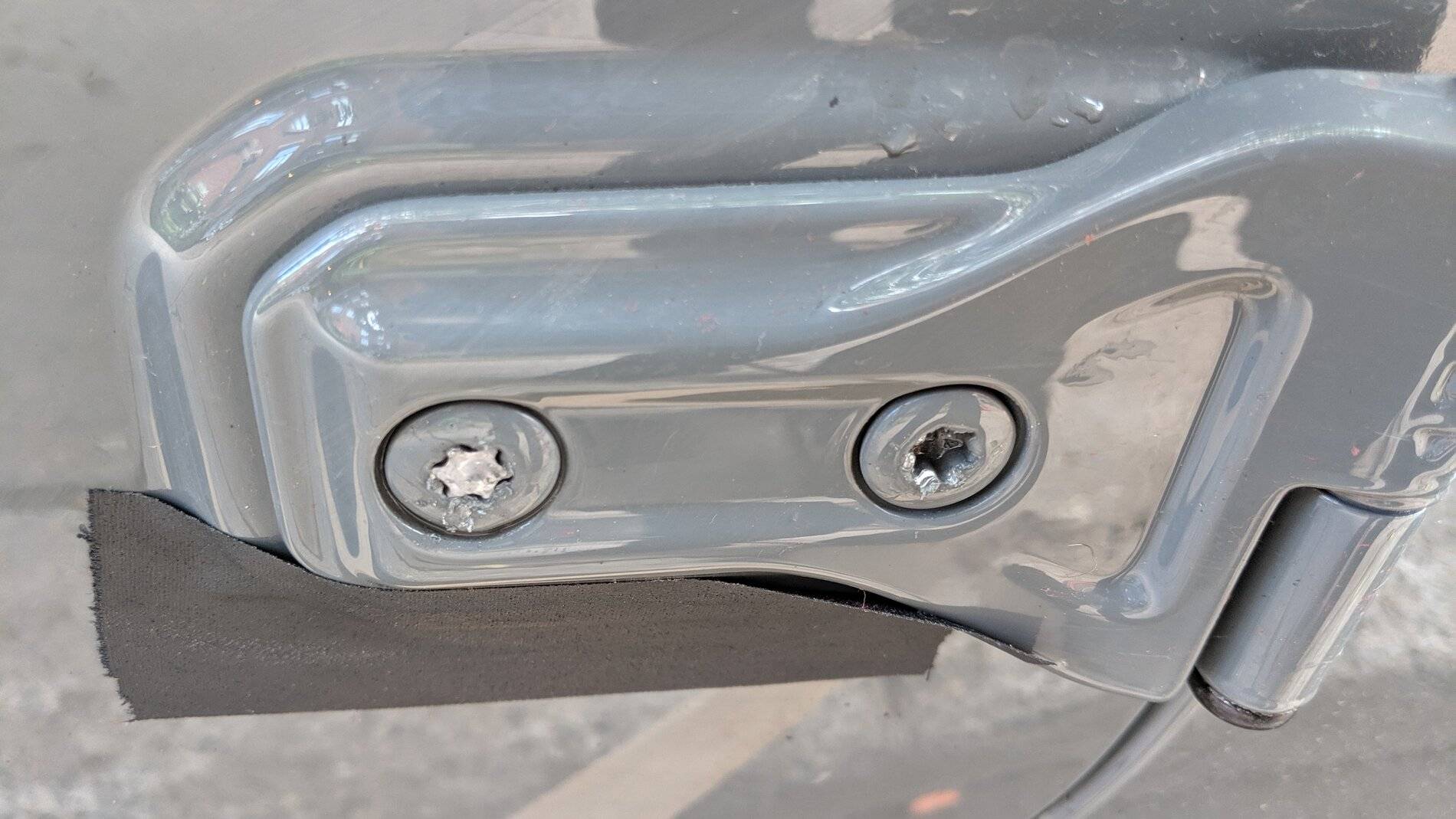

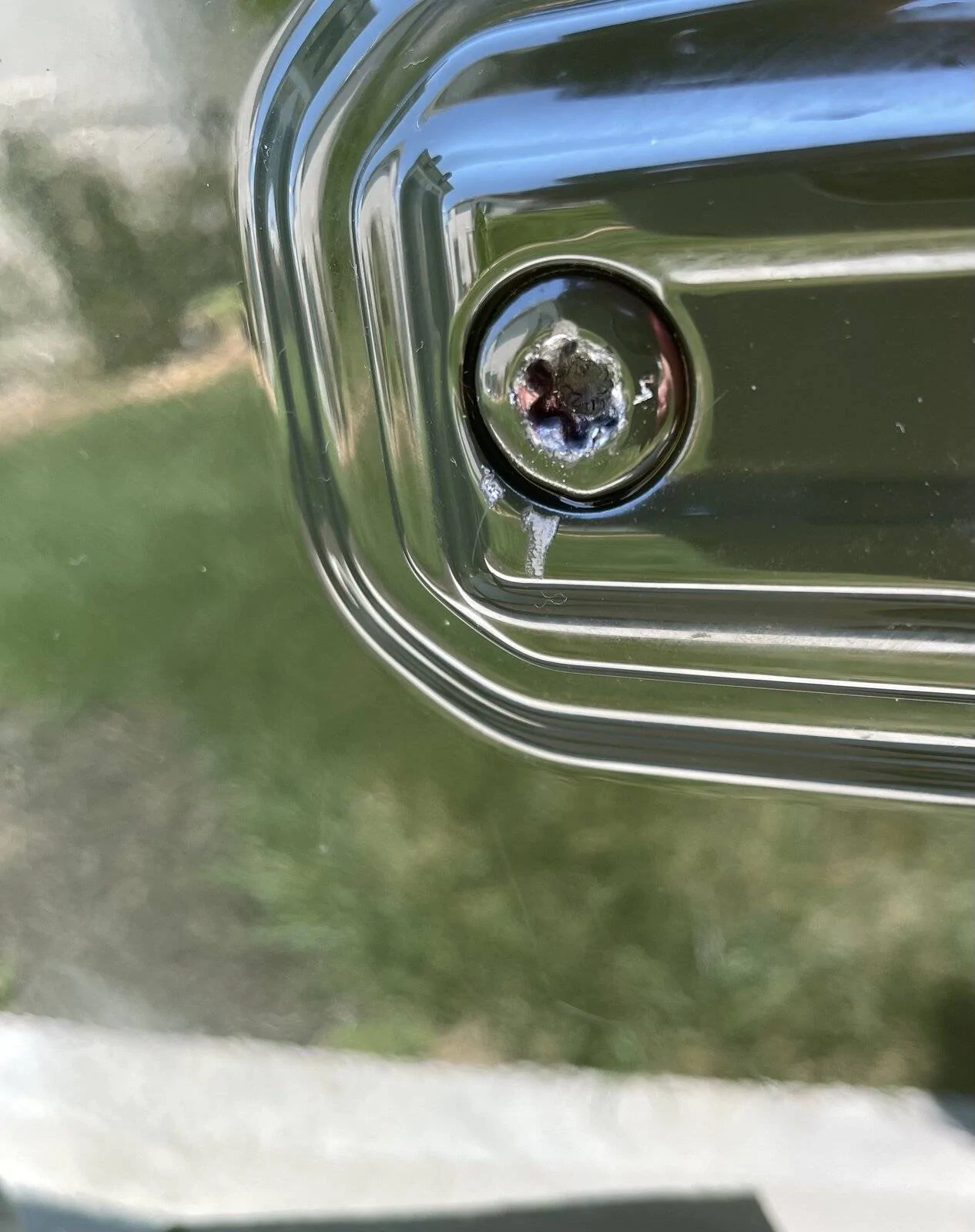

With a combination of my impact driver and a socket wrench, I’ve been Attempting to remove the door hinge t50 bolts. However, I’ve not only gouged the everloving hell out of my Jeep but I’ve also stripped 2 of the bolts. Any suggestions on how to get these out? I’ve not had to use any kind of extractor before and I’m unsure of the route I need to go. The bolts don’t need to be saved, I just need them out of there.
I've had varied success with stubborn fasteners using an air chisel(carefully). If you have enough metal left, hit the bolt at an angle to turn it, or go at it straight and it MAY loosen. This has worked well on rusted bolts/nuts for me. good luck !

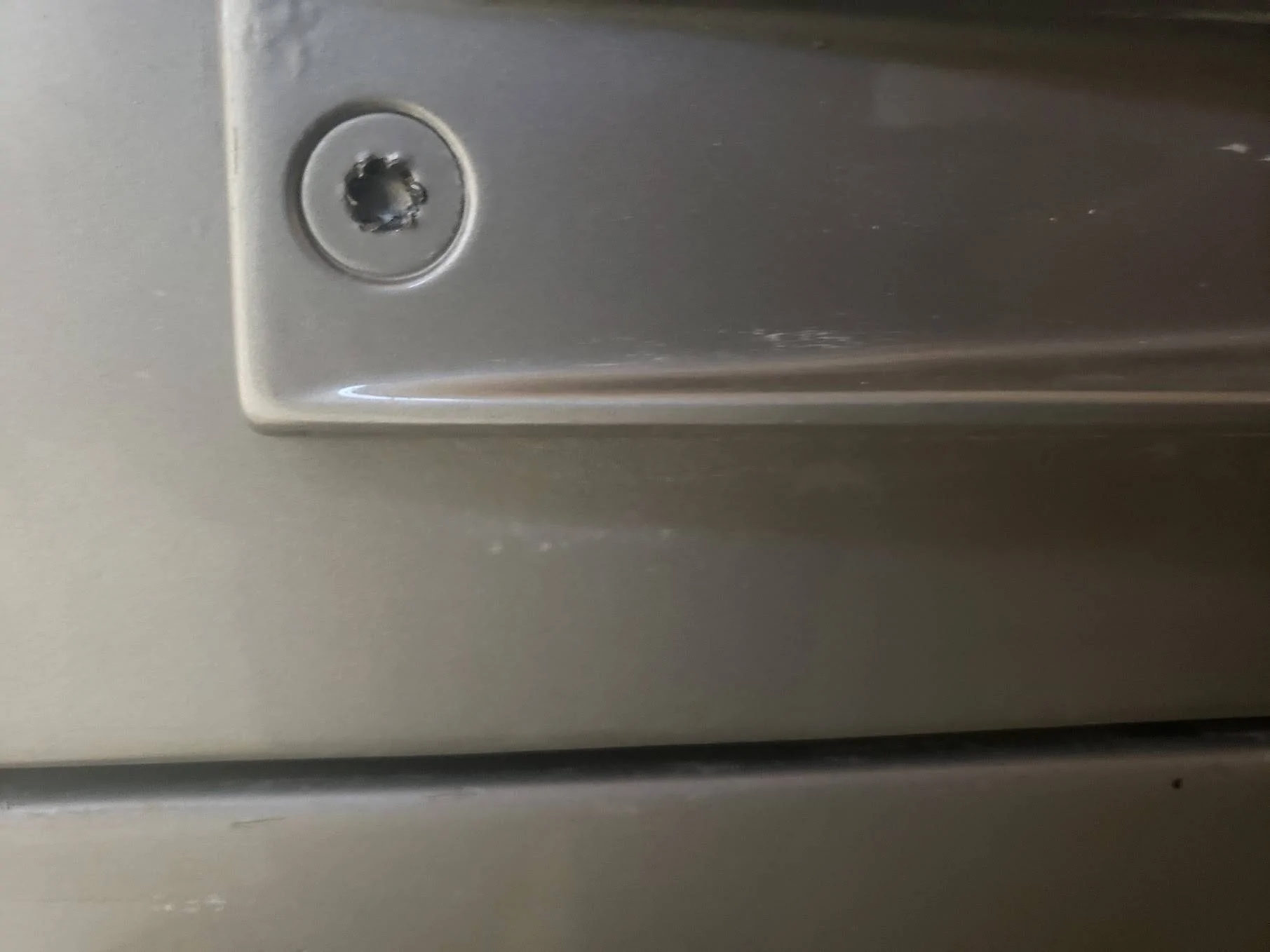

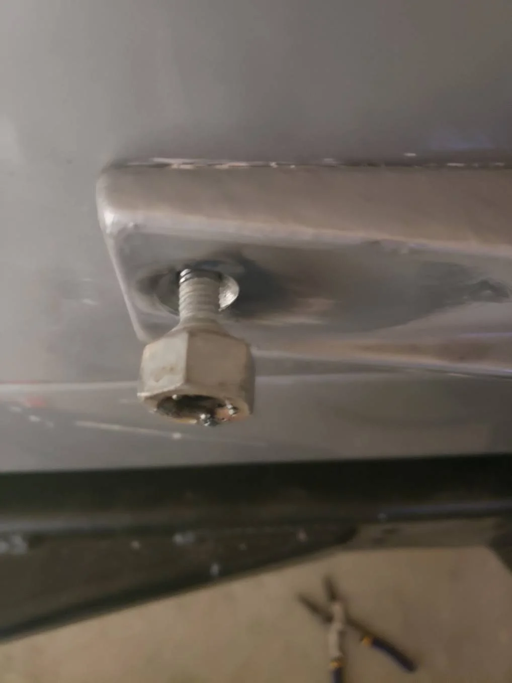

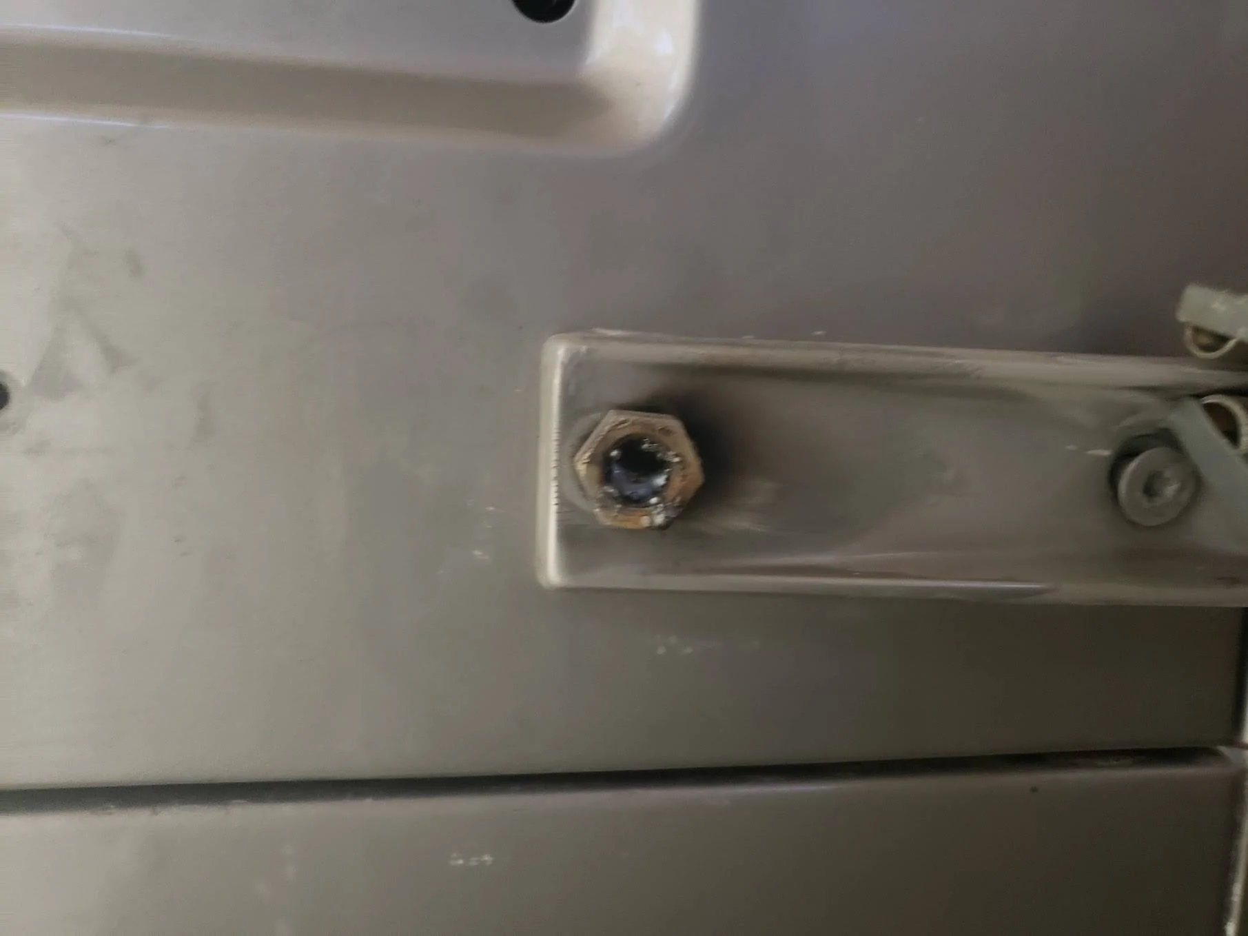

Do you have a friend with a welder? I did the same thing on my TJ on the rear tailgate hinge.
