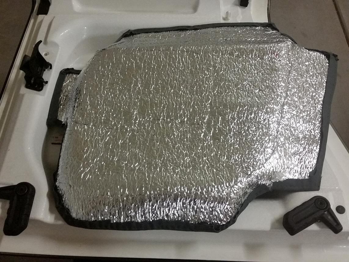

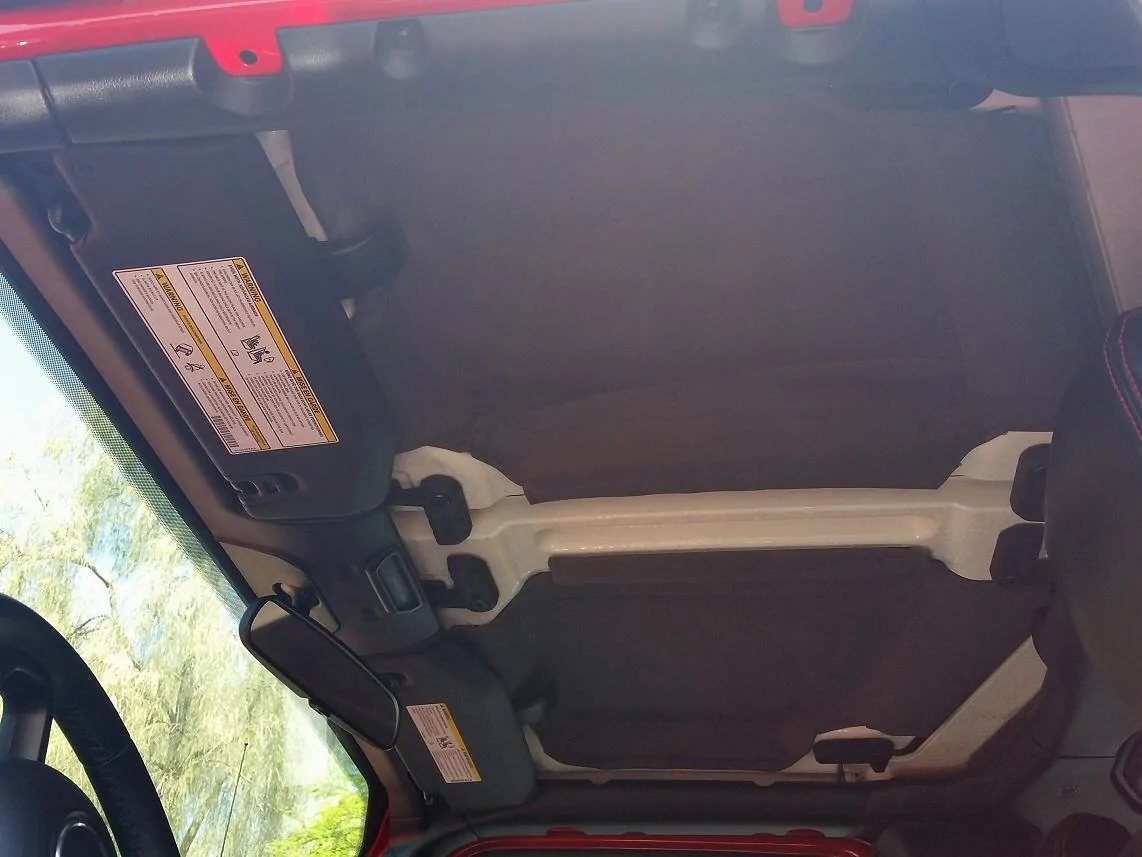

As first shared in an interior mods topic, here is a DIY with materials and construction photos for
recently completed driver and passenger lightweight and temperature efficient headliners.
Jeep Wrangler JL Stitched lightweight high temperature efficient headliner DIY HL_liner1
Jeep Wrangler JL Stitched lightweight high temperature efficient headliner DIY HL_liner8
Jeep Wrangler JL Stitched lightweight high temperature efficient headliner DIY HL_liner7

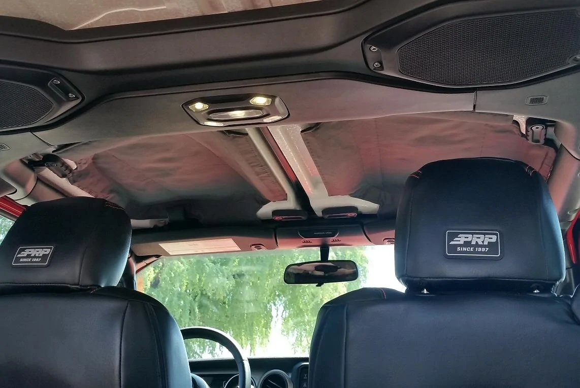

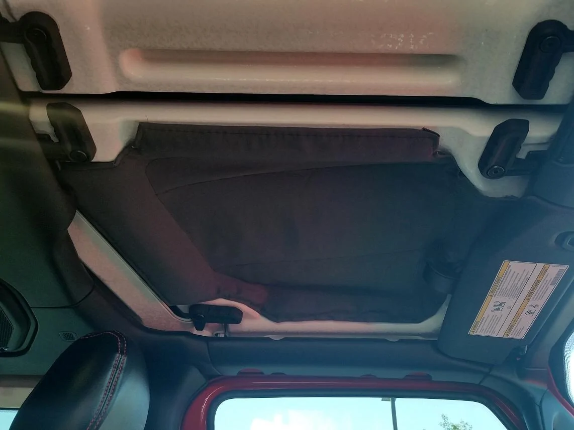

These are constructed of duck canvas stitched over two layers of reflective foam auto insulation.

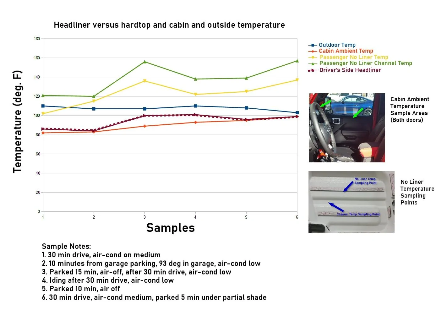

Temperature tests indicate the liner is close to ambient cabin temperatures. The primary goal
for this headliner was for higher temperature geographical area (Arizona, up to 110 degrees current,
120 this summer) Six samples were collected using a Performance Tool W89722 Infrared Thermometer.
The dotted line is the headliner tested on the driver's side, while the passenger side was bare.
Note how the headliner temp follows the lowest red cabin temperature line. The two points in the middle
that were higher are from idling and parked samples with less or no air conditioning. Given convection
of heat, the cabin ambient sampled at the door panels and steering wheel are an ideal temperature goal
for a headliner to thwart heat from the roof vs overall cabin ambient temperature. It's not expected to be
less then cabin ambient unless a headliner was actively cooled or air conditioning vents were specifically directed
upwards.

The headliner differs from some of the commercial versions in being very lightweight as it's only
foam and cloth, and extends to the edges of the hardtops instead of a pad in the center only.
The reasoning for a liner that extends to the sides of the hardtop is those other flat surfaces also radiate heat and as a primary goal of heat reduction, this was to have one liner cover as much surface area outside of the rotating latches as practical from a 4x4 foot source foam sheet.

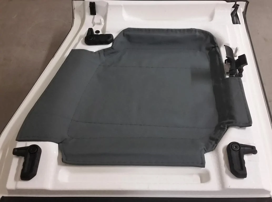

One nice "feature" discovered on the first day was how the overhead contrast of white hardtop is
reduced as the dark canvas extends to the visors.

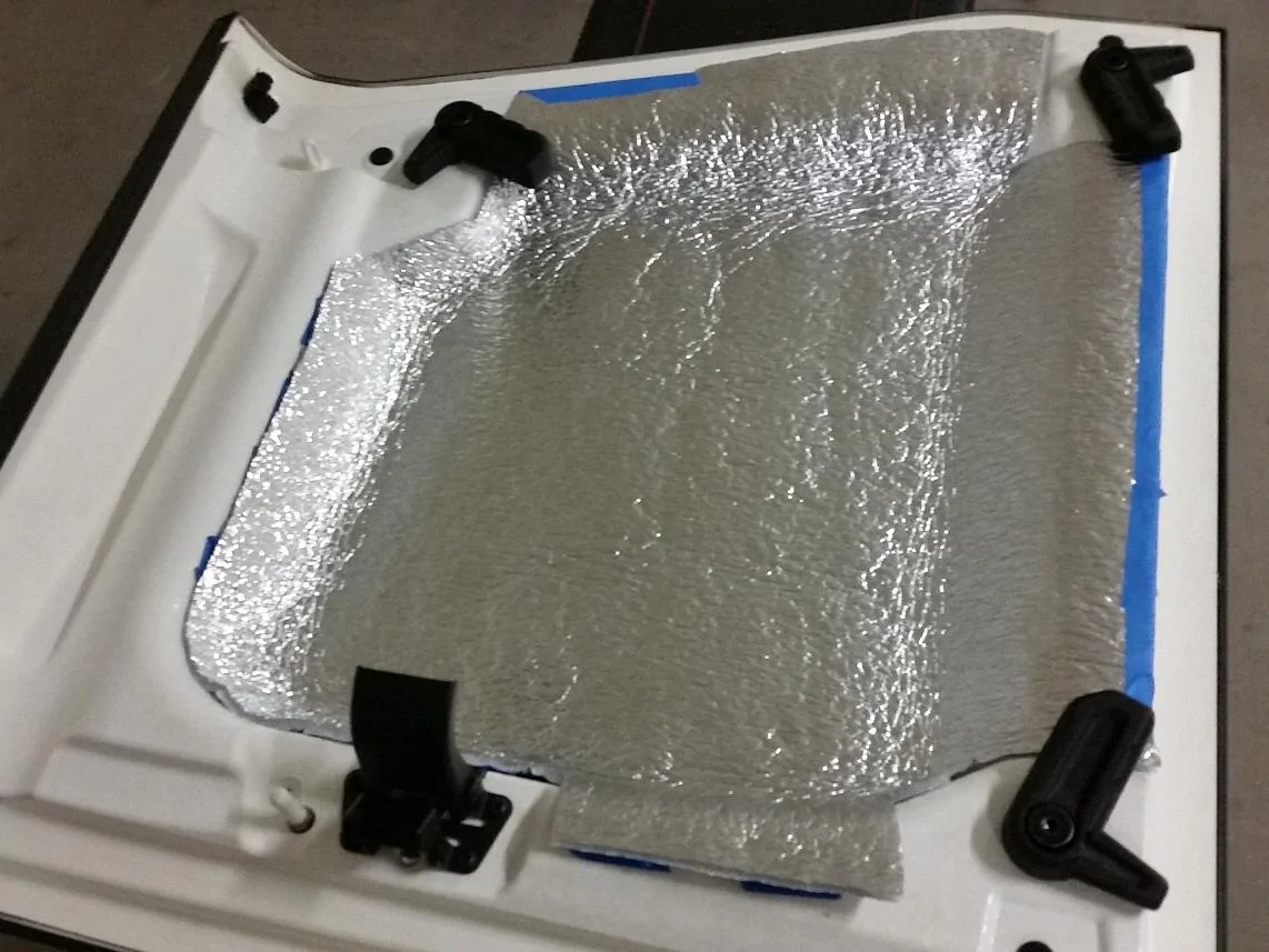

1. Form foil into hardtop, painter tape the foil and test installed on Jeep.
Jeep Wrangler JL Stitched lightweight high temperature efficient headliner DIY HL_foil1

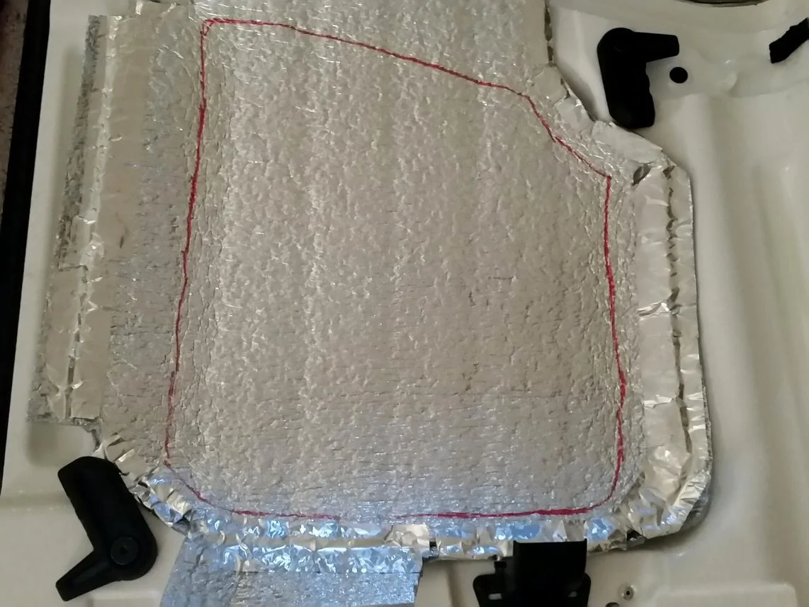

2. Add second foil layer and press into hardtop gently to shape, tape edges with HVAC tape.
To use the 4 foot square sheet, plan this out for best fit. I had the second sheet short in a few
edges by inch or so to use the material up, and be aware of keeping it thinner on the short
side by the release handle that goes to the visor, so it's not binding/touching. The release handle
and the visor do not touch the liner. Also check that the three rotating locks can swivel
without catching the foil.
Jeep Wrangler JL Stitched lightweight high temperature efficient headliner DIY HL_foil2
3. Draw line around inside curve as a stitching guide.
Jeep Wrangler JL Stitched lightweight high temperature efficient headliner DIY HL_foil3

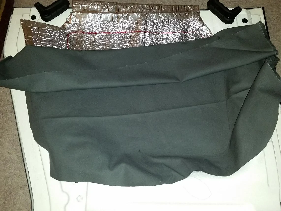

4. Cut cloth, with at least an inch beyond edges. Tip - to use the fold marks, oriented to around
the small edge near the hardtop release handle to form two lines down the middle that when stitched will
keep the cloth in place from sagging in the middle and use those fold marks as visual guides.
Jeep Wrangler JL Stitched lightweight high temperature efficient headliner DIY HL_canvas

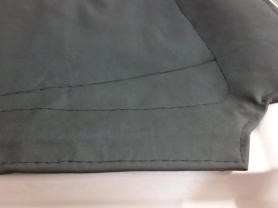

5. Stitch the bottom circle around the hardtop inner curve and the lines, using sharpie mark as a visual guide.
Stitch is 1/2 to 5/8 advance and then back up 1/8 inch and continue so it forms loops and large stitches to keep
foil intact.
Jeep Wrangler JL Stitched lightweight high temperature efficient headliner DIY HL_stitch
6. Stitch around upper edges after the bottom stitches are done - in order to see the sharpie guide line.

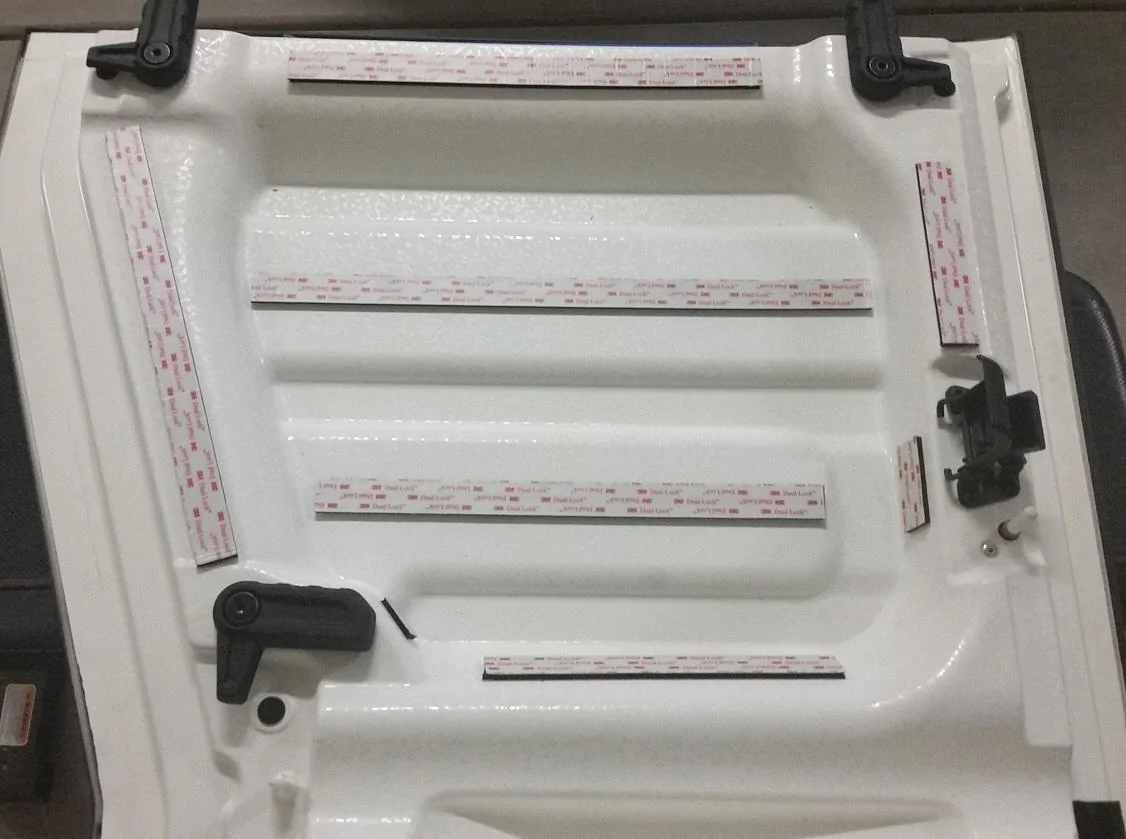

Turn over and trim cloth to 1/2 inch, tie loose threads. The idea is to have the 3M tape stick to the foil and not cloth. Test the completed liner and bend to refit into curves as needed so it's ready to line up and tape into place.
Jeep Wrangler JL Stitched lightweight high temperature efficient headliner DIY HL_backside
7. Sand and alcohol clean hardtop where tape will be installed. Also alcohol clean the foam foil in matching areas.
8. Attach two bottom strips of tape and line up headliner along an edge and press into position onto tape.
Jeep Wrangler JL Stitched lightweight high temperature efficient headliner DIY HL_ta
9. Add other strips under edges or curves as needed. This is where an extra tape roll was needed, can conserve to
keep to one roll overall. At least have tape under each edge and helpful in a couple curves. I first installed the two bottom strips, then installed tape under each edge and pressed to liner, one edge at at time until complete.

Jeep Wrangler JL Stitched lightweight high temperature efficient headliner DIY HL_liner4

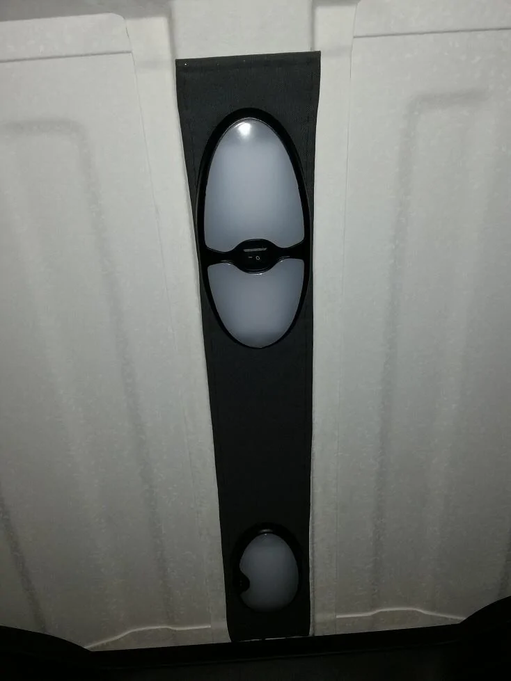

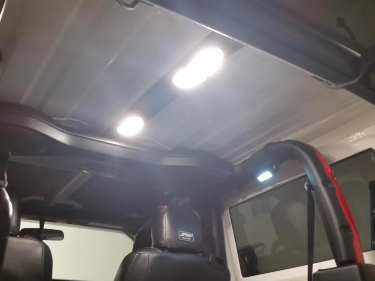

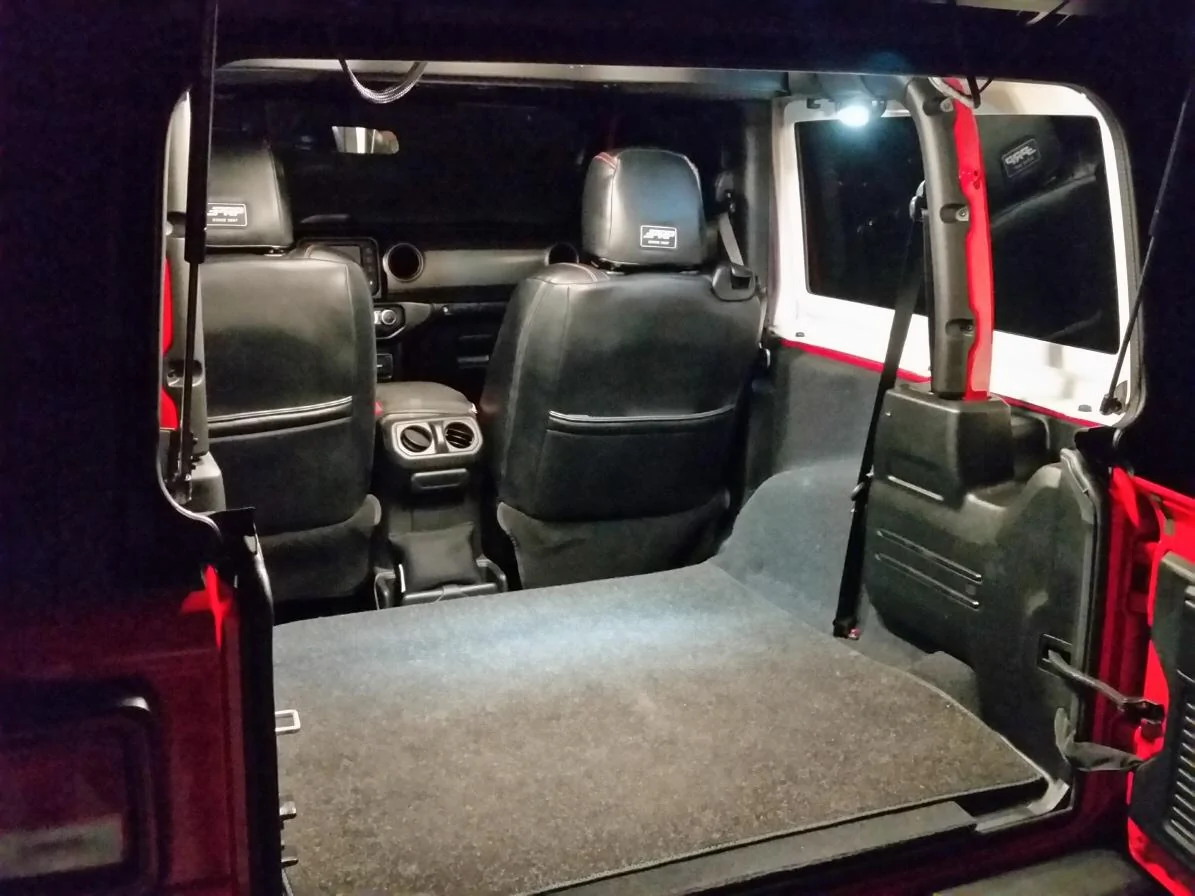

Here is the center stitched liner and is combined with another cargo lighting project to be a new topic, announced here with pics of electrics: TO Jeep thread
EDIT: Here is the new DIY lighting thread with some repeat pics: DIY camping hardtop interior lighting
Jeep Wrangler JL Stitched lightweight high temperature efficient headliner DIY Lights_and_center_liner
Jeep Wrangler JL Stitched lightweight high temperature efficient headliner DIY Center_installed

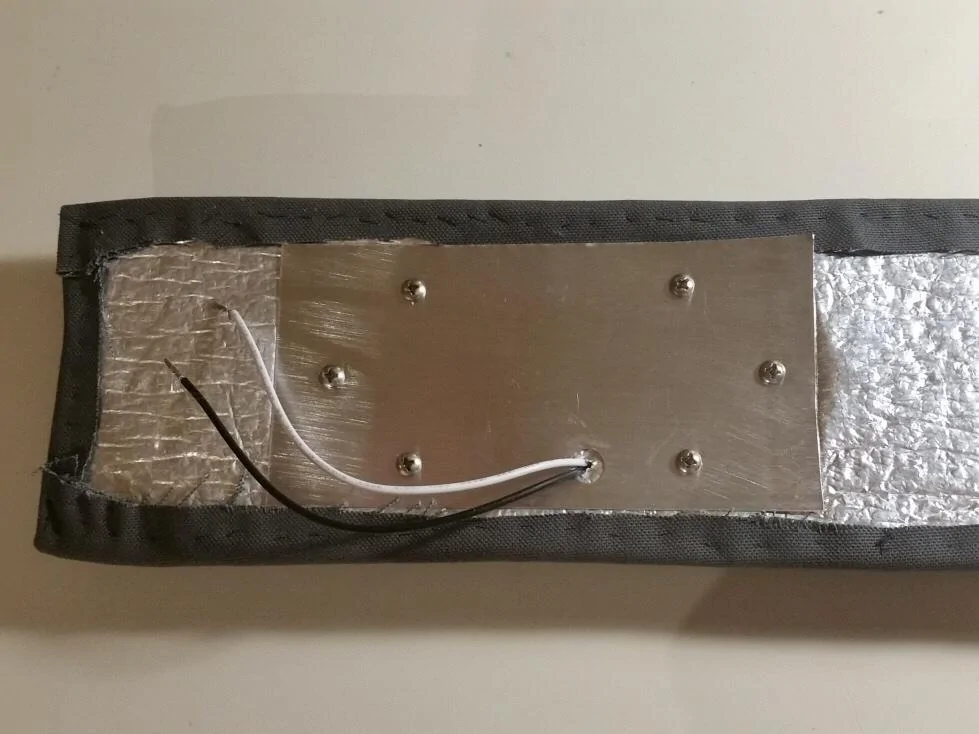

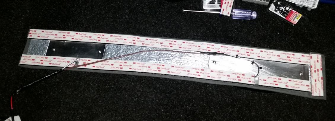

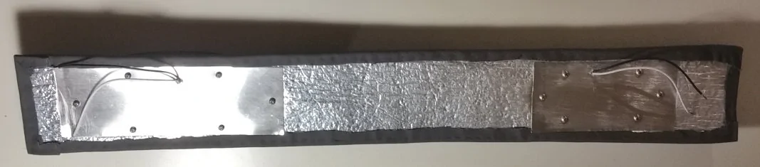

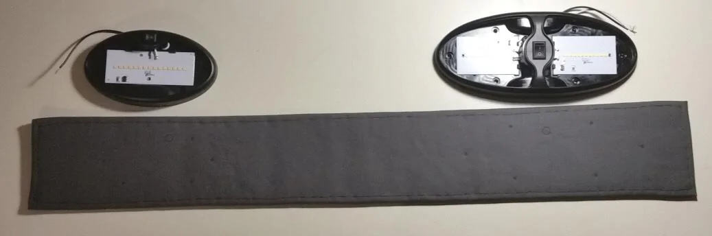

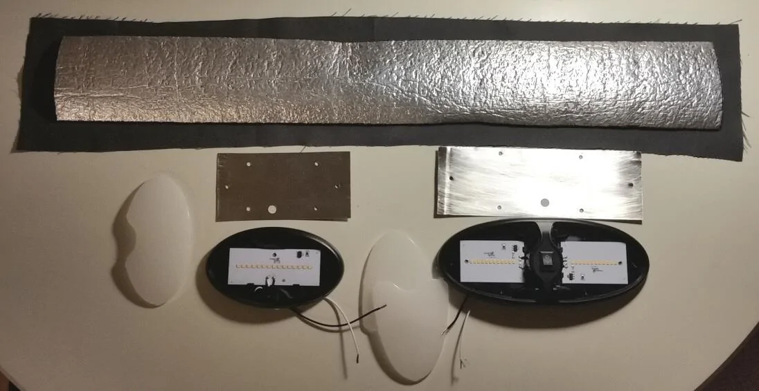

The same materials were used as with the front liners: stitched duck canvas but this time for the rear is over a single sheet of reflective foam foil, same sources. I bought one new yard of canvas and one new roll of reflective foam to do the hardtop topside.
The center liner piece foam measurement is 29 inches by 4 inches and attached with same 3M tape.
I have the other side panels to left and right of center liner cut but not yet stitched, to add measurements to be able to cut all three from one $18 sheet of foil:
Jeep Wrangler JL Stitched lightweight high temperature efficient headliner DIY Center_materials
Jeep Wrangler JL Stitched lightweight high temperature efficient headliner DIY Center_stitched
Jeep Wrangler JL Stitched lightweight high temperature efficient headliner DIY Center_backsid
Jeep Wrangler JL Stitched lightweight high temperature efficient headliner DIY Center_backside_clos
Jeep Wrangler JL Stitched lightweight high temperature efficient headliner DIY Center_backside_tape
The lights will best be in another topic. If not adding lights or using other lights, traced the 6-32 screw holes and wire hole with lights open, and punched holes with closed small sissors, carefully, into the liner after stitched.
For this liner, it was simple to cut, stitch, and add the 3M tape as shown after slight sandpaper on hardtop and alcohol clean of hardtop and metal of liner.
Installed with removing the tape from the hatch end and placing that first and pulling tape and walking it back. Better to have someone on other side to guide to be straight back and press onto hardtop. It weighs so little the strong 3M tape will hold well, even with the lightweight lights.
Parts list for the lights, and that's 0.016 thin aluminum from hardware store on backside, to be soon in another DIY post.
