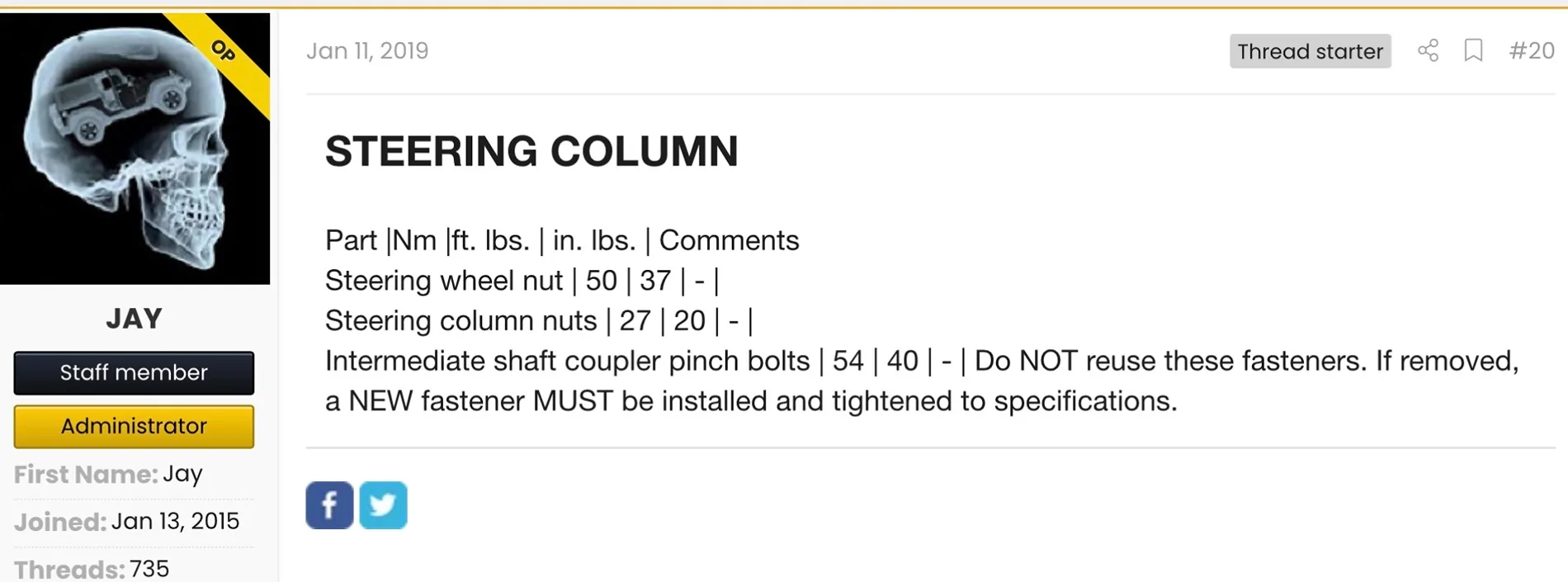

What is the torque spec for the steering wheel nut on a 2021 Jeep JL?
TopGunViper Well-Known Member First Name Matt Joined Jun 23, 2024 Threads 19 Messages 210 Reaction score 290 Location MO Vehicle(s) 2021 Jeep Wrangler Rubicon Unlimited Sep 29, 2025 Thread starter #1 What is the torque spec for the steering wheel nut on a 2021 Jeep JL? Sponsored
Terrymo Well-Known Member First Name Terry Joined Jun 17, 2022 Threads 52 Messages 12,036 Reaction score 38,017 Location SoCal Vehicle(s) 2023 JLURXR 3.6 ET Clubs Sep 29, 2025 #2 TopGunViper said: What is the torque spec for the steering wheel nut on a 2021 Jeep JL? Click to expand... Looks like 37 ft lbs https://www.jlwranglerforums.com/forum/threads/torque-values-for-jeep-jl-wrangler.17791/

OP OP TopGunViper Well-Known Member First Name Matt Joined Jun 23, 2024 Threads 19 Messages 210 Reaction score 290 Location MO Vehicle(s) 2021 Jeep Wrangler Rubicon Unlimited Sep 30, 2025 Thread starter #3 Thank you!!! Sponsored
