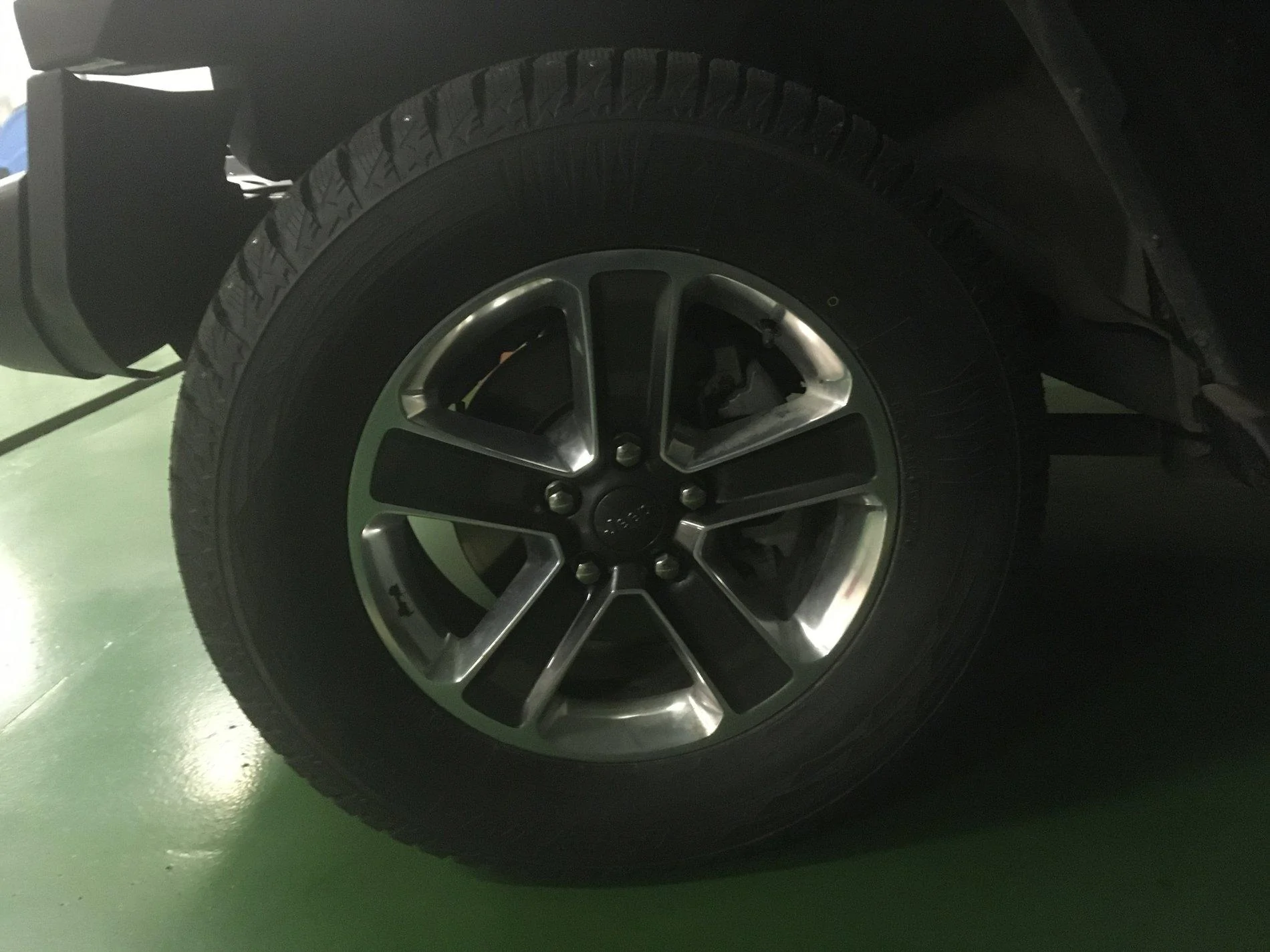

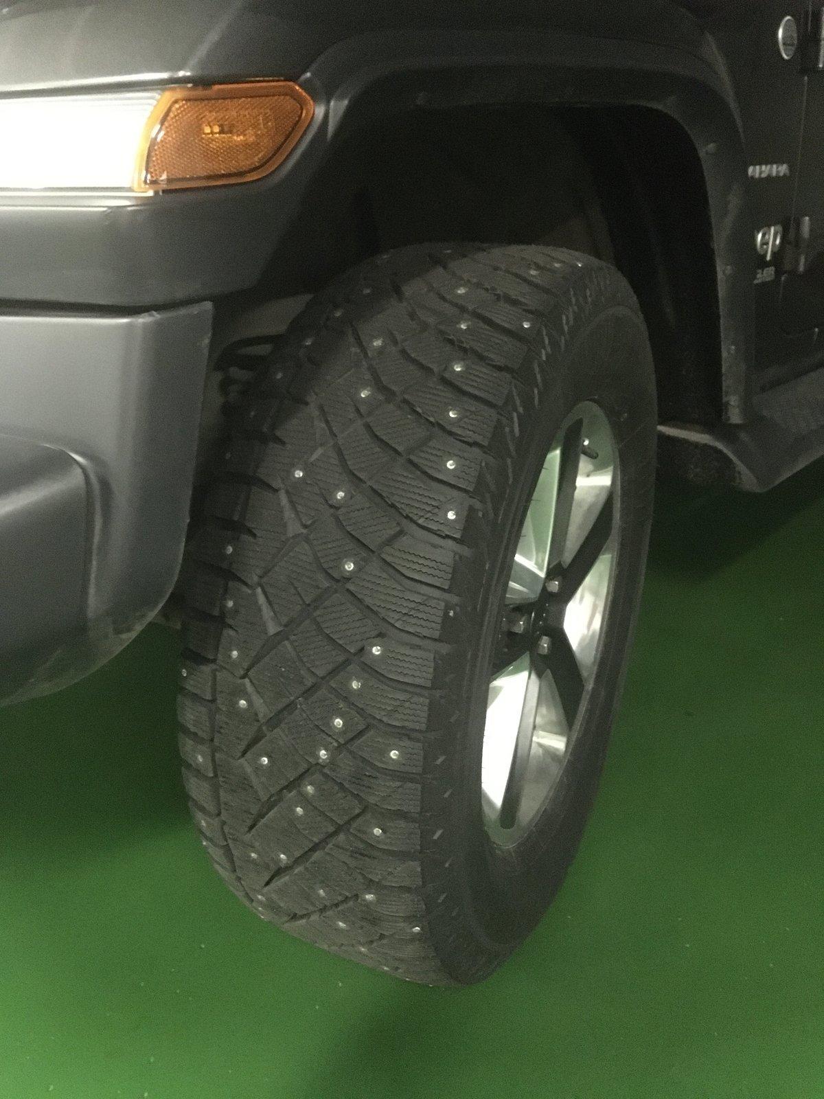

Hello.
Everyone is discussing TSB 08-074-20 Fix. This solves the problem of poor handling, but does not solve the problem of steering vibration at 55-65 mph.
Under my warranty, a dealer in Moscow replaced all the shock absorbers and anti-roll bar.
This did NOT solve the vibration PROBLEM.
Sometimes it happened that it was necessary to brake sharply to a speed below 55 miles per hour, as the vibration went on increasing and the car lost control.
I myself was able to fix this problem by replacing rubber with a size of 255 * 70 * 18 for rubber with a size of 285 * 60 * 18. This replacement is GUARANTEED to eliminate the problem of steering wheel vibration at any speed.
Believe me, this is so.
2018, JL Sahara
I attach a photo of the wheels to this thread.
