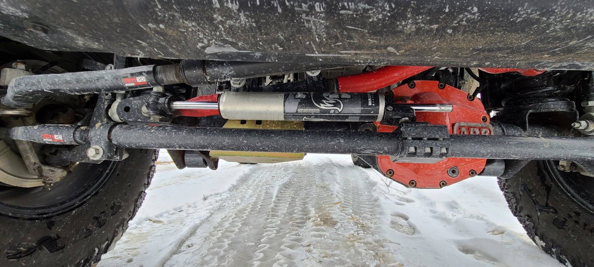

I've been very happy with the Fox TS stabilizer. I didn't spend the extra for the adjustable ATS version, because it seems that most who have the adjustable type prefer the middle setting, which is equivalent to the nonadjustable one. Plus, it doesn't have the piggyback reservoir that takes up more real estate.
Jeep Wrangler JL Steering Stabilizer Recommendations... 20210213_130917
