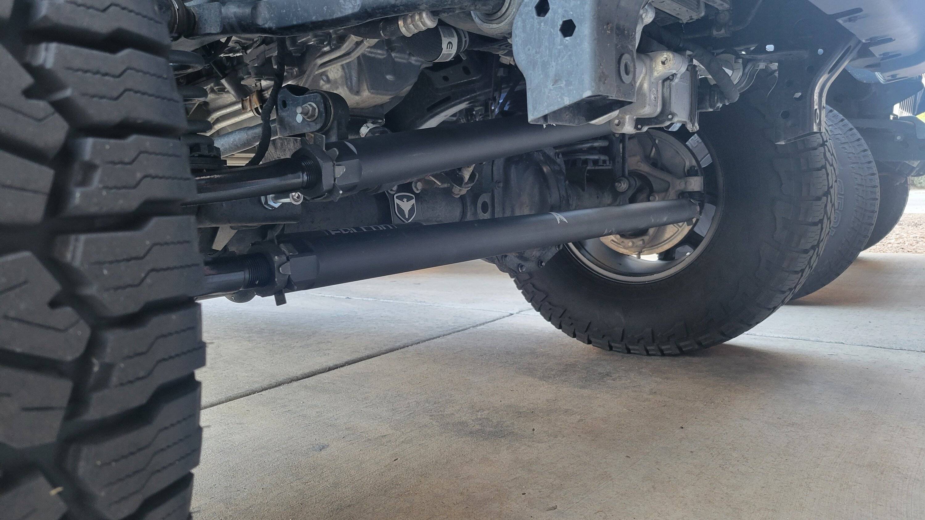

I've been plagued with JL steering issues (as many others have had) since I bought my 2019 UR off the lot 3 years ago. I own a TJ had a JK and other than some DW, never had issues with wander, right pull, shimmy, slop in the wheel, etc. Like with the JL.
Fast forward to today and I've finally solved them. I know every jeep is a little different, but wanted to share what worked in my situation. The first thing I did was to replace the track bar with the steersmarts yeti. Solved death wobble issue but not the right pull/having to keep my hand always pushing the steering wheel to the left. Next, i installed the sector shaft brace by SS and the shop gave me a take off Fox steering stabilizer which improved things even further (thanks to Venture Offroad for the freebie). However, I still felt right pull and a little slop in the wheel and a little shimmy. This past week, i bit the bullet and got the Apex 2.5ton aluminum tie rod and drag link as well as the falcon nexus through shaft stabilizer.
Picked up my jeep a couple days ago and WOW. Steering stiffened up, everything feels tight, NO right pull and in fact I can turn the wheel to the left a little and it actually goes left! What a concept!
Sad I have to go through all the upgrades to get a vehicle that steers like it should from the factory, but I'm super thrilled everything is great now.
While the Apex set up isn't cheap, it was worth every penny and it's such a solid setup. Jeep seems to under build their steering and its a shame. This is how the jeep should steer from the factory.
Biggest difference maker was the Apex setup and I believe the right pull was resolved with the through shaft design of the Falcon nexus steering stabilizer.
Anyway, Merry Christmas everyone and hope this helps somebody!

Just so I am reading your post right, did you did the Apex set-up with Falcon through shaft on top of Yeti Track bar and SS selector shaft brace and steering stabilizer?

No, I have steer smart's track bar and sector shaft brace, apex tierod and drag link, and falcon nexus 2.1 ss. I ditched the fox one cause the thru shaft didn't create a pull like I got with the fox. Sorry for the confusion.

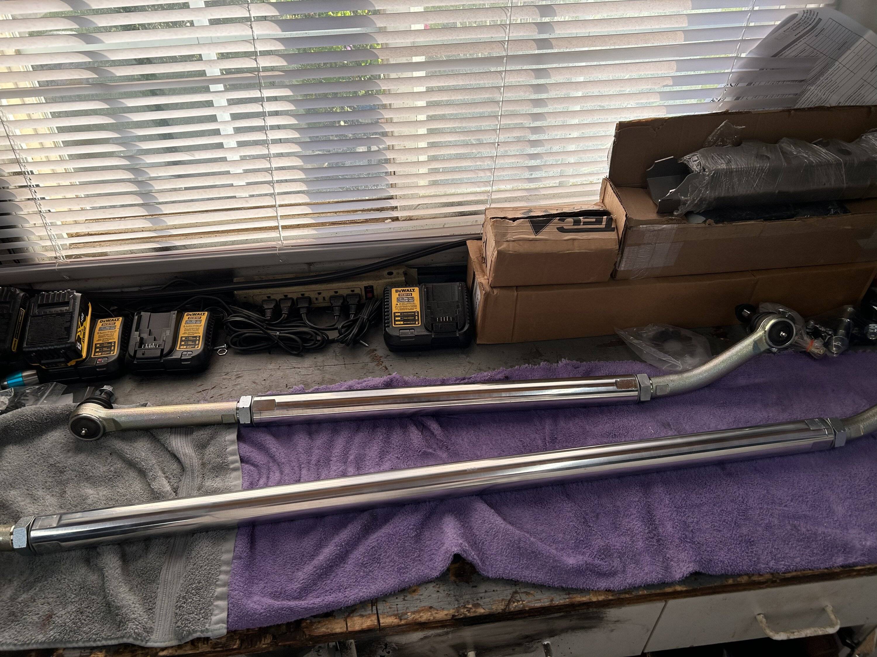

Just installed the RPM / Apex 2.5 ton stuff on my neighbor’s JT. Wasnt hard at all. He also has the SS sector shaft brace and a Falcon through shaft stabilizer. He did have it professionally aligned afterwards. He is thrilled with the steering.
This week we are installing Rusty’s on my JL. I too have the SA sector shaft brace and run a MC stabilizer. My little 2 dr drives perfect right now. Hope I dont screw it up with heavy duty steering. ?
Sucks we have to spend $2k to get decent steering, but I am glad to finally have the problems behind me and have peace of mind with some solid overbuilt components.

I was lucky. My JL was great from day one. But I thought the SS brace was a good idea so I added it "just because." Boy did it tighten things up for me and made the jeep even more responsive. The HD stuff is basically insurance so that I don't break anything off road. Truth is, I could probably wheel my whole life on stock components and never have an issue. But I stress out over potential problems.
