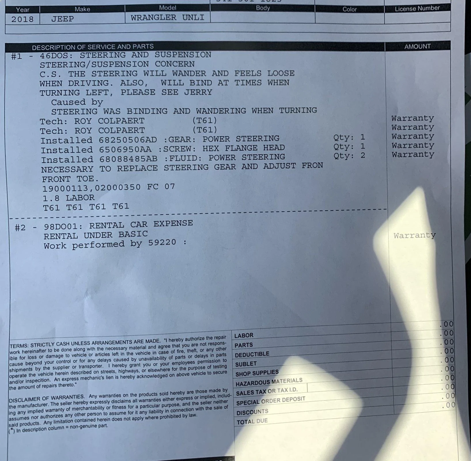

UPDATE:
Just picked up the Jeep today. The popping noise when turning the wheel all the way to the left then back center is gone.
The loose steering and play however is still very present and the same. I’m extremely disappointed and don’t know what else to do. This has been my 6th time at the dealer. Opened a case with FCA, JeepCares seems to not Care. So I’m stuck. The shop foreman told me “I guess you’re just more sensitive to the steering”. Really...?
Attached below is the picture of the service that was done.
I’m sorry that if anyone was hoping this would fix the loose steering and play, I can tell you it has not. I have the updated track bar, fox steering stabilizer and now this most recent service. Still slop, still too much play.
