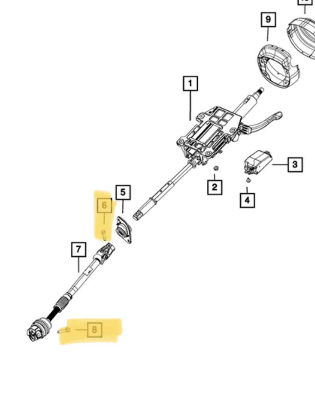

As you’ve seen some of my posts. I have notchy steering after I went to dealer. I’m a few hundred miles later with no change. I’ve done repeated trips.
I’m going back to basics. What are the torque values of all items involved
Pitman nut 250
Steering box bolts 99
Steering shaft bolt???? It’s a 13 mm bolt
There’s also another 10 mmm bolt at the top of the steering shaft. What are those torque values.
thanks!

Jeep Wrangler JL Steering gear torque values to rule out steering problems 44E305DE-132A-493B-86B7-FAECF3081117
these are the bolts I’m looking for torque values

thank you for that. I’m aware it’s there which is where I got the other values from. I just don’t know what these parts are called. If you could help narrow it down. I’d appreciate it

STEERING COLUMN
Part |Nm |ft. lbs. | in. lbs. | Comments
Steering wheel nut | 50 | 37 | - |
Steering column nuts | 27 | 20 | - |
Intermediate shaft coupler pinch bolts | 54 | 40 | - | Do NOT reuse these fasteners. If removed, a NEW fastener MUST be installed and tightened to specifications.
STEERING GEAR
Adjuster screw lock nut | 45 | 33 | - |
Power steering gear bolts | 133 | 99 | - |
Power steering gear pitman shaft nut | 250 | 184 | - |
Power steering gear pressure line | 28 | 21 | - |
Power steering gear return line | 28 | 21 | - |
Well. #8 above is the I-shaft (intermediate shaft pinch bolt). This was supposed to be replaced as part of TSB. The torque value is 40lbs. Not positive on #6. Sorry
