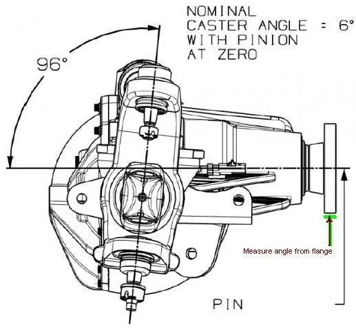

When we got our 19 I drove it for around 100 miles stock, the steering was rock solid. I was going quickly over rail road tracks and just trying to make sure it was solid this was on stock suspension and 37s wrapped around mopar simulated beadlocks. At 100 miles, I pulled it on the lift and installed the MC game changer rocksport along with front driveshaft and full underbelly skids. The next morning took it for an alignment. Caster was set to 6/6.1 and all jamb nuts were ensured to be tight along with every other bolt.
