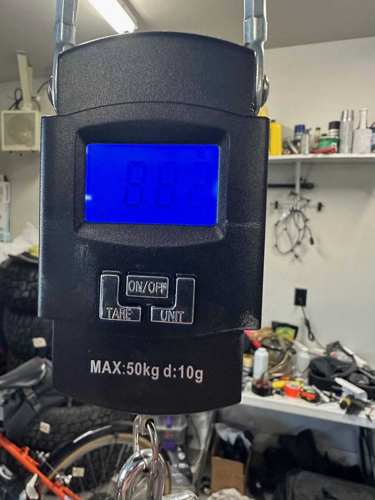

while I did not really need it I was lured and seduced by its beauty...:) these are pure beef 24.2lbs compared to oem's 8.8lbs. super easy install and easy to center your axle while it is installed..Northridge4x4 has them on sale and even gives the forum discount on top of the sale price...

Jeep Wrangler JL Steer Smarts Yeti track bar beef..... IMG_8123
Jeep Wrangler JL Steer Smarts Yeti track bar beef..... IMG_8126
Jeep Wrangler JL Steer Smarts Yeti track bar beef..... IMG_8119
Jeep Wrangler JL Steer Smarts Yeti track bar beef..... IMG_8122

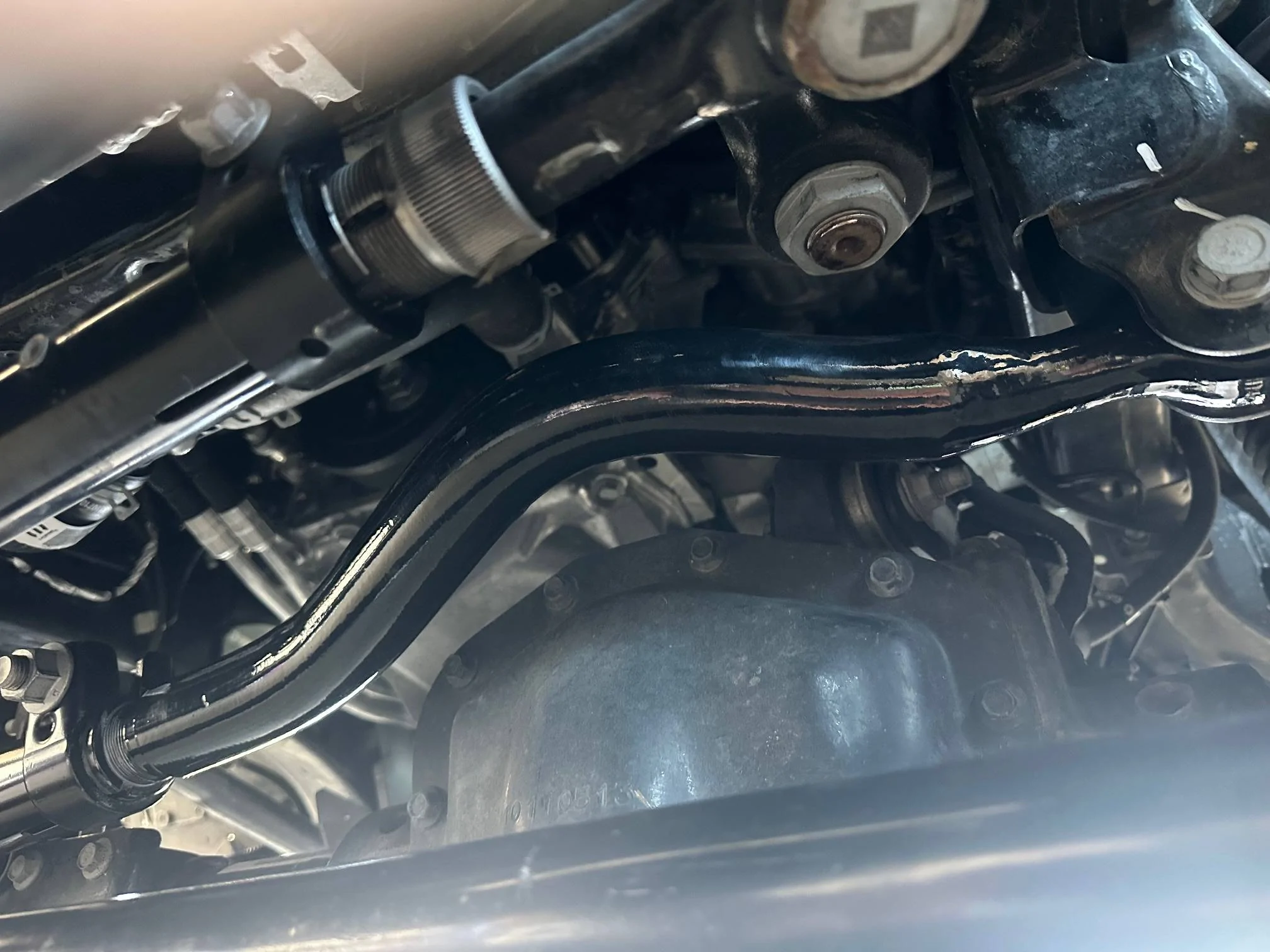

I bought the same for the same reason. I took them to a local (Riverside, CA) 4x4 shop and was told that they do not fit and that the Jeep would have to be lifted in order to fit. I have a stock 2018 JL Sport. No suspension mods. I know they fit since the maker confirmed it. Still looking for a shop to install. Just had to comment.

They are "YETI XD JL/JT PRO-SERIES FRONT ADJUSTABLE"
I thought it has to be installed and adjusted with weight on wheels. I don't have a lift that is "weight on wheels." If I measure correctly then I can install with a frame lift? Can I install then 'settle the vehicle' before final tightening? Thanks.

you just leave your jeep on the ground no lift needed....measure your distance between your stock trackbar bolts and set the yeti to that distance remove your stock one put your new one in....you can make slight adjustments to dial it in to center your axle while it is on the ground...super easy....even for a beat up old drunk like me.

you install the frame side bolt first and if for whatever reason your axle side hole does not line up just have some one push on the end of your bumper and it will shift over and line up...it is about as easy as it gets...if you can rotate your tires without cutting your thumb off you can install a track bar.
