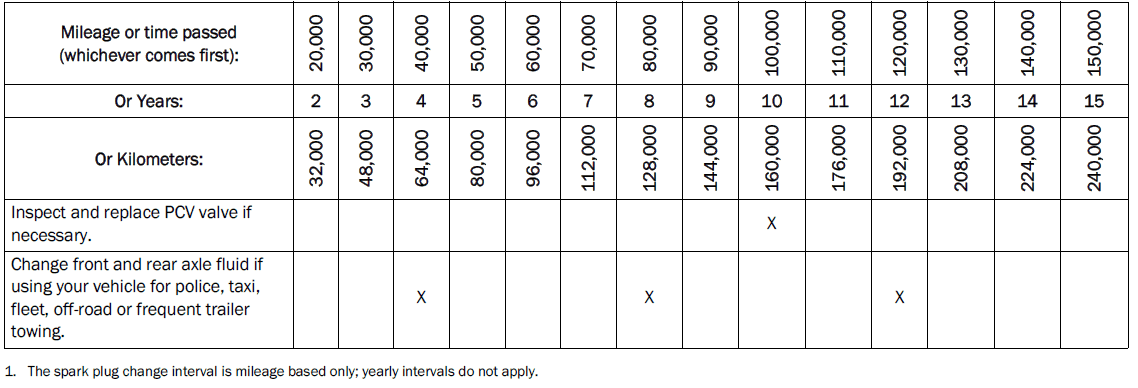

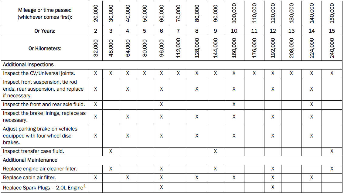

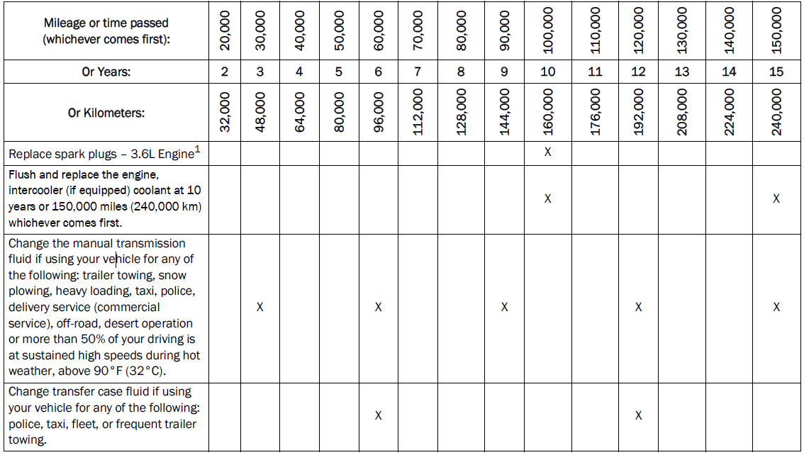

So, most are going to be earlier than necessary or fluff. Looks like they us lump sum pricing for all these add-on services, they'd likely be less with the standard hourly.
Here's the maintenance schedule. "Fuel Injection Service" isn't on it. Brake fluid isn't on it, and it's a little extreme for 30k anyway unless it's been contaminated. TCase fluid is on the 6 yr/60k line for heavy use. Diffs are 4 year 40k for heavy use.
