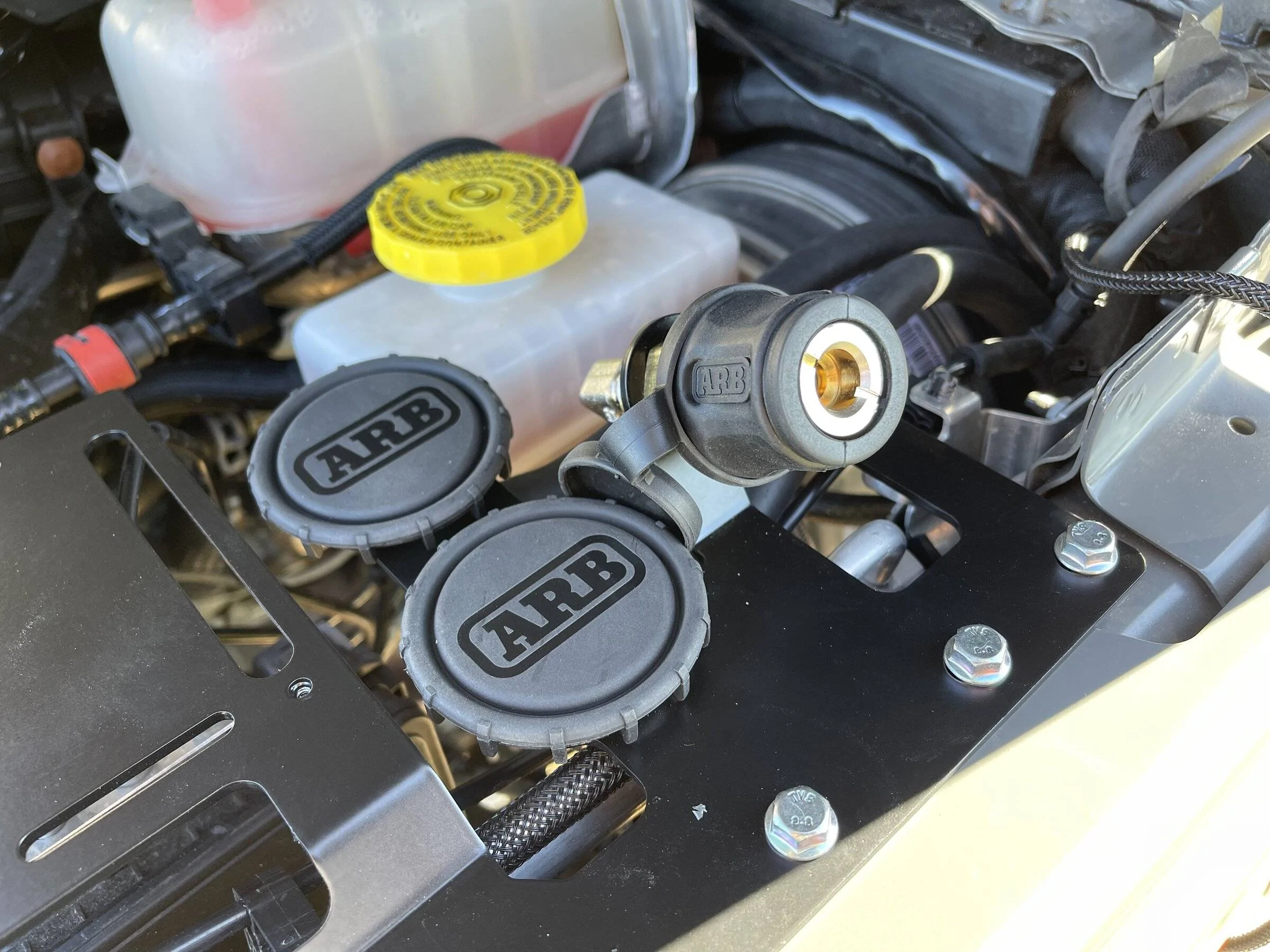

I actually had my clutch position sensor come loose... My fault, had a hose pushing against it for my air compressor… I looked everywhere, chased wires as it happened not long after I installed the Genesis dual batter kit. Even pulled the starter and tested it. Eventually pushed started it and it fired up. Day of troubleshooting, lots of forum searching and cursing. Stepfather comes up and says,“are you sure the clutch position sensor is working?”
Felt around there, sure enough it popped off and was hanging there. Trimmed up the hose, popped it back on and all has been good.
See picture, you can see where the two hoses for the filter was running. They where interfering with the clutch position sensor.
