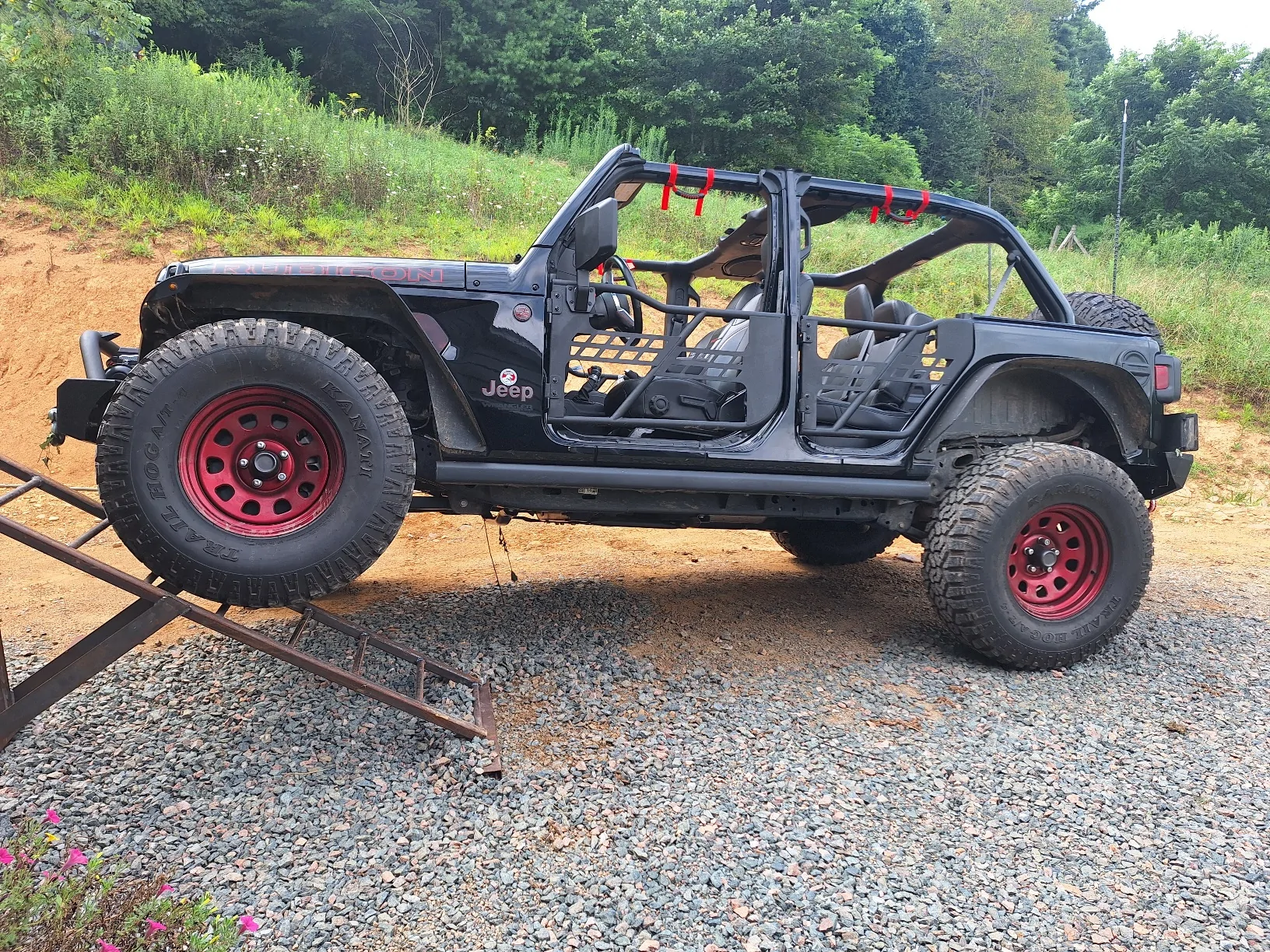

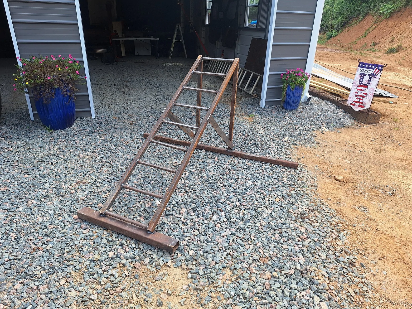

Made this, which I need to brace ,put rear legs and an axle/hitch coupler on.

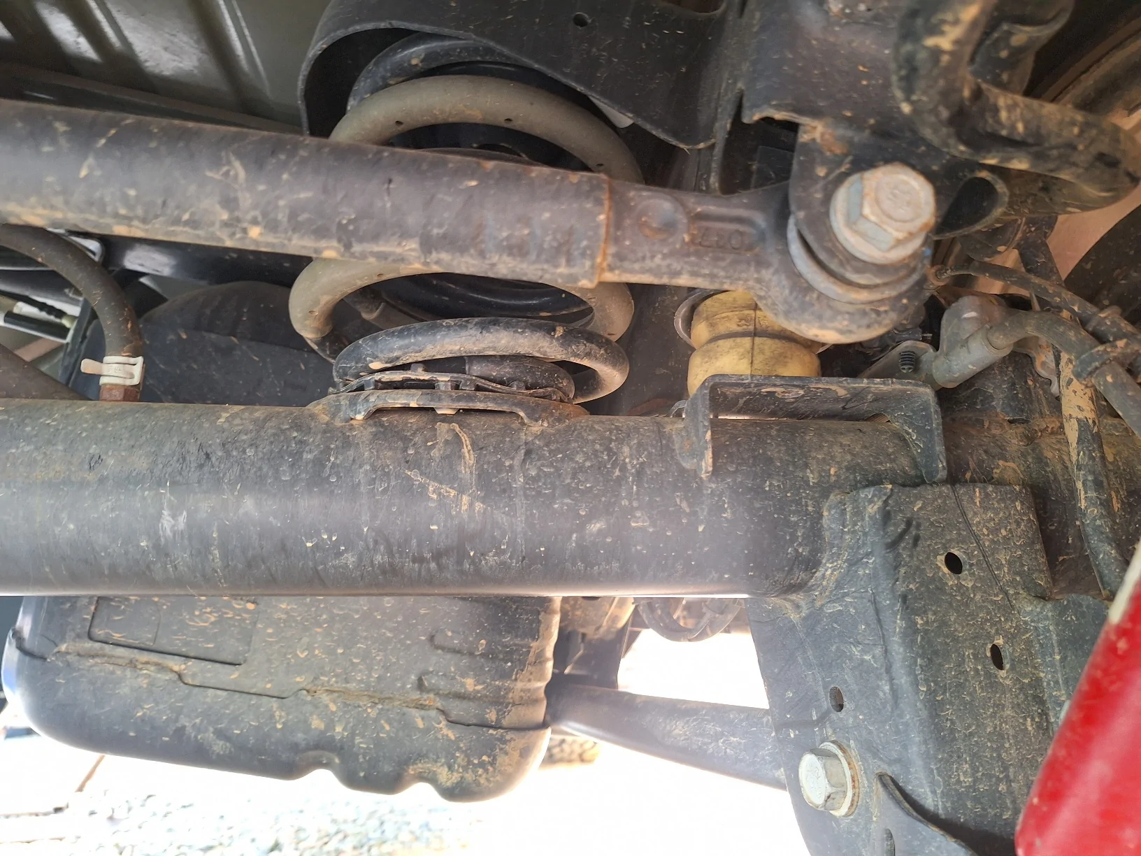

Rear bump stops are perfect, right at 1/4-5/16 clearance with 37's. On squashed stop

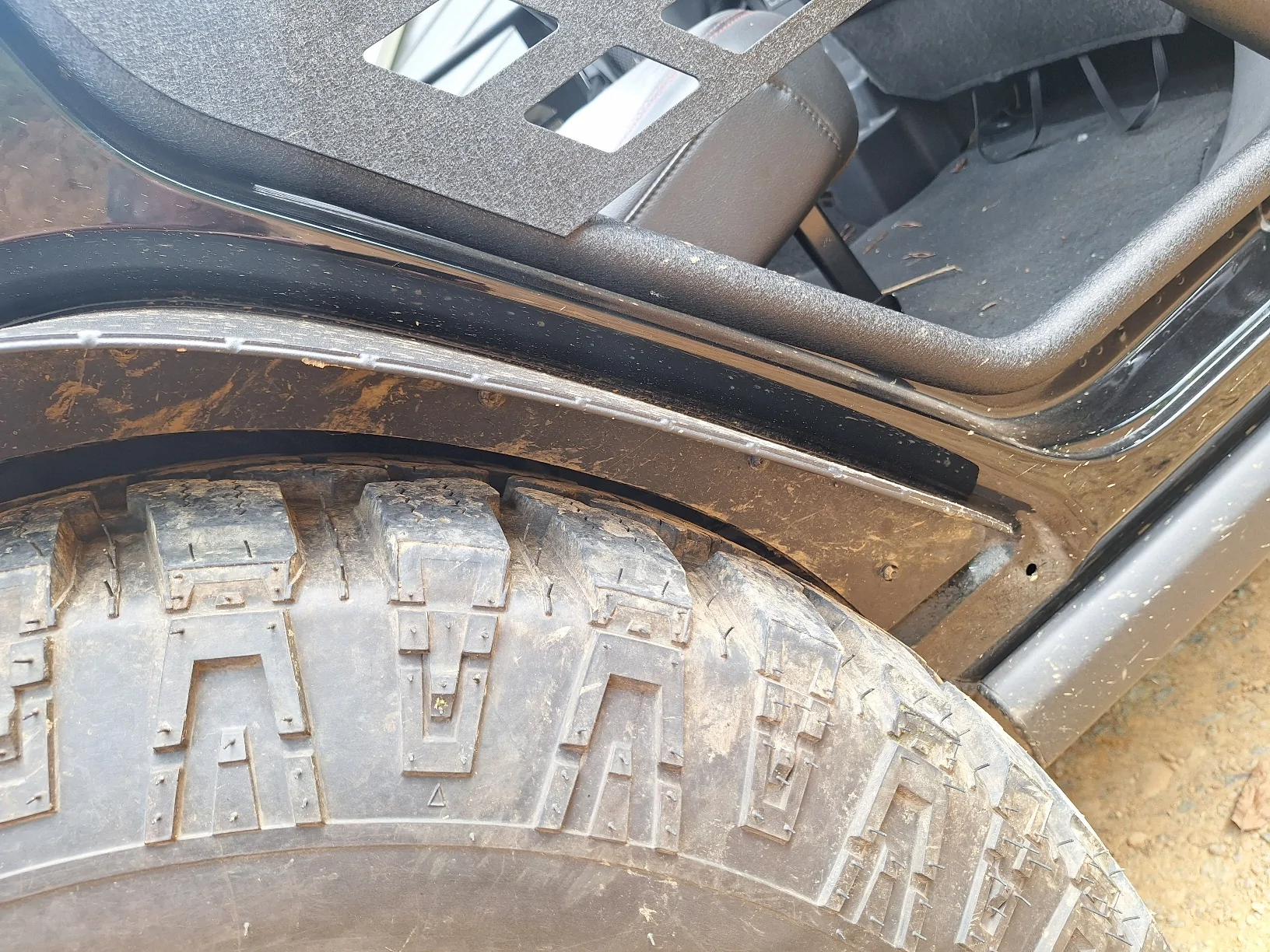

No rub from rear, perfectly centered with stock lift.

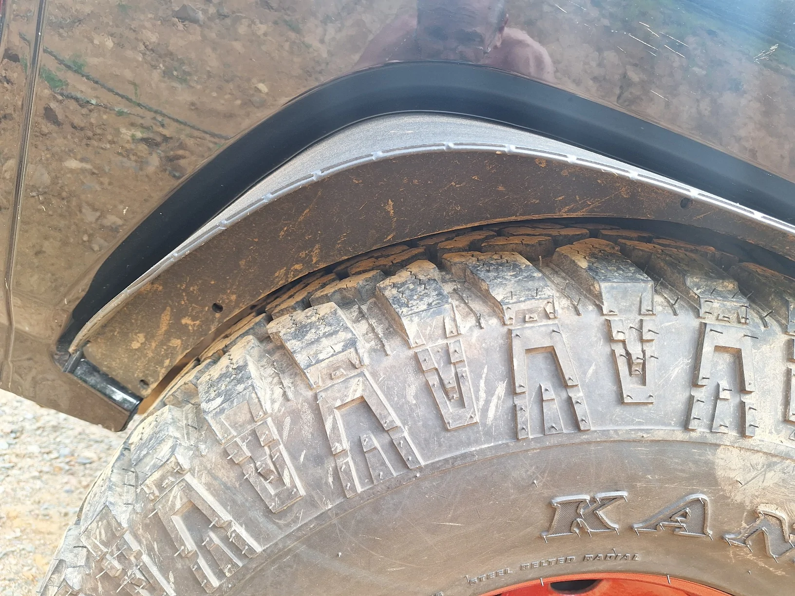

Front not so much, it needs a little lift and more bump stop....ONLY WITH swaybar disconnected. Connected no rub but I lost 12 inches of ramp travel.
Need to extend ramp before more testing with swaybars disconnected.
