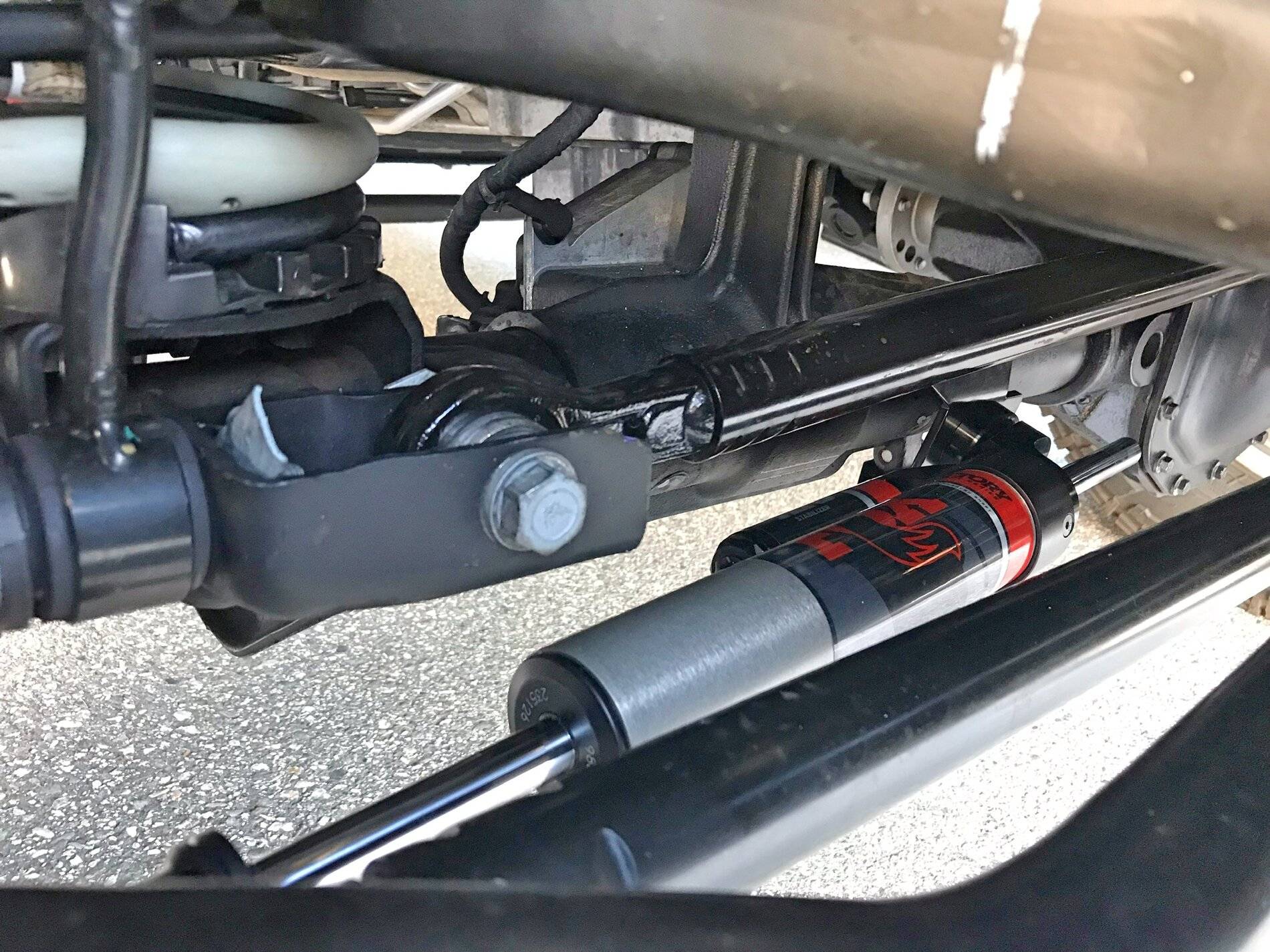

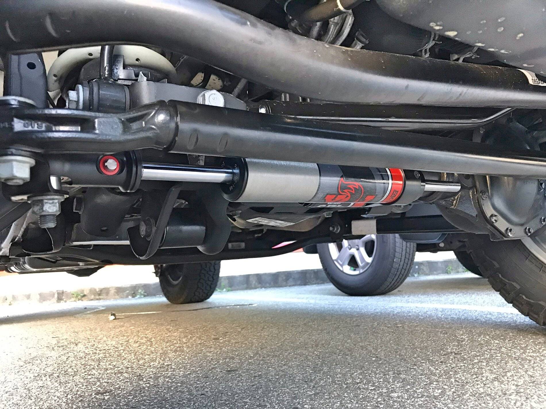

Good call. Sorry for the late response. Attached photos to illustrate the fitting on my particular Jeep: ~2" bump stop extensions, 3.5" lift, utilizing Rusty's aluminum drag link and tie rod, along with Synergy track bar and Synergy axle side stud mount (was previously fit with Synergy tie rod and drag link, done similarly, although the clearances were slightly different).
Pictures 1-3 show the alignment. You need to utilize the appropriate spacers to allow full articulation of the stabilizer joints, while allowing appropriate clearance through all suspension articulation conditions, including steering at angles. (When utilizing spacers on the mounts, ensure the capture bolt still engages correctly and seats)
Pictures 4-5 illustrate where the reservoir should be rotated to. It may be difficult to see in the photos, however, the reservoir does not (mostly likely wont) be fully vertical and that is perfectly fine. You, again, need to ensure appropriate clearances through all articulation angles, including steering at these angles.
Picture 6 illustrates what happens when the reservoir is placed on top and you bottom out the suspension with ~2" bump stop extension (my case). With 3" bump stop extensions you may not have this issue, you need to inspect yourself.
NOTES: As stated previously, each application requires inspection and adjustment as clearance may be different. Additionally:
- Steer lock-to-lock and inspect clearances.
- Be aware although the tie rod and axle move in a linear motion with the stabilizer, the clearances changes through steering.
- In my experience, the tie rod does not typically present much of a concern. The drag link can/does depending on the model (of course) and so can aftermarket differential convers as they tend to be thicker and stick out further.
Hope this is helpful.
- George A.
