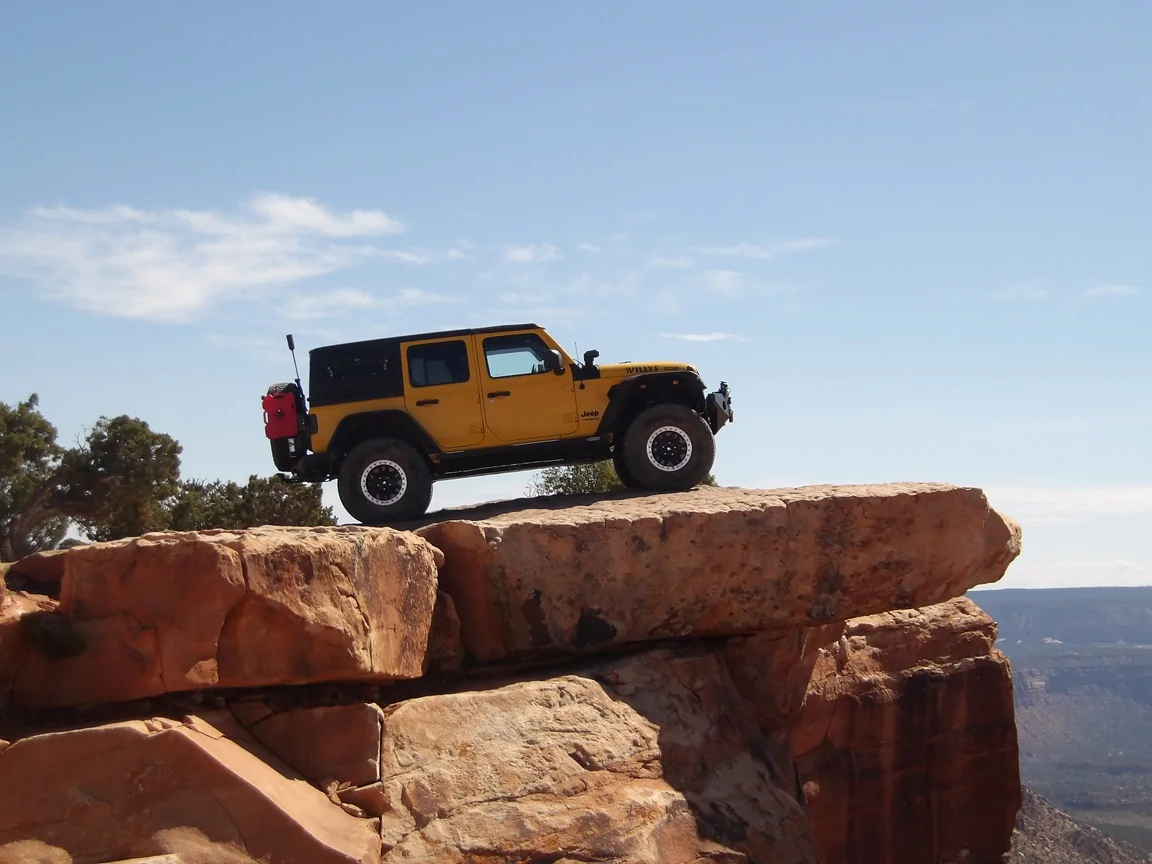

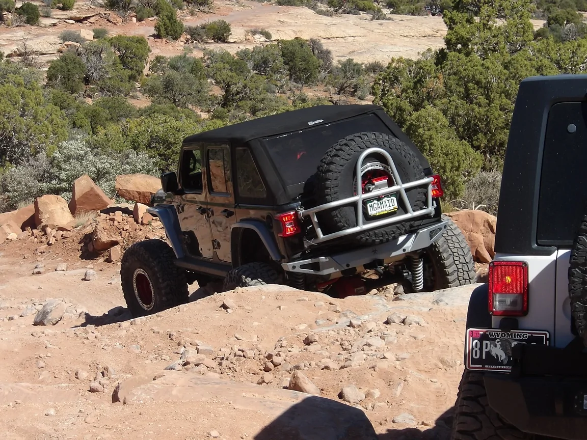

After trying 4 different set of springs including Metalcloak. I settled on 4.5 EVO Plush ride springs with fox 2.5 shocks.
I just spent a week at EJS 26 in Moab and not once did I feel a hard bottoming out even coming back down from Top Of The World.
Off road I adjust the large shock nob three clicks in and I am good to go.
For me this is the perfect set up. Rides more like a dirt bike suspension not like a harsh F450.

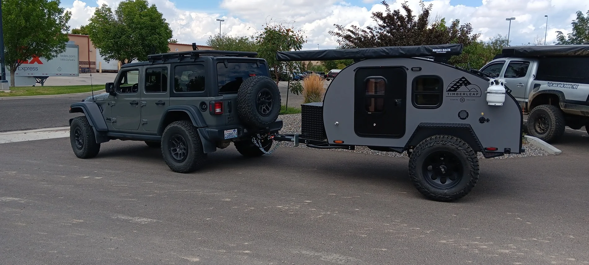

Along with more HD springs in the rear, you might consider these. That's what I'm using.
https://timbren.com/products/jrjk-jeep-wrangler-jl-jk-2008-present-rear-kit
23 JLU Willys XR 2.0T towing package, plastic front bumper.
Front factory XR springs with a 1/2" spacer, rear Clayton 2.5" springs. Jeep has a slight rake, but when connected to my trailer (which has a heavy tongue weight) it levels out pretty well with the springs alone.
