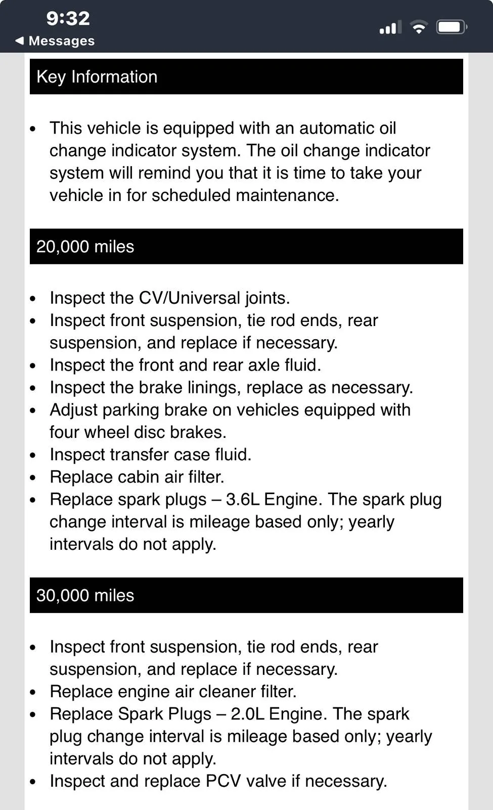

I just got my Jeep yesterday and got sent this service interval on my email. It says to change plugs at 20K??? Anybody do this or is there an error in this document?

Sent from whom? The dealer?
Have you checked the manual??

CDJR dealership, or a “buy here, pay here” dealership? From what I’ve heard, the 3.6 spark plug replacement process isn’t simple and probably a dealer money maker at the 100k mile mark. At 20K intervals, it looks more like a get rich quick scheme.

I got the same thing when my ordered jeep arrived last week. The email came from the dealer, but it's Jeep's content. It links out to a "fcaperformanceinstitute.com" domain. It is supposed to be a "vin specific" summary of parts of the manual with videos. The content is useful, but I suspect that particular item is just an error.
Jeeps own website and build tool aren't very accurate, so it's not surprising that they have incorrect content in one of their CMS tools as well.
EDIT: A google search of "fca performance institute" returns this variance of the URL: https://cms.chrysler.fcaperformanceinstitute.com/ which currently just redirects to the DealerConnect tool, which is one of the main interfaces the dealers have with the Stellantis OEMs.

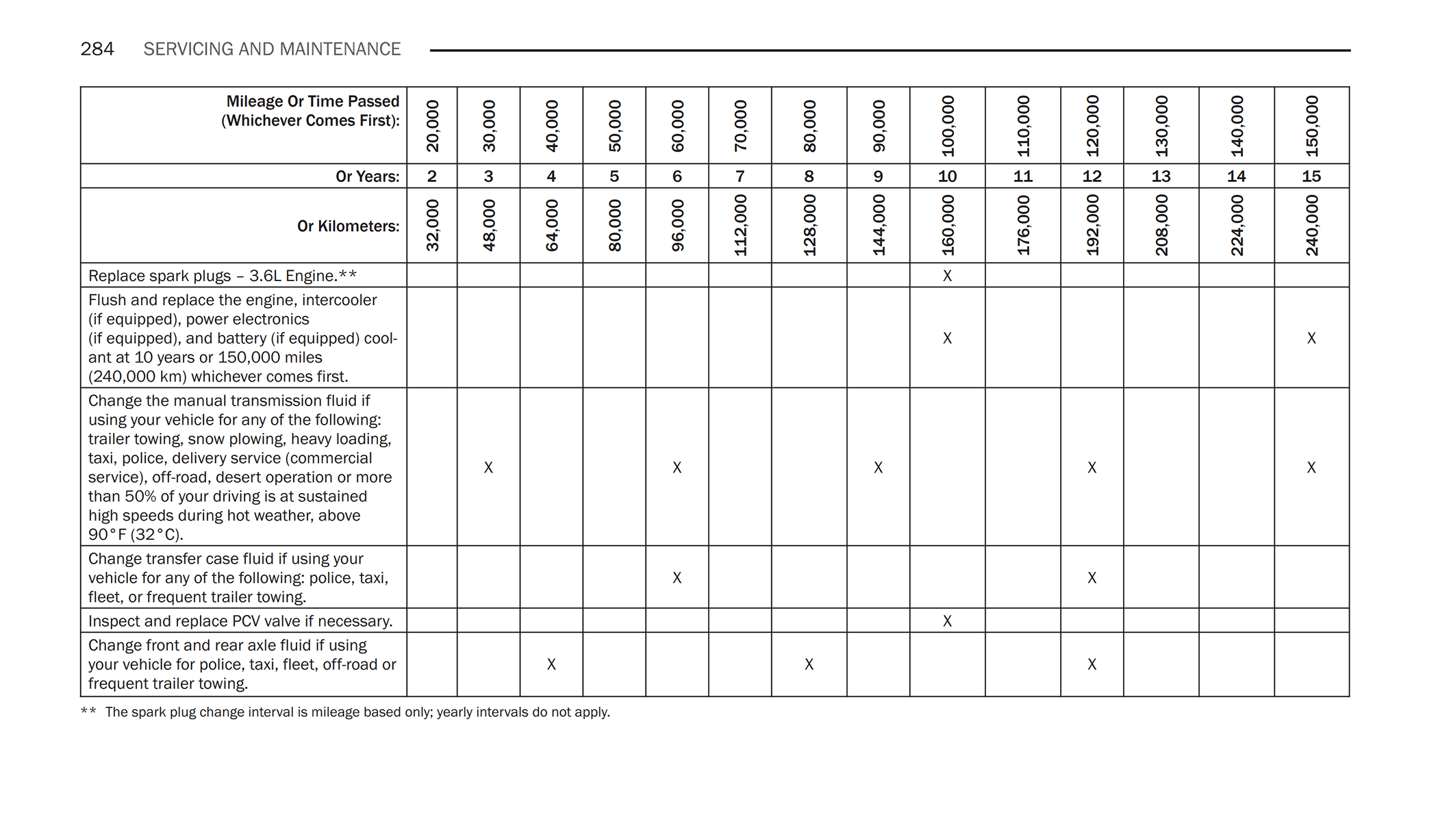

No way is a spark plug change needed at 20k. It’s 100k in the Manuel.
Here is my own maintenance schedule that I put together r based on the manual. I didn’t like the graphic way it’s in the manual, and I also change my oil more frequently than the it recommends. Oil is cheap, engines are expensive.

20k miles? Maybe if this were the 70s or earlier. I haven't seen a platinum plug vehicle manual recommend anything other than 100k miles. Dealerships and oil change businesses always recommend very frequent maintenance that go against the designer's recommendations.

Although this is sent by the dealer the actual information is provided by Jeep (FCA). No conspiracy, it’s just a mistake on Jeep’s part.

Well, manual states 100,000 mi. for the 3.6. I changed the plugs on my 2018 JL with 3.6 engine at 85,300 mi. and all I can say is........ I sure am glad I did not wait until 100,000 miles.. Removed plugs were looking bad.... had I waited until 100,000 mi., I'm sure I would have had an issue..
I have had other 3.6 Wrangler's in the past and also worked on other 3.6 Wrangler's in the past... and knew better then to wait until 100,000 mi. for plug change.
Also did PCV valve change out at 85,300 mi.
