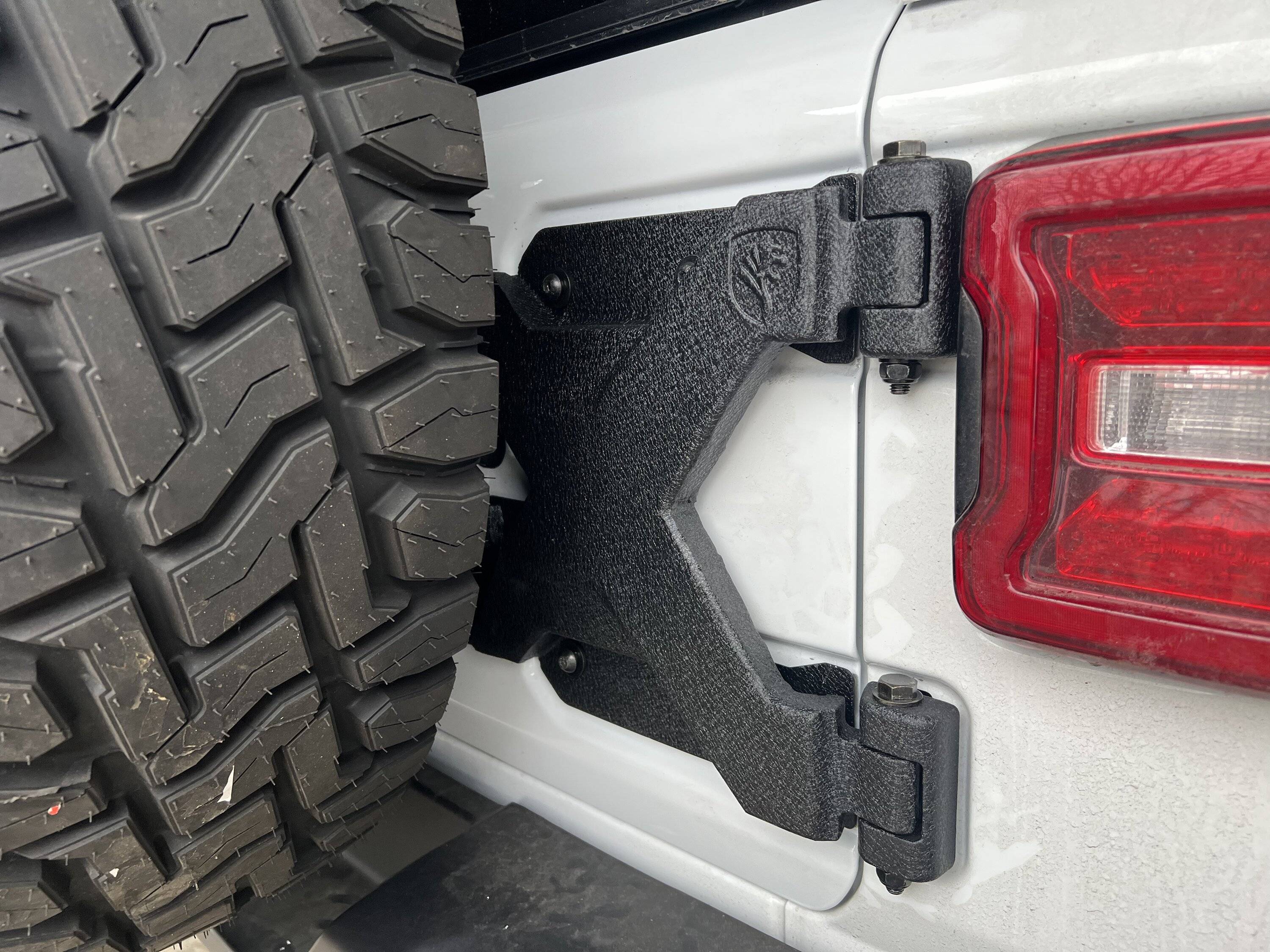

Just installed the tyger brand tail gate reinforcement. Seems solid
Jeep Wrangler JL Spare tire relocated and tail gate reinforcement CBE1F986-163F-4864-BD61-DA1E48C0D4C8

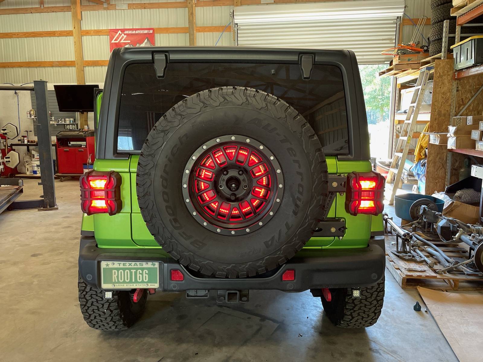

Just wondering...do the other brands mentioned here allow depth and tilt of the spare? The Spartacus has 4 tilt settings which I thought was pretty nice. I can get the top of the tire angled and just clearing the rear wiper which I suppose is better for weight distribution as well. It's very tight to the rear window.
Jeep Wrangler JL Spare tire relocated and tail gate reinforcement 1674931965182

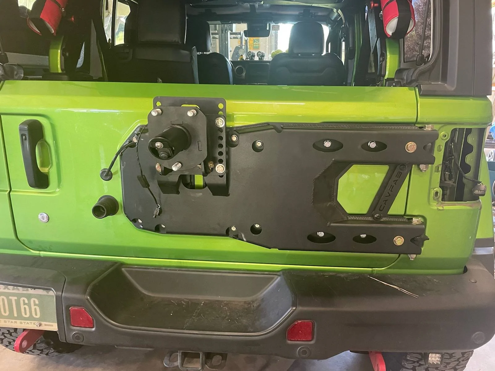

Damn they removed your tallight to install that thing? That cavfab is beefy!! i see you have a ton of elevation settings too. that or motobilt will be the replacement if this RR ever fails.
Just so that he could reach in and route the wires. It is really only 1 bolt to remove the whole tail light assembly (at least on the LED models).
Yeah -- @Headbarcode and some buddies hung off his and it would not budge and it was the reason I went with it. It is seriously a beast and when I added the LOD camera relocation, it means that I have nothing to remove to replace (aside from the lug nuts) to remove the spare.
I am building a set of brackets to add the OEM 3rd brake light back to it and that part will be 100% completed.

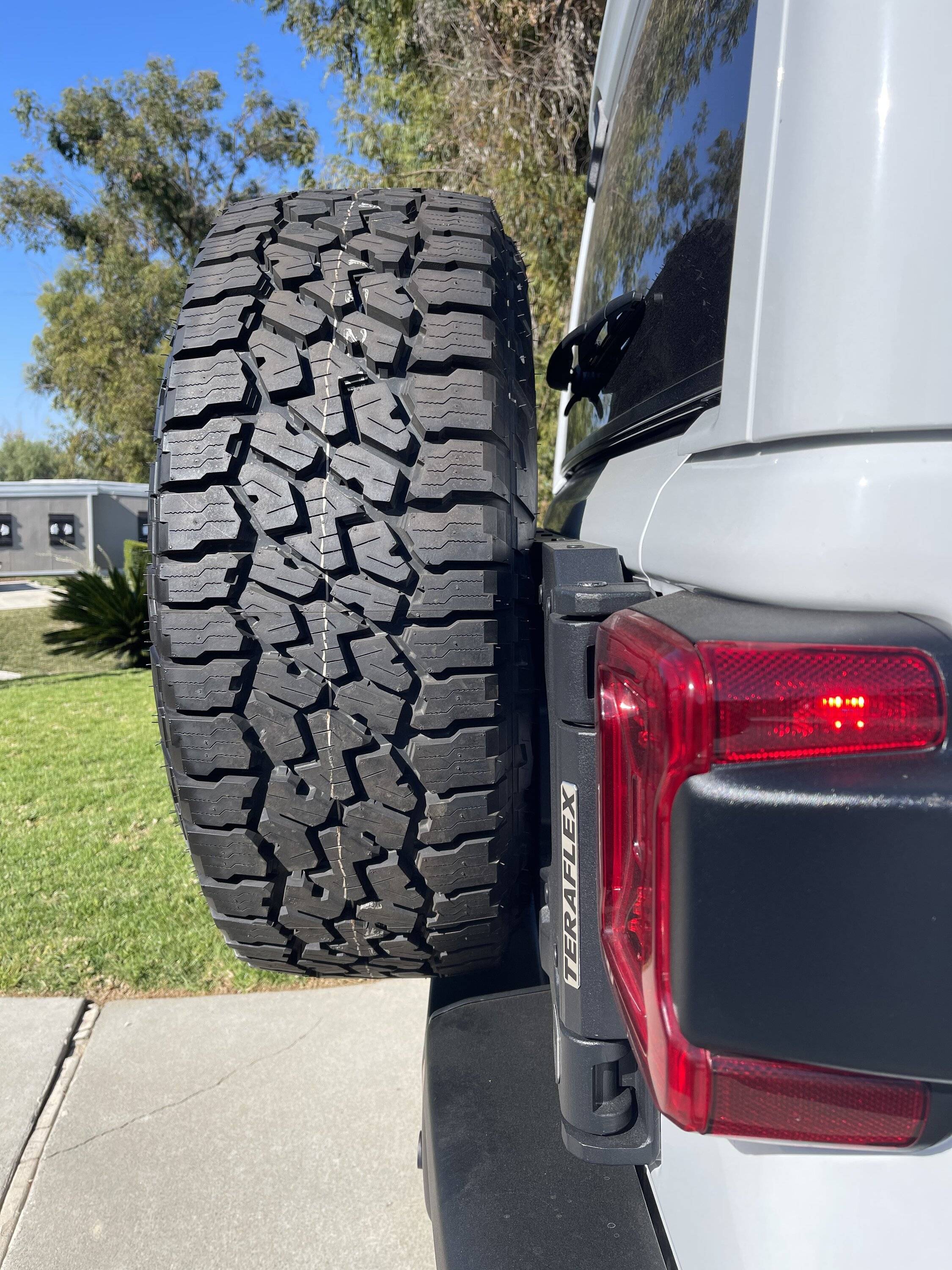

The Teraflex can’t, but it pulls the tire TIGHT. This thing doesn’t move at ALL ? I may try bumping it out just a hair so it’s still tight but doesn’t distort the sidewall as much.
Jeep Wrangler JL Spare tire relocated and tail gate reinforcement 6F1E86F7-8D68-4751-8953-653F9AD9874E
