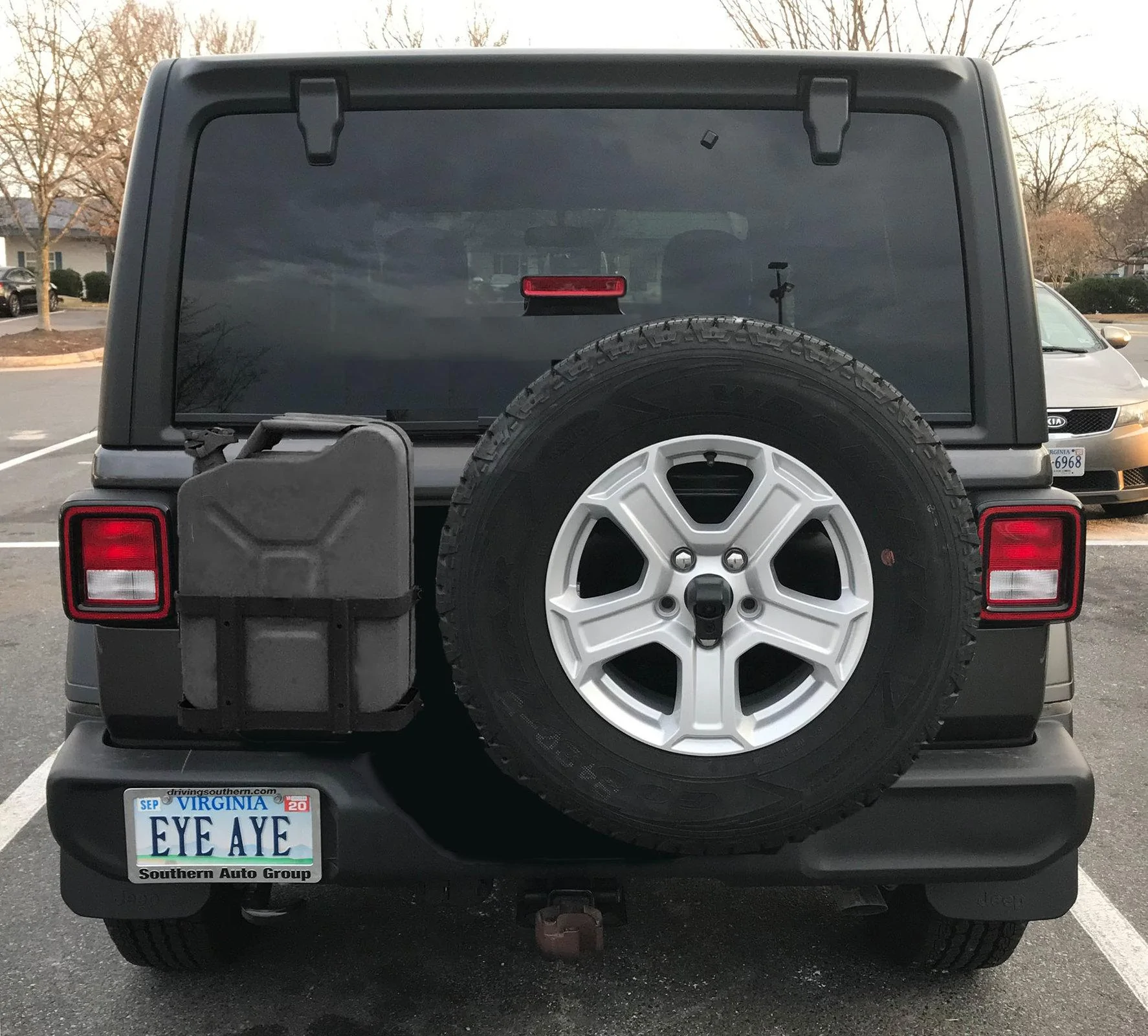

I was wondering if anyone knows of any aftermarket spare and gas can mounting hardware to make the back of a Jeep look more like a classic Willys? In other words moving the spare toward the passenger side with the can on the driver side. The picture is a Photoshop I did to show what I mean. Any help would be greatly appreciated!

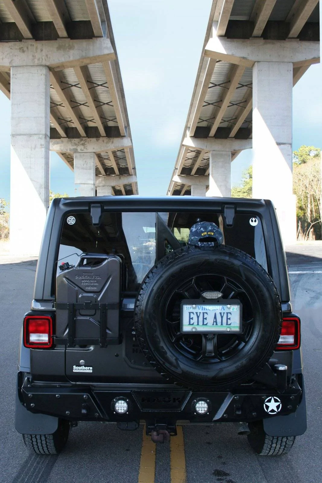

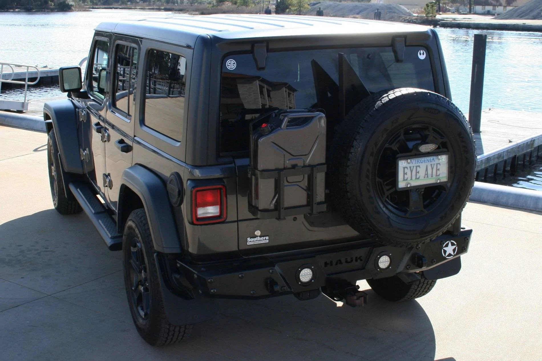

So JCR said theirs was only for the Gladiator and that it would not work on the JL. In fact, most every company and individual I asked said it was impossible. Then I heard about Open Air Jeeps close to me in Virginia Beach VA, and I talked to the owner about my wishes. He was excited for the project, and started to look for a bumper and tire carrier to modify, because almost all of them had a tire cutout/well in the center. He discovered a great option from Hauk Offroad. We ordered a bare metal bumper and tire carrier combo, and his shop went to work modifying it, then getting it powder-coated. I couldn’t be happier with the result. I love the look of the Hauk bumper, especially with the dome topped hex bolts, as well as the hinge mechanism that mounts to the tailgate so that everything opens together. It means I can’t put on huge tires, but I am okay with that trade off.
