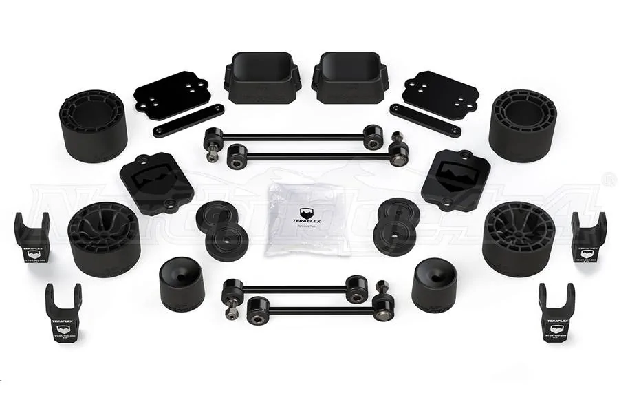

Jeep Wrangler JL Spacer lift 1000016102
Teraflex 2.5 typically sells for about 500. It's not bad, but kinda expensive for what it is.

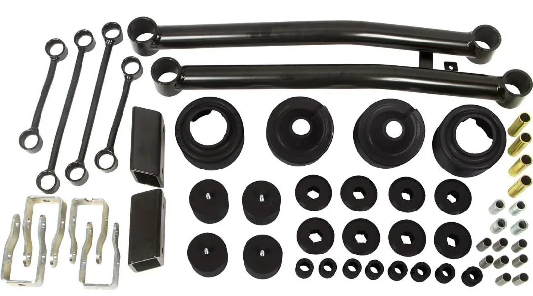

Jeep Wrangler JL Spacer lift 1000016104
Daystar actually includes longer lower control arms, which helps to correct the caster after the lift from the spacers. Currently on Amazon for 230. I started with this kit 4 years ago.

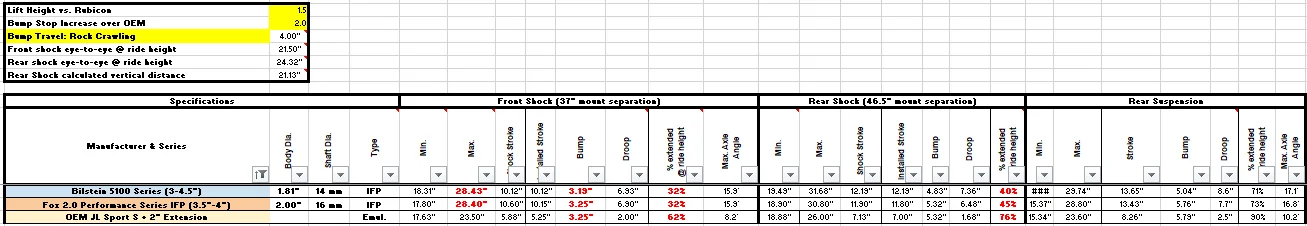

5. Shocks. With 2" of bump you can run Bilstein 5100 3-4.5s which basically max out your Jeep's potential flex on a stock driveshaft.
With 2" of bump, the difference between your sport shocks with extensions and those Bilsteins will almost double your flex. They are firm, another option for a little more coin is Fox 2.0s with similar results:
Jeep Wrangler JL Spacer lift 1707405456029

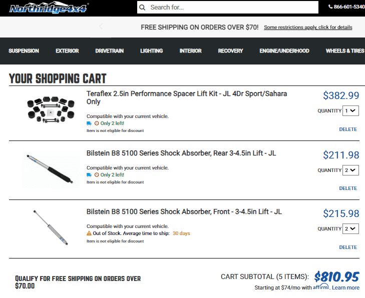

Other than QDs, a TF/Bilstein package would looks something like this:
Jeep Wrangler JL Spacer lift 1707405745189
