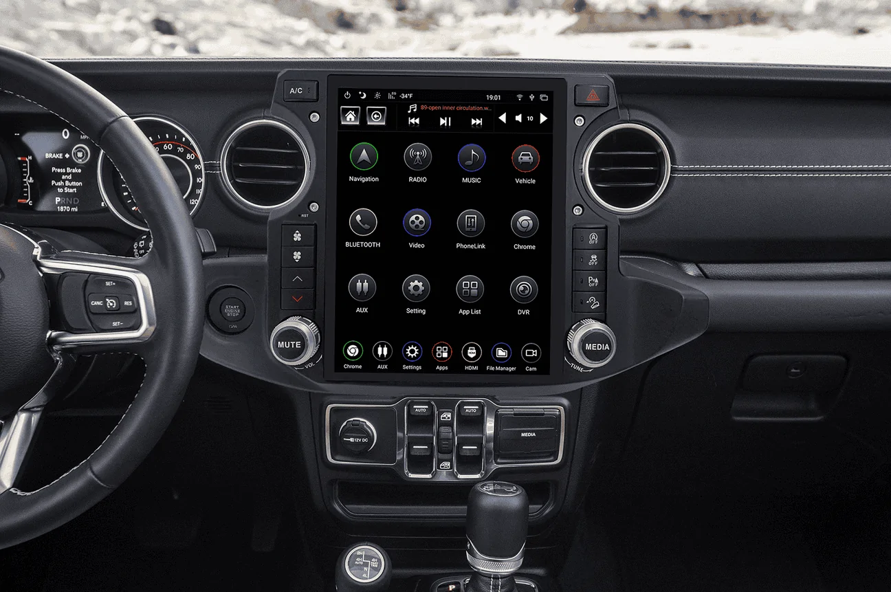

I want to put new stereo possibly, as I'm sure the sound source on factory head unit are not great.
Mainly I want to add audiofrog component speakers, and my kicker subwoofer.
This seems interesting.
Jeep Wrangler JL Sound upgrade questions 3_1296x (1)
I do notice that dual zone climate control is not incorporated into this?
