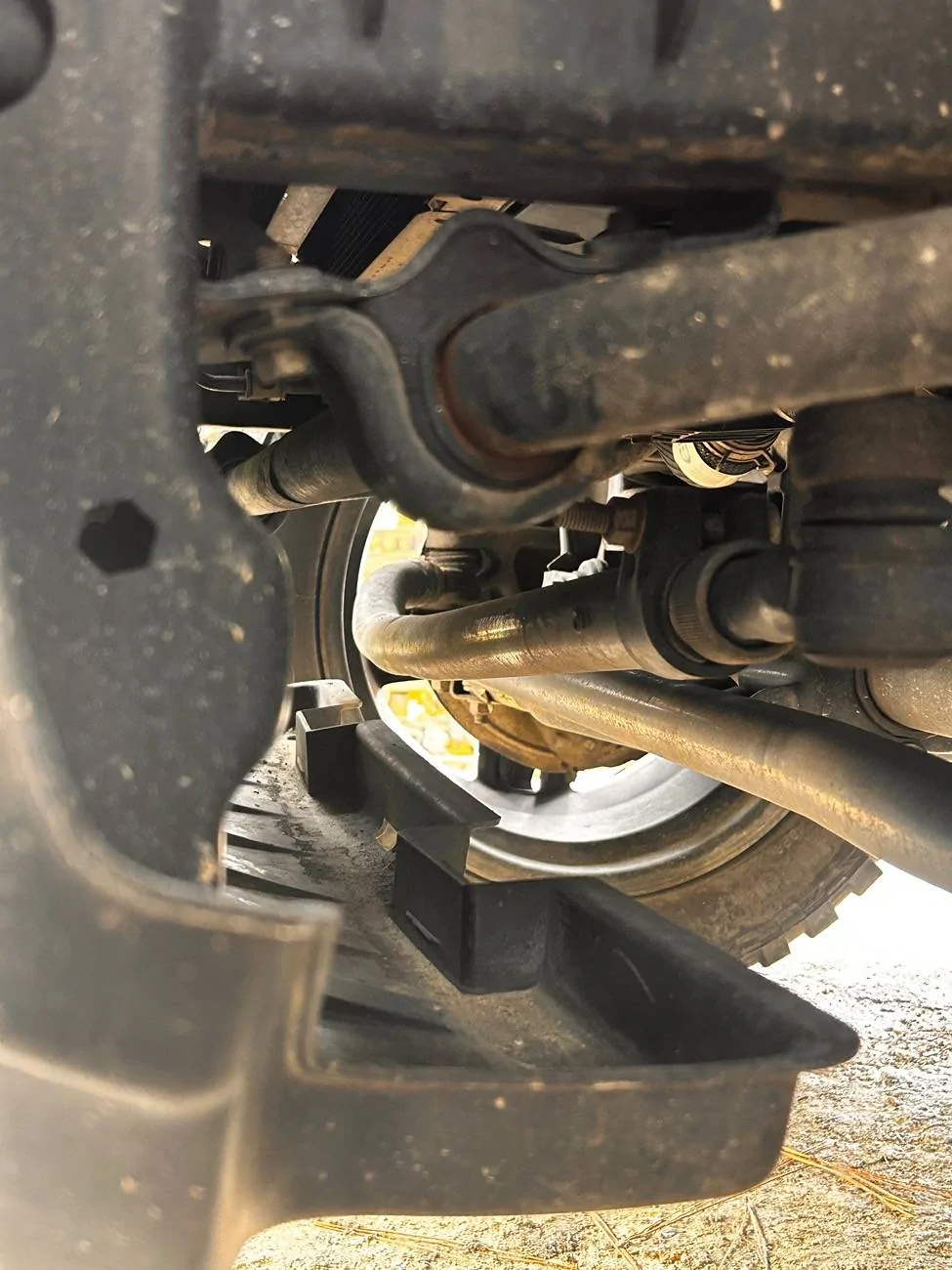

Actually bent my drag link

The streets in the Dominican Republic sound like they deserve your attention when driving on them :surprised:. Good that you found the problem and it is readily fixable. Maybe consider replacement with a stronger aftermarket version. MetalCloak makes a good one.

A bent drag link isn’t going to disable power steering. It would have to be physically binding for it to have that effect.

I would start with the drag link and inspect everything as you go.
You may run across more damage. That being said once you're in spec it should keep giving an error
