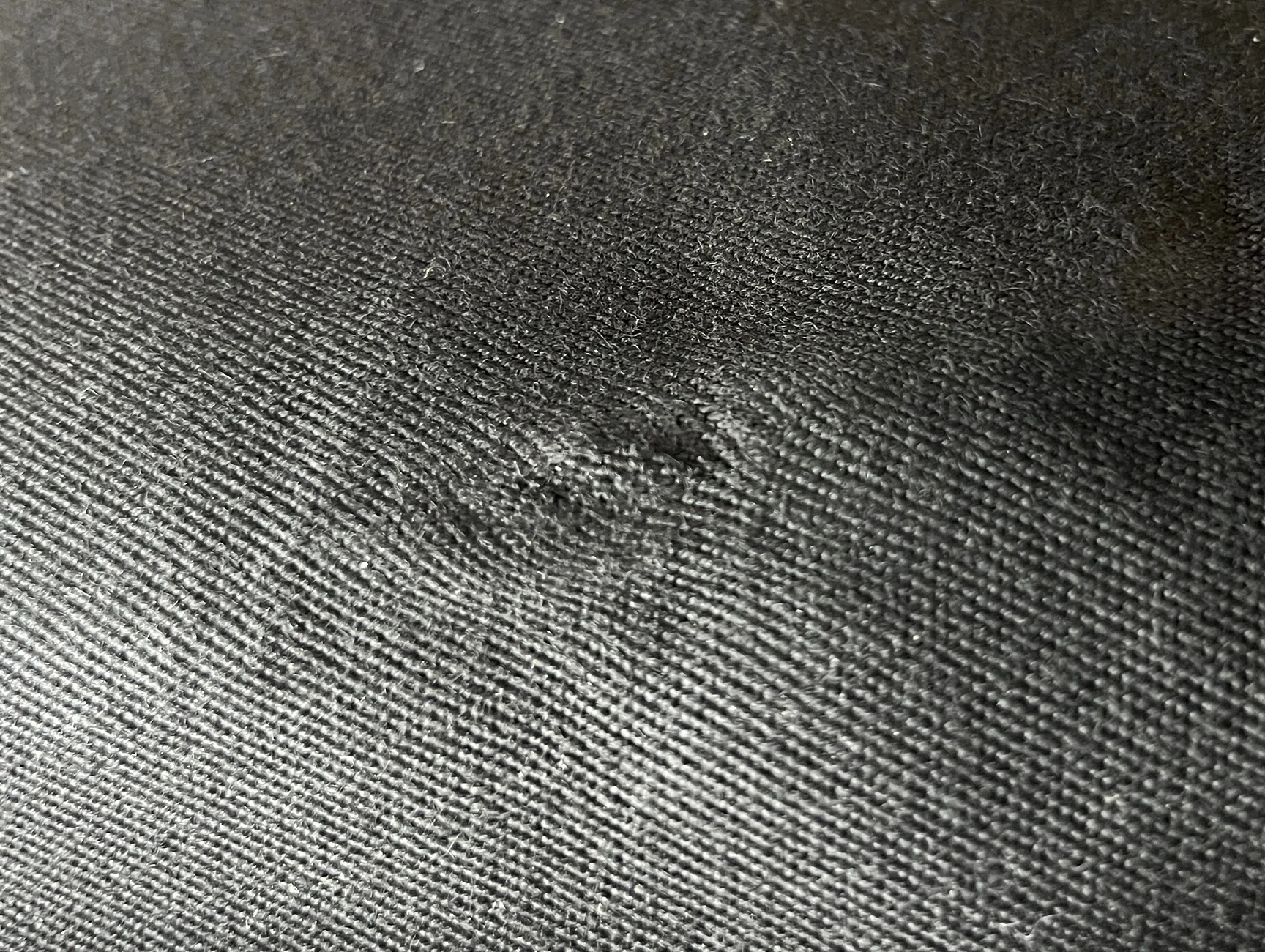

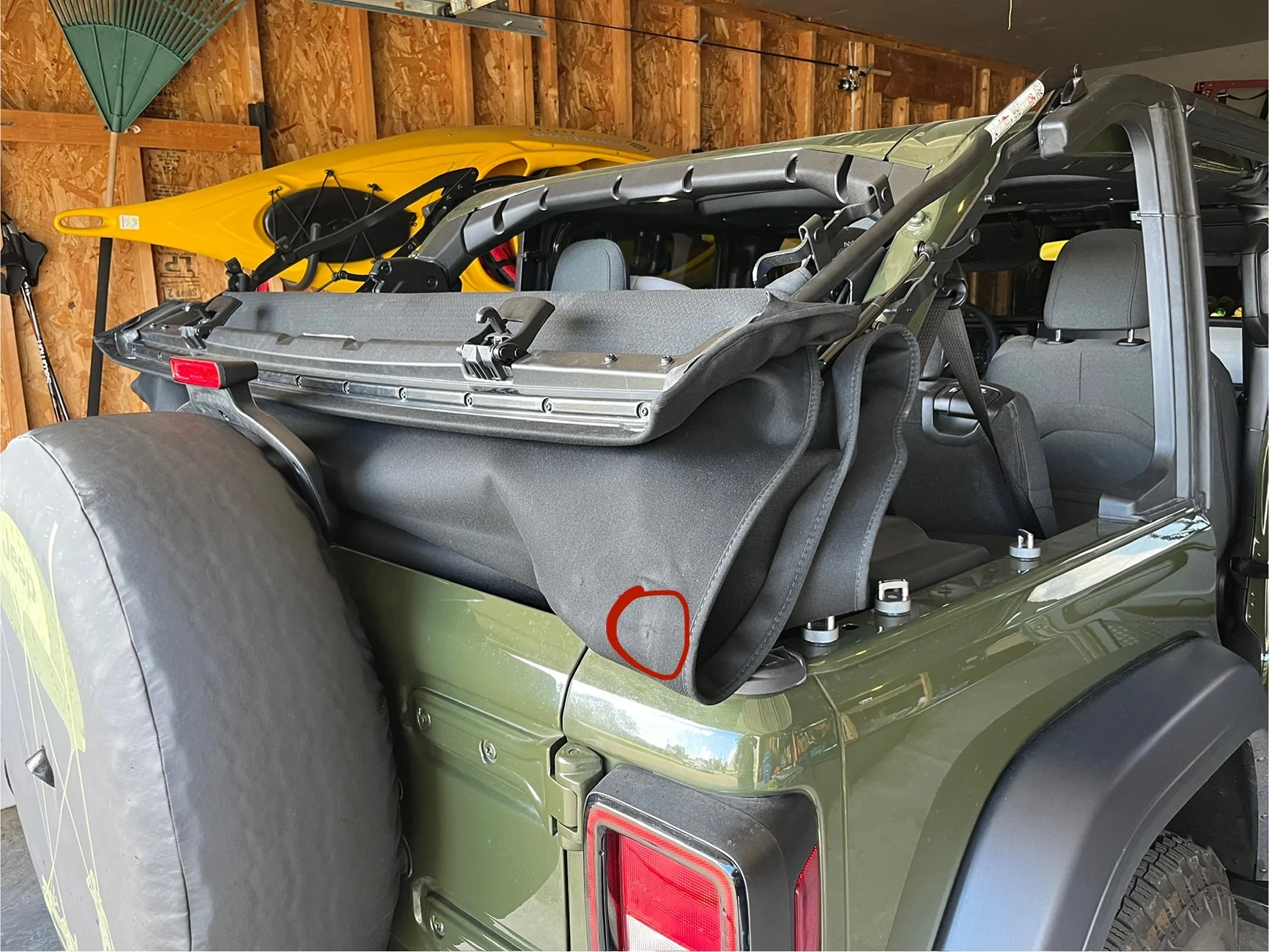

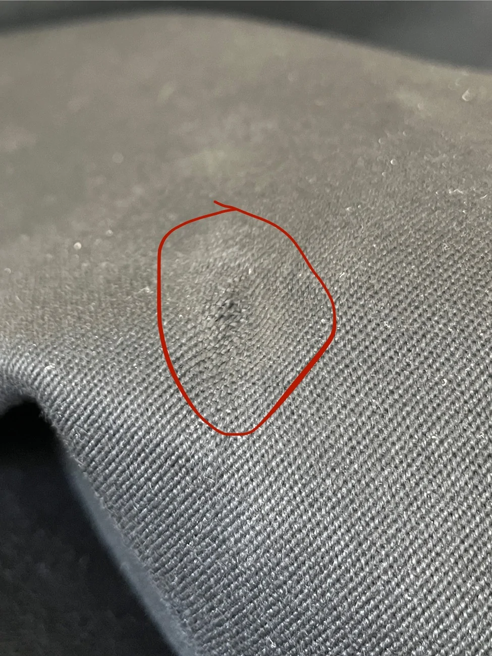

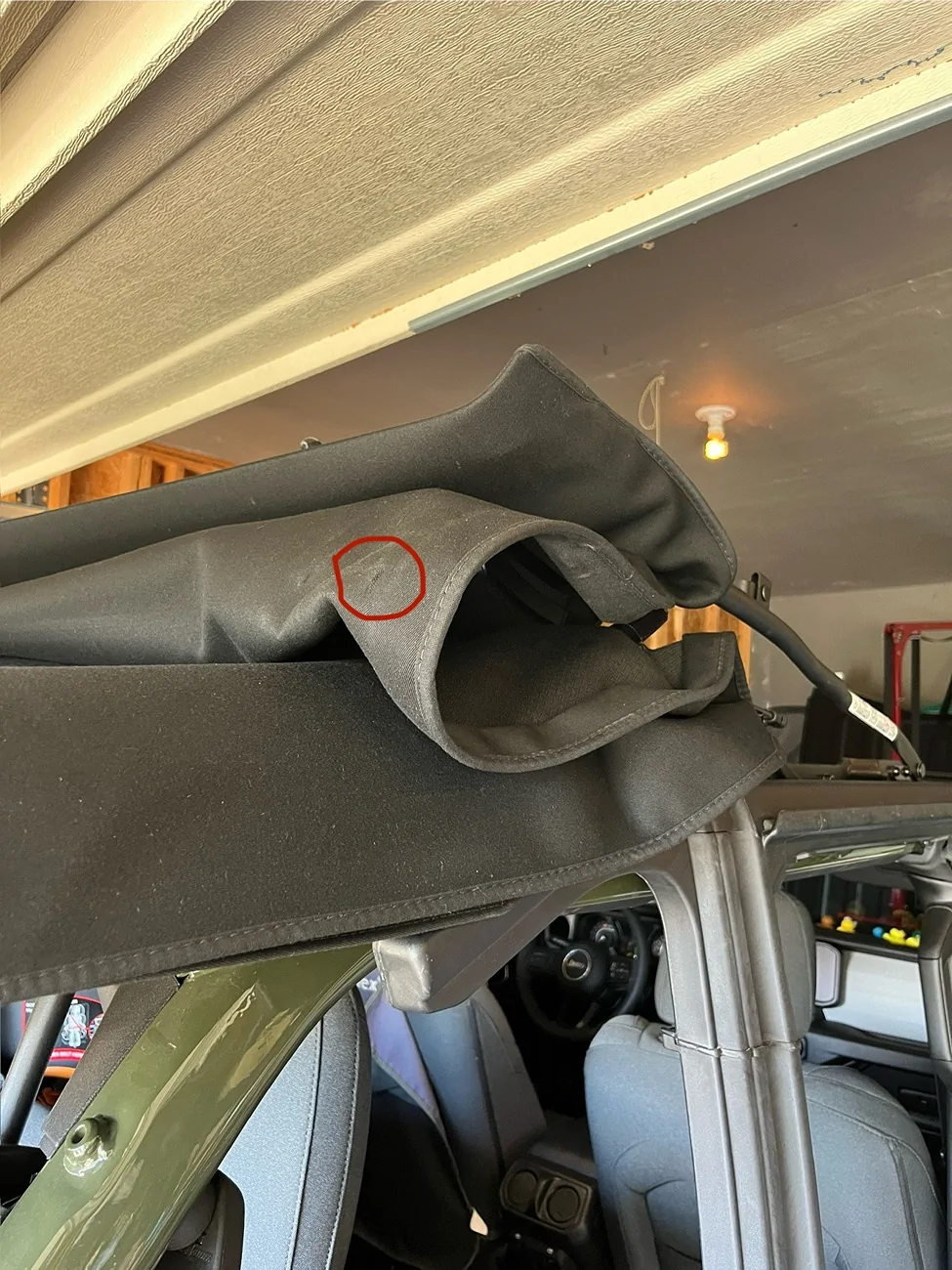

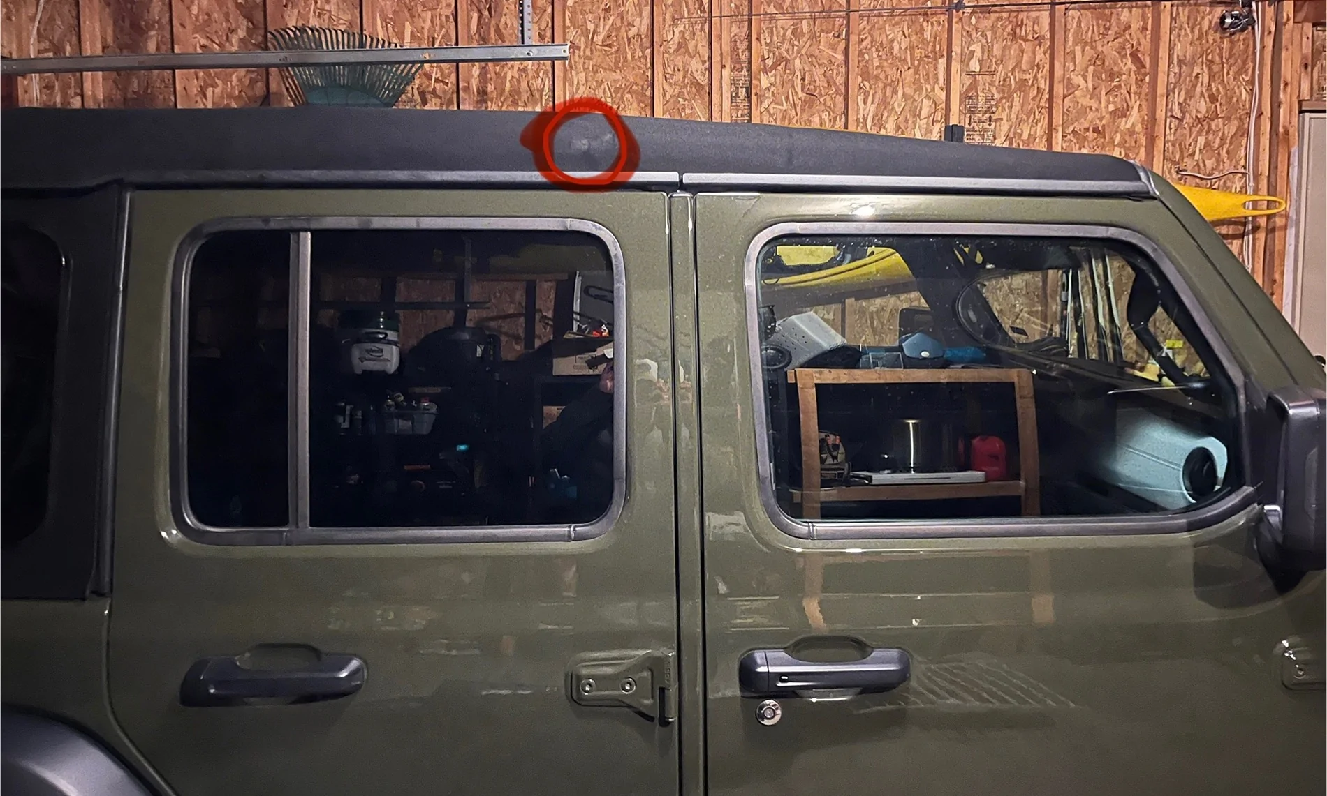

I have a small spot on both sides of the jeep (same spot) that appears to be wearing through and can’t figure out why. I tried to take some zoomed out pictures showing its location in safari mode, folded back, and convertible mode. Has anyone else noticed anything like this? Fibers are being stretches out almost like if you were pushing a pencil from the underside; not breaking through but stretching that spot.
After all positions it doesnt seem like it would be the fold over or convertible mode as it isnt rubbing anything in those positions. Even in safari mode, it doesn’t rub on anything obvious when I push down on it. Its about an inch in front of the soft top cross bar. That seems to be the only culprit. Even then, the top would have to pull up very far then push inwards to rub on the end of the crossbar.
Any ideas or thoughts greatly appreciated.

Yes. I determined that the wear marks occurred where the folded frame made contact with the underside of the fabric.
https://www.jlwranglerforums.com/forum/threads/soft-top-perforations-identification-etc.79575/
See post #4 for my fix.
Thanks for the quick reply and I will definitely try the patch. Hopefully it can at least slow the wearing process.
How have your patches held up? Sounds like it is unfortunately a design issue and not much else to do about it.
