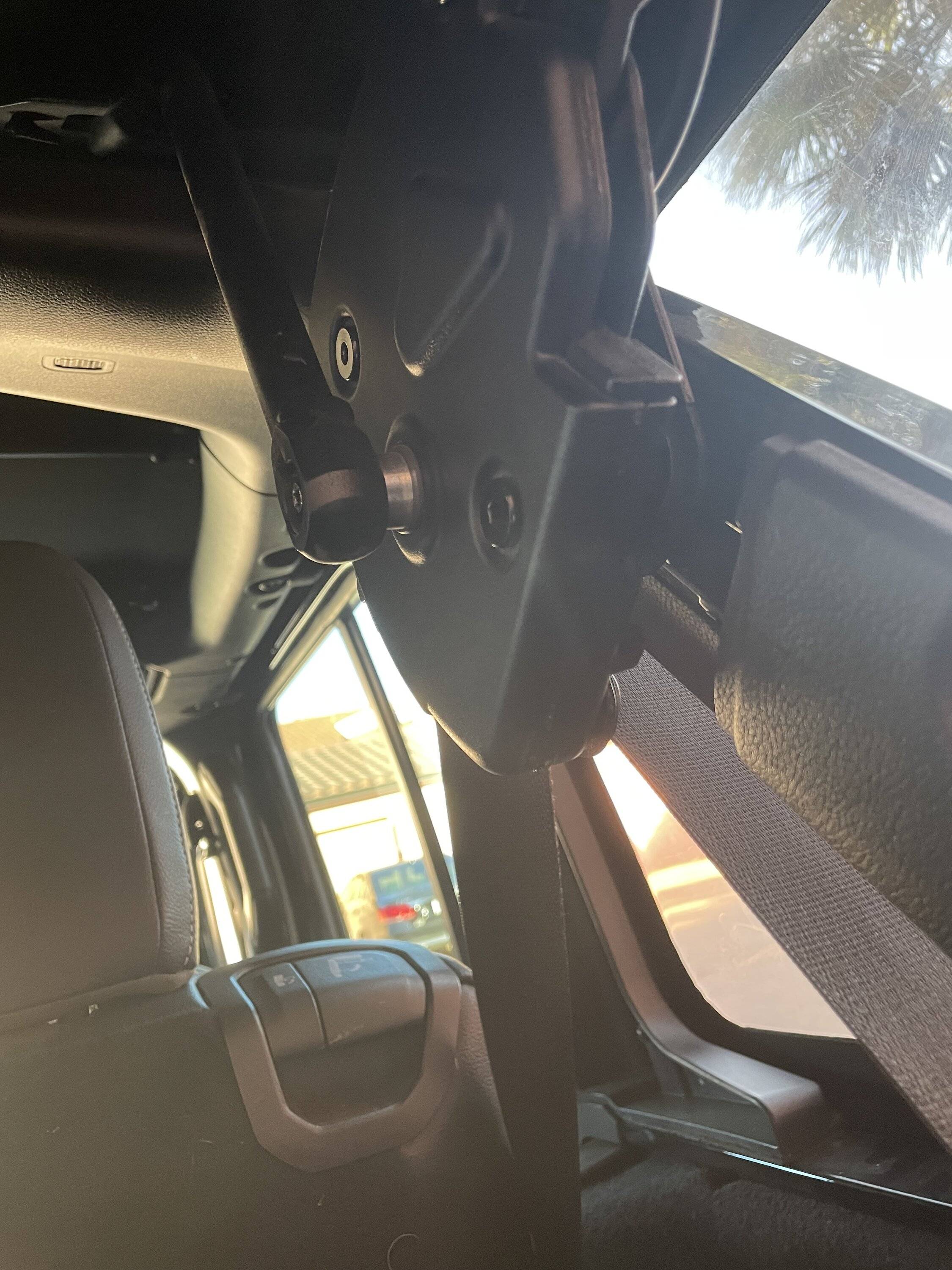

Hey all,
Does anyone know how to fix the keyed pin that the soft top slides onto so that it can rotate? It seems like it’s just press fit. I’ve tried tapping it back on with a hammer but will slide back off over time. Any help would be appreciated.
Jeep Wrangler JL Soft top hinge pin IMG_0829

Looks like you have the center bolt missing. Once you have one screwed in it holds the key in and doesn't allow it to come out. let me know if you have ant questions. I think I have that bolt and washer, I had a soft top that I ruined but kept for the spare parts for my new Soft top.
-Peter

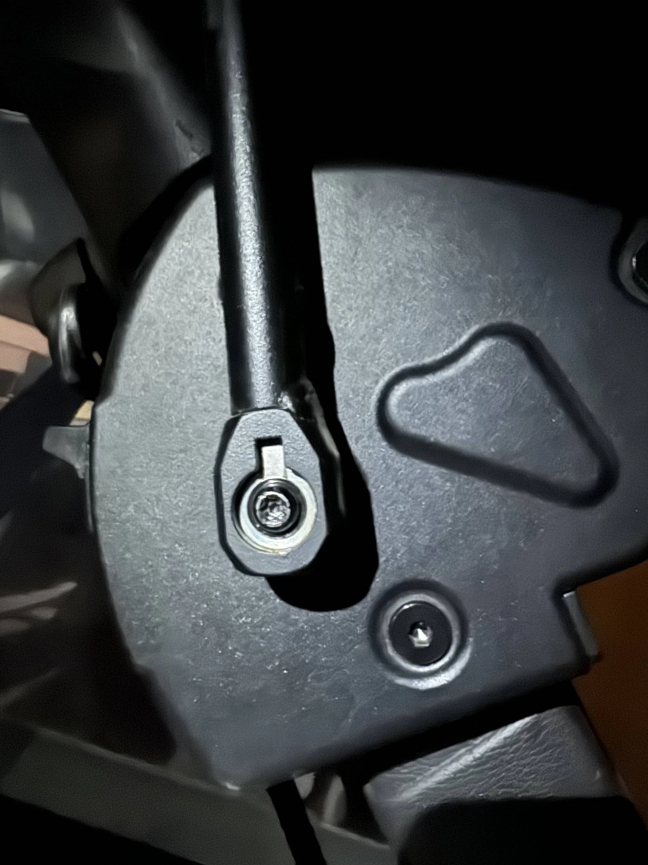

There’s small torx machine screw in the center. I thought maybe it was loose but was tight. It almost seems like it’s to hold the large silver pin in place?
Jeep Wrangler JL Soft top hinge pin IMG_0849

Thank you! I’ll stop at the parts store and pick one up! I thought it was just press fit on there or something !
