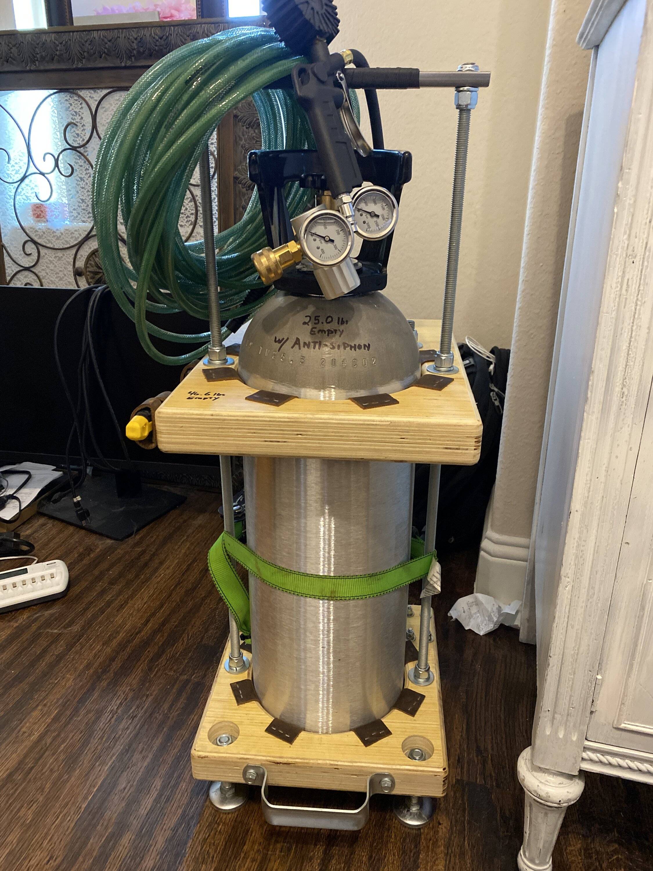

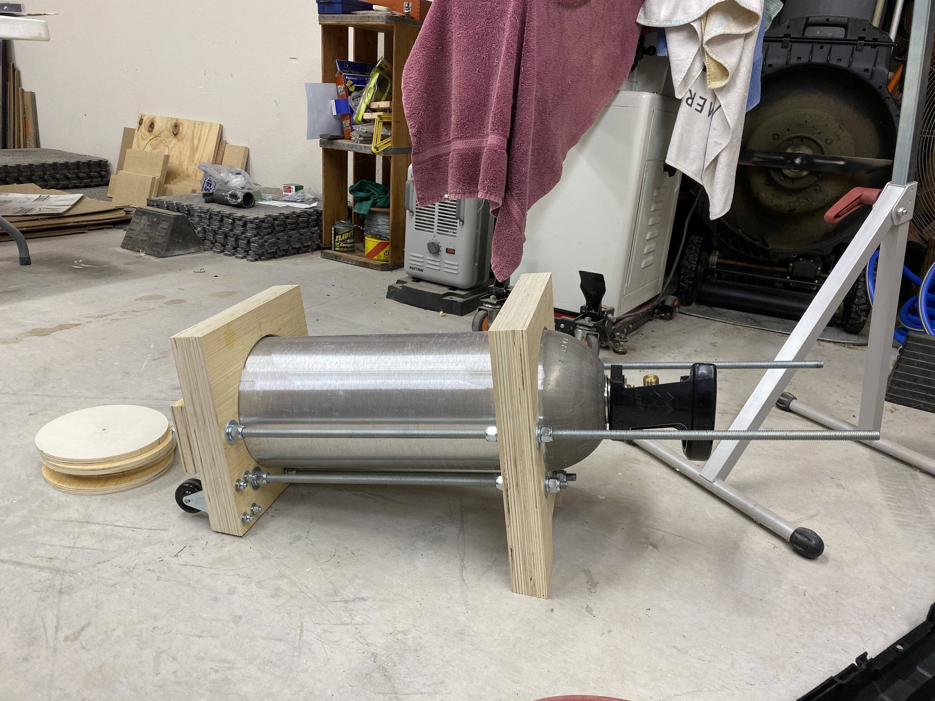

Have you considered using a snorkel tube in the tank to lay it horizontal or close to horizontal?
This is what I came up with for a 20# tank:
Jeep Wrangler JL Soft Top Friendly CO2 Tank Mounting Solution? BEBEF184-4F3B-44B7-895C-505B58B67755
before I finished it to show how it lays down:

If I remember correctly, snorkle tubes originated with paintball guns on the smaller tanks that doubled as a butt stock. The only place I've seen them mentioned with larger tanks is on Power Tanks website. You don't want to get liquid CO2 in the regulator so without the snorkle you do need to dispense with the tank vertical. You'll only be able to install one on a tank you own of course.
Snorkel Tube Upgrade for Horizontal Power Tank Use

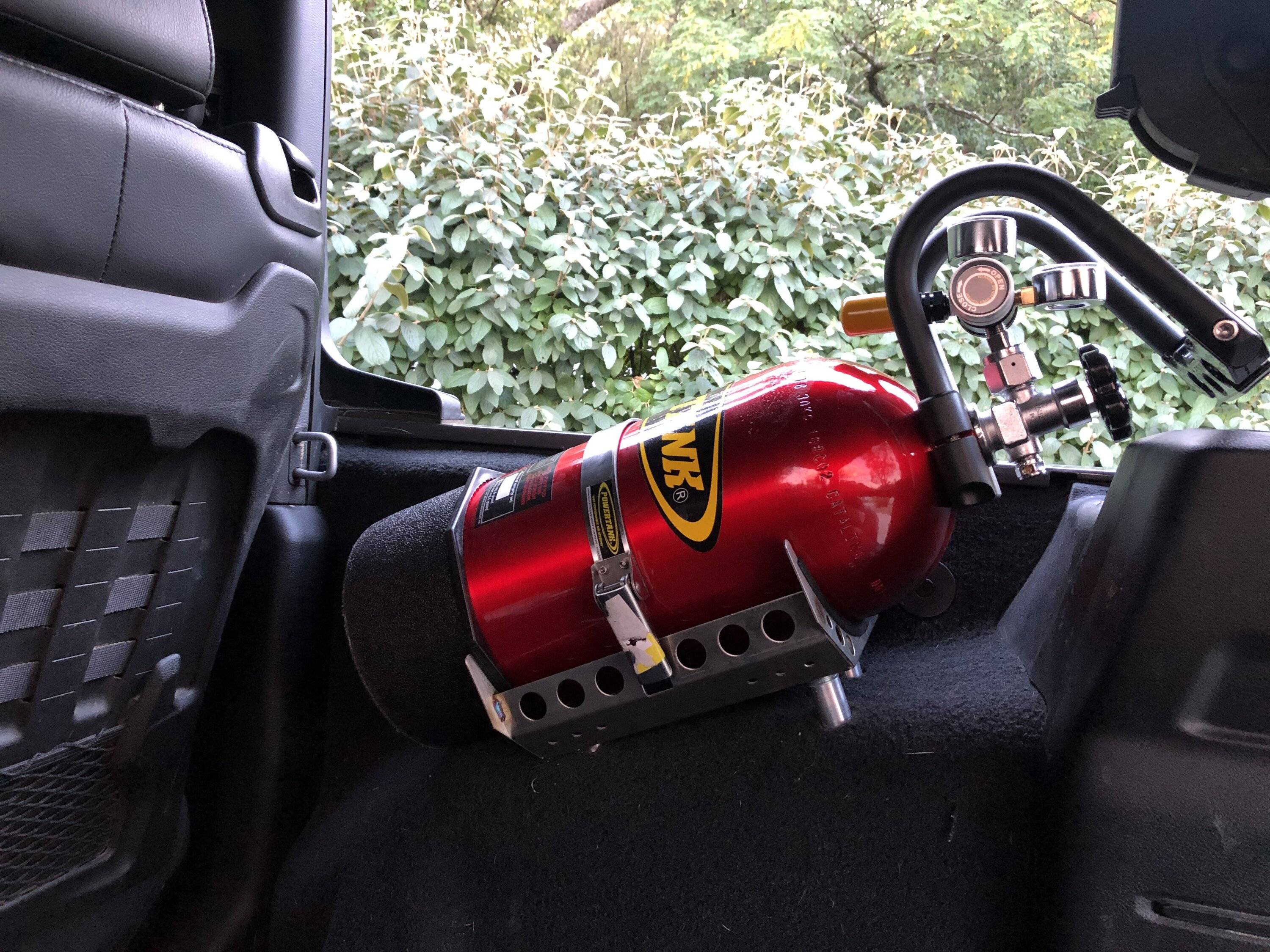

I mounted mine on the rear passenger side fenderwell. Used nutserts in the body. Works like a charm.
I'm working on the same issue in my Rubi 2 door - can you post of a pic of your mounting?
