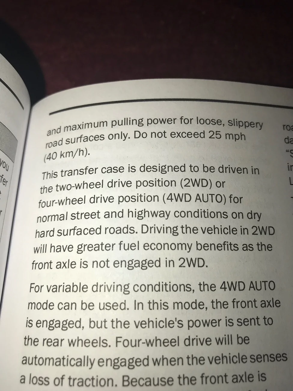

Since such slick, especially intermittently snowy, icy, wet conditions are the best use case for 4-auto I consulted the manual
Jeep Wrangler JL Snow driving - which 4WD mode? BA5559B2-D860-42ED-9BD3-DC045B6D3D03
Note the word “dry” Now more confused. :facepalm: :clap:
added bonus- the model with the worst fuel economy doesn’t get a 2wd option. Well done Jeep.👍 I wish I was at least half joking.

"Driving the vehicle in 2WD will have greater fuel economy benefits..."
Can. Confirm.

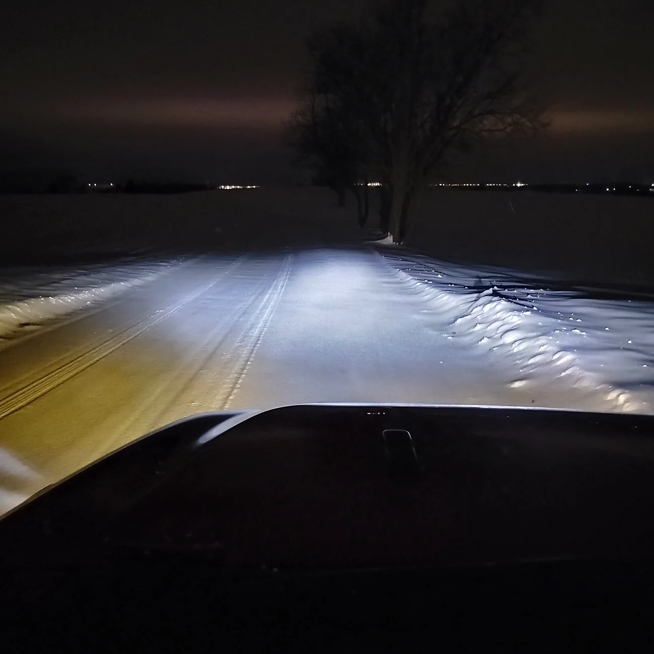

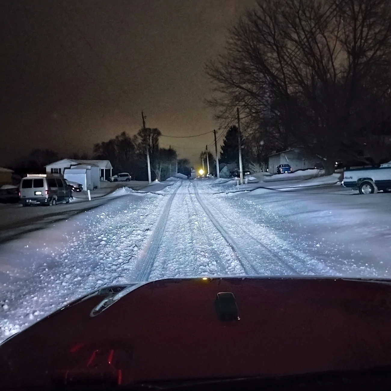

I was oot and aboot for an extended period last Sunday evening, after a long day of vigorous snowfall, chasing -- and finding! -- virgin road surfaces. 4HI was of course engaged. I left ESC engaged, too, meaning I wasn't purposely hooning. That playtime cost me a solid 2 MPG, but it was totally worth it.
It's also worth mentioning that the studded General Grabber Arctic LTs acquitted themselves pretty well.
Can. Confirm.

I have a Tazer, but haven’t used forced 2wd out of fear of warranty denial on the weak point 4 auto TC should the damn clutches fail. Perhaps it would make it easier on them- 🤷🏼‍♂️
Just a TC module for my 15 GC was $1240
warranty edit- see “dry”
