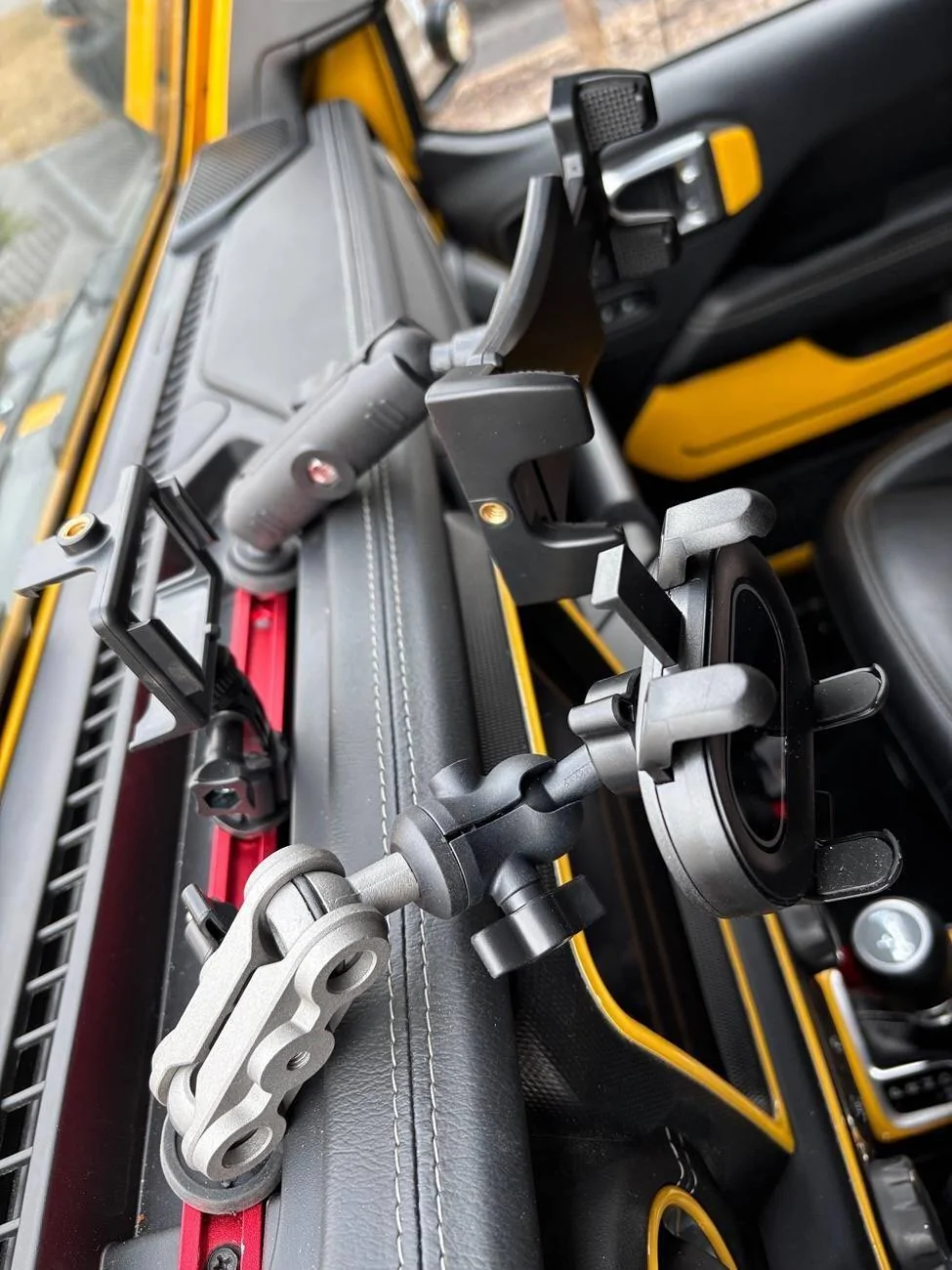

This was a very simple accessory mounting system that didn't start out simple... I actually tried various mounting techniques and settled on this very simple, and surprisingly secure result.

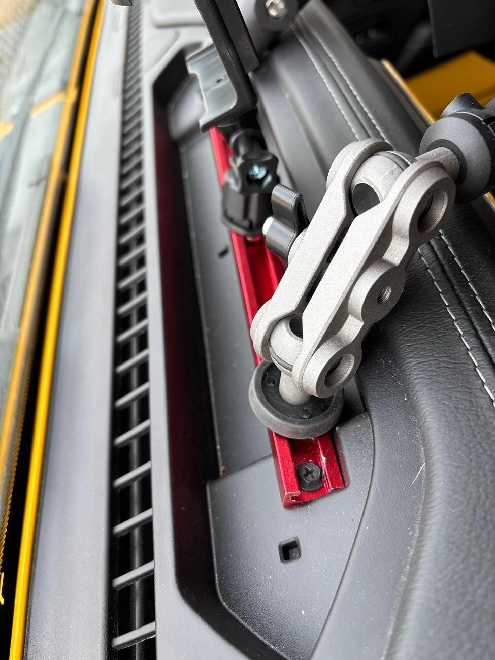

This uses the OEM screws and location to secure an aluminium T mount rail purchased from Temu under the description in the image.
Jeep Wrangler JL SIMPLE JL DASH ACCESSORY RAIL MOUNT 1743010260564-m9
The 30cm rail will need to be trimmed and 2 screw holes drilled in a precise location and size for the OEM screw. And it only takes a few minutes.
