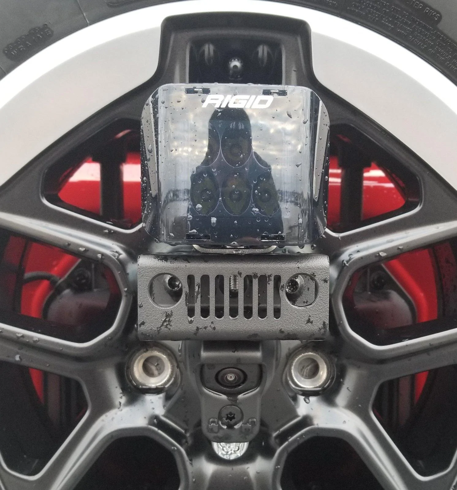

Rigid driving beam aux light on relocation bracket instead of the brake light(with smoke cover can hardly notice there!!)

How did you wire the light? I’ve been scratching my head for a good option for extra back up light.

I ran the wires through the tailgate check strap. Basically, and carefully as to not break any clips, removed the plastic backing of the tailgate with plastic dark removal tool. I then ran the wire from the auxillary light through the hole/rubber grommet located on the outside of the tailgate(located behind the spare tire and is the same hole/grommet that is used to run the wire from the 3rd brake light). If going to do the install remove spare tire. From there just run the wire once through the hole/grommet along the back/inside of tailgate(zip tie the wire in place as you move along for a clean install). Then run the wire through the check strap. From there just run the wire along the top edge just under where the hardtop/soft top meets the body tucking the wire under the carpet as you move along. Now I just hooked it up to the interior wires connected to the switch bank but if you dont have the switch bank run it through a drain plug in the body tub and direct to battery. Make sure to use wire connectors and heat shrink tubing, a nice clean collected installed will go along way and last a long time(yes, I'm OCD like crazy when it comes to my work). On a scale of 1-10 on difficulty it was about a 3. The ARB dual air compressor I wired and hooked up today is another story. Good luck!! Let me know how you make out!

Thanks. Great instructions.
I got the Aux switches but I think I’ll get power somewhere in the back and use a relay to power with backup lights.
Someone said there is a backup light signal on the tow plug. That would be the easiest, I think.

Sh#t...I didnt even think of that. keep me posted on how you wire it to the tow plug I'll most likely rewire it.

Actually bud, I would wire it to a switch on the dash as to be able to turn it on and off. The light really comes in handy for other uses and not just for backing up - like extra lighting when hooking up your camper etc.
Good point, but I also want it to come on when I shift to reverse without having to push a button
