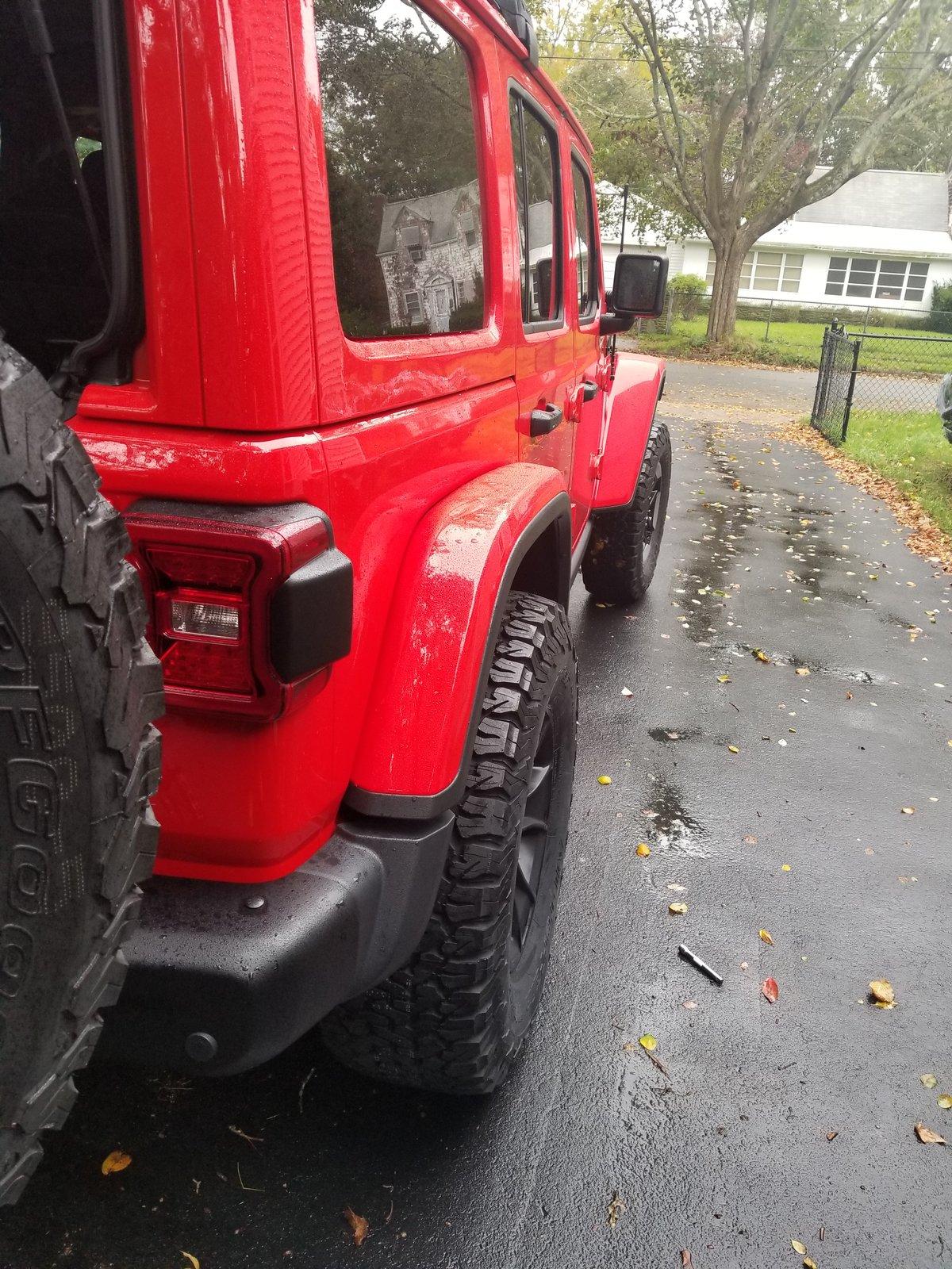

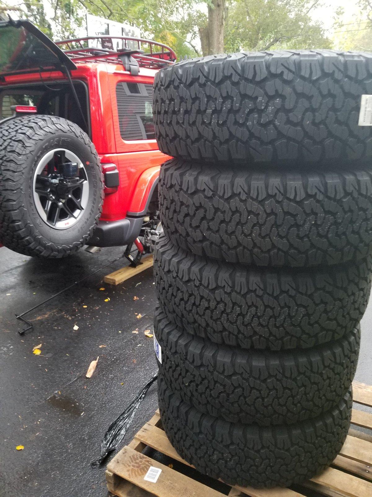

Putting the 35's on now...love em'!!!Here are a few
The Mopar are perfect fit
I added a few with my Ikamper RTT
Lift next week!!!!

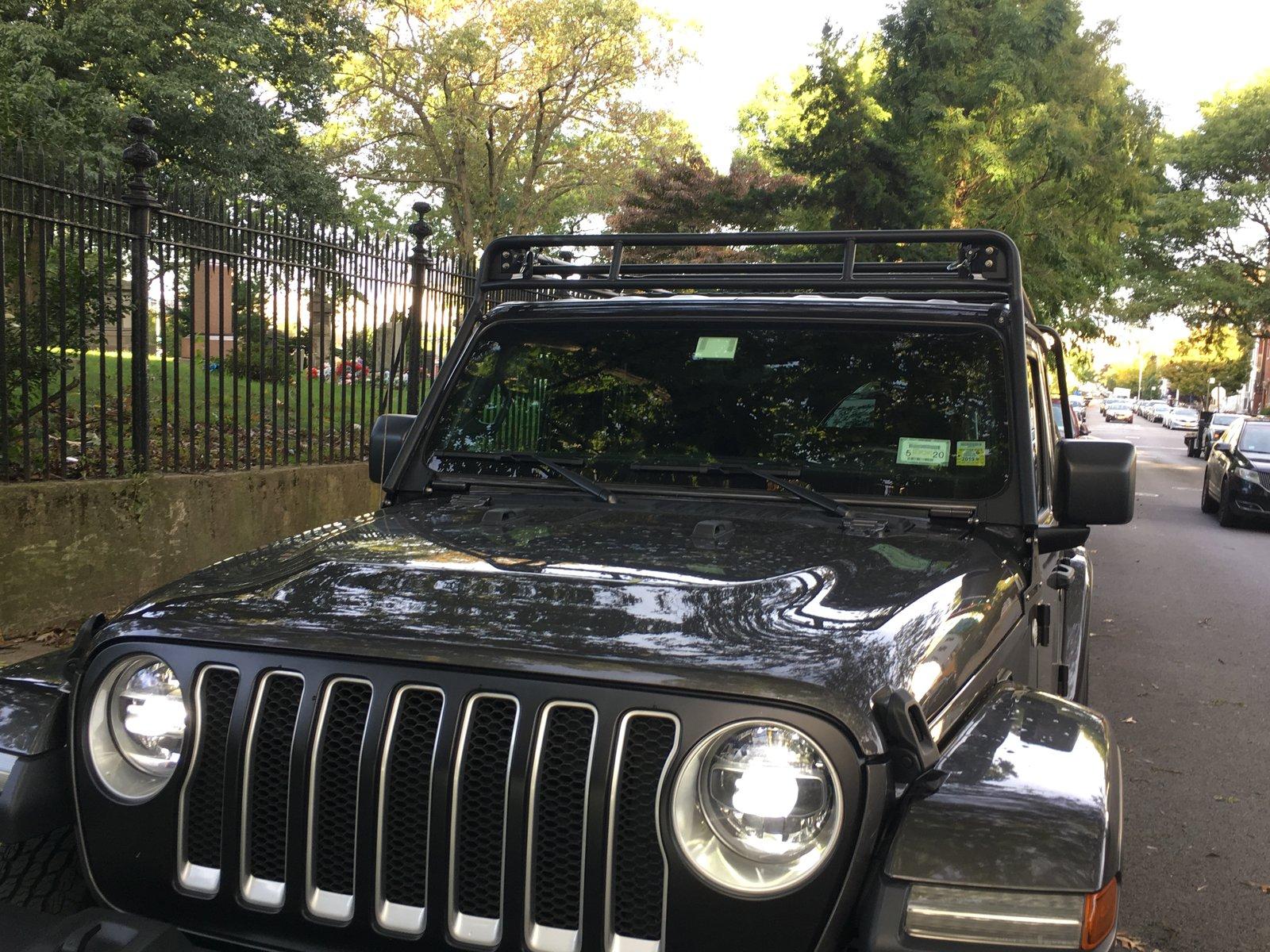

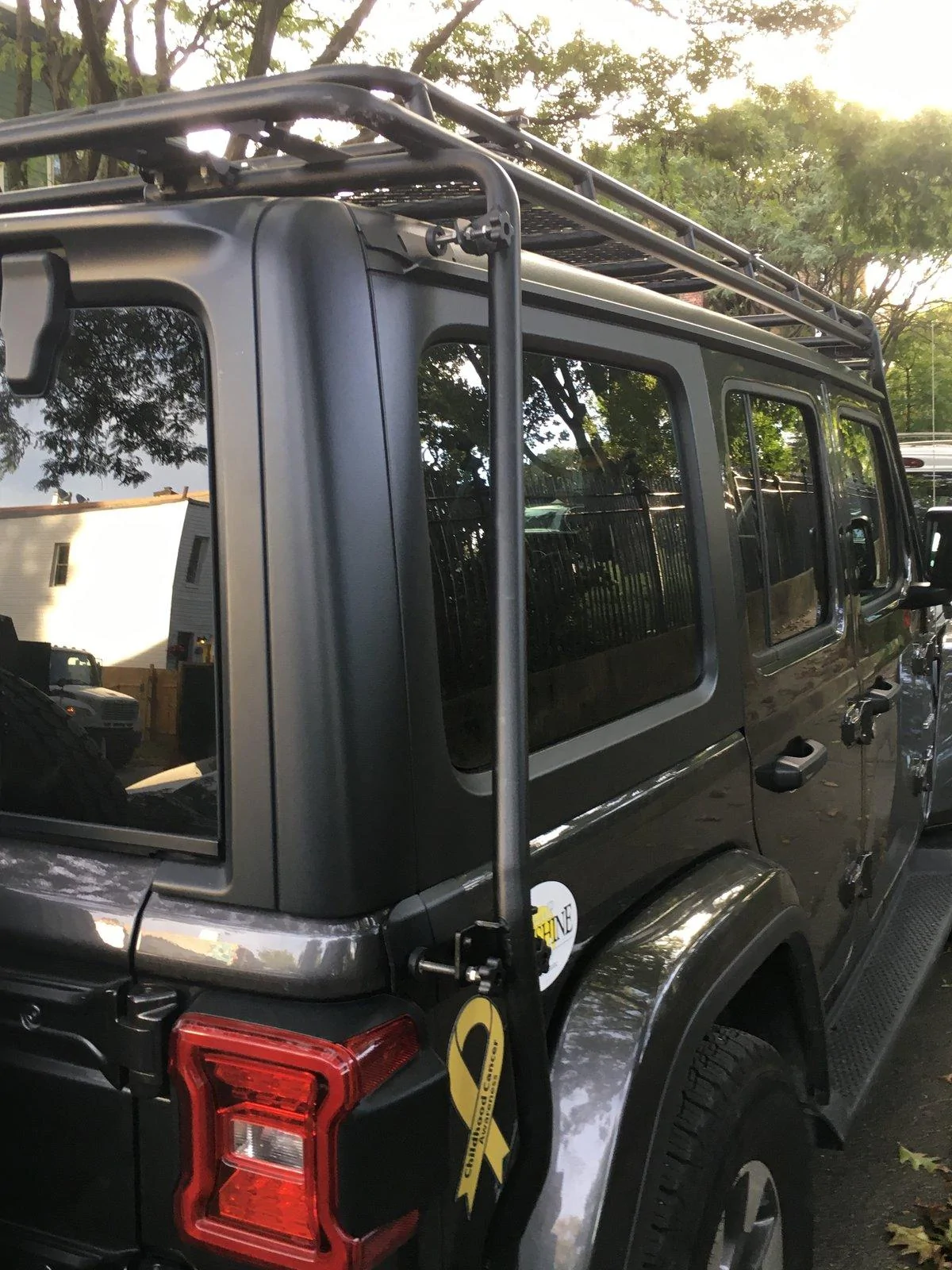

man that rack looks awesome. nice addition!my first major mod - Gobi Rack. Took a little bit to get it on because the designers assumed the rear bumper assembly on a Sahara was the same as that of the Rubicon. I called them and sent pics,they fabricated pieces to fit and shipped to me in about 3 days - the folks at Gobi were great. I still need to mount the ladders and wind defelctor, hopefully will get to that next weekend.
Told my dealer if I see one dealer tag on my new Jeep there would be hell to payman that rack looks awesome. nice addition!
but if Manhattan isn't your own business, you gotta take that dealer logo off...like yesterday.
