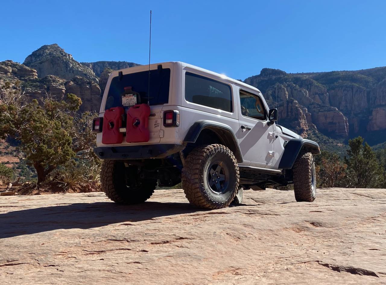

Thanks for the link, I feel like it's pretty reasonably priced.
youll need a t55 for install. The factory door hinge screws are tight and make sure the t55 is fully seated before unscrewing. These screws are known to strip easily. I used a dead blow hammer to gently tap the t55 until it was firmly seated within the screw.
Jeep Wrangler JL Should I remove my rear tire? 60F6474F-F49D-4003-A753-2183093BC906

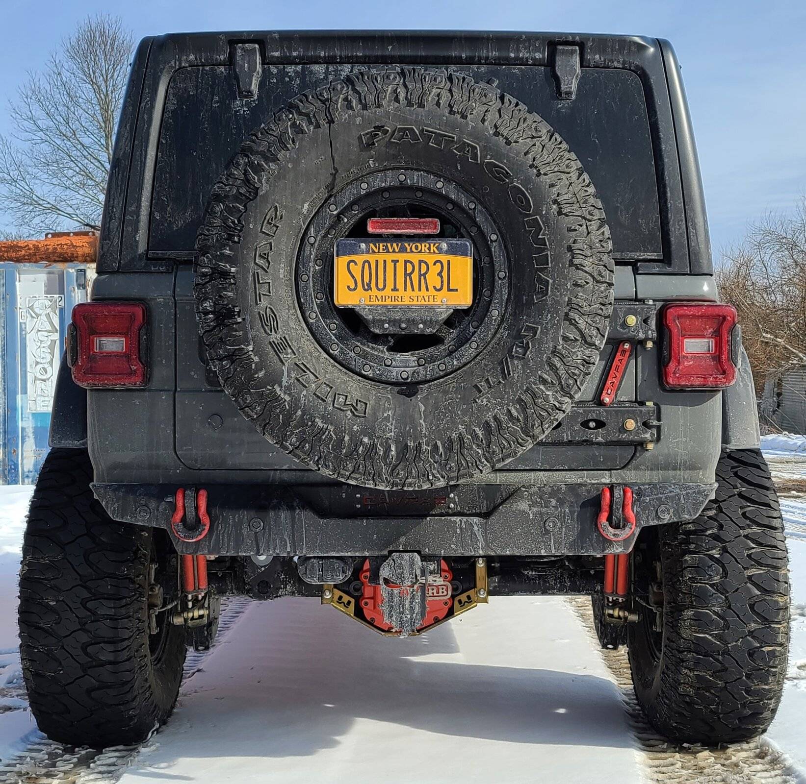

The main reason I want to delete it is because most of my rear window is blocked by it I can’t see if a car is tailgating me.
As a former tri-state-r… why do care if someone is tailgating you. I question why you’ve got f**ks left to give.
You know Albany isn’t tri-state, right?
