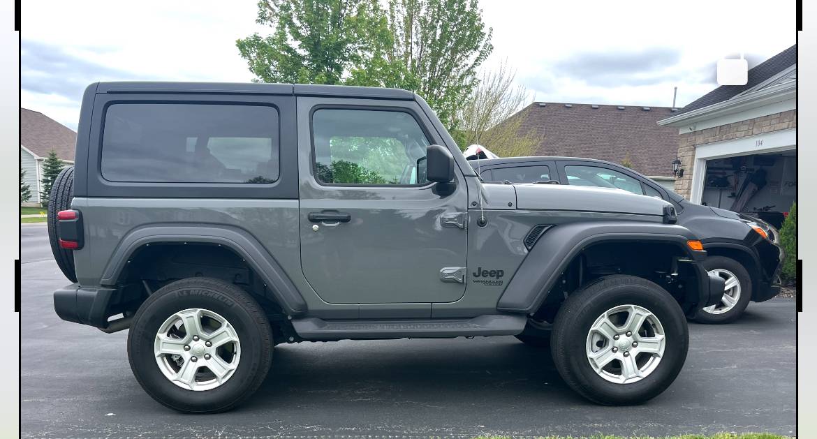

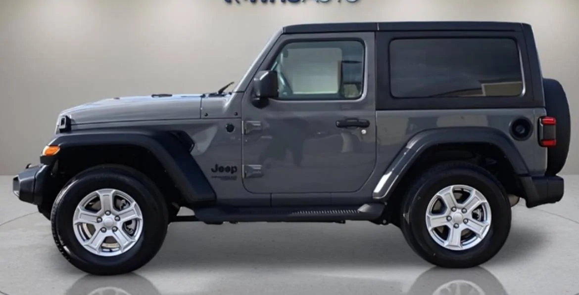

I just put Rubicon shocks and springs on my 21 Sport s and I gained 2.5 inches .
I read it would only raise it 1.5-2
I must have measured it 10 times to make sure I was seeing right
Very happy with the change , now it’s time for new tires
Before and after pics
