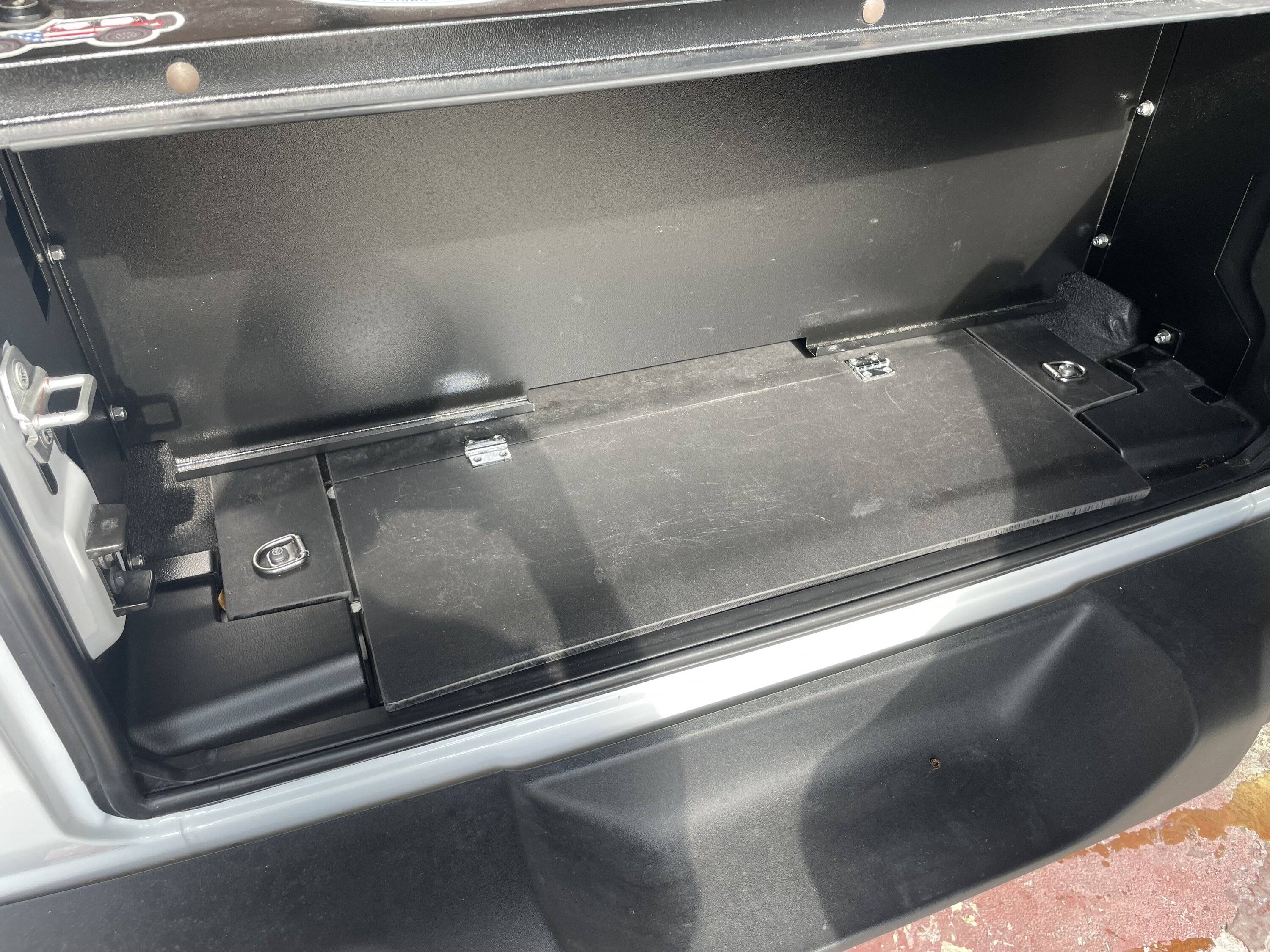

I replaced mine with one I built myself, pretty easy to do.
I used 1/2 inch Starboard, a Marine HDPE.
Just take the old one out along with the two little side pieces where the tie downs are and trace it or measure and cut it out. I used some cheap stainless hinges I already had, reused the tie down bolts but without the plastic covers and took the bolts for the clips in the front out and matched them up with longer ones I just sent through the front of the board into the existing threads in the Jeep.
I used heat to bend the lip down but it did work before I bent it as well.
I have no carpet but I do have the BedTred Liners on the wheel wells which extend back near the trunk as well .
sorry I don’t have better pics, I didn’t take any before putting the seat back in and locking trunk, and with 2 car seats on the seat I don’t want to take it all out again.
