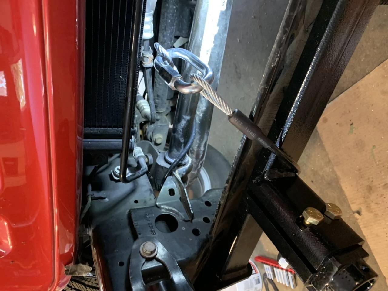

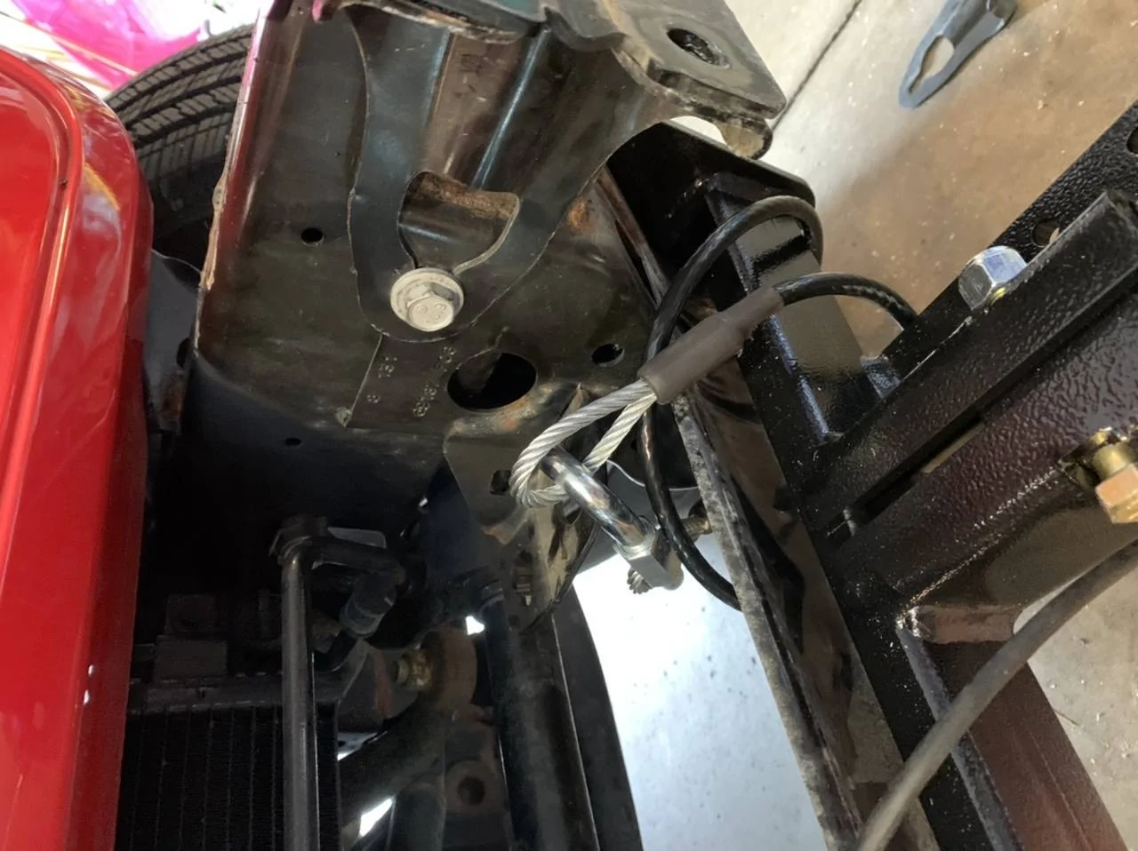

Doing the install at the moment for the e trailer baseplate for our JLU. Scratching my head on how to route / loop the frame safety cables. Driver side I followed the e trailer video and looped the cable around twice and attached the ring to a frame point. They glossed over the passenger side install. Not seeing anything easily secured to on the passenger side. For now I am kinda looped around the anti sway bar. Thought or ideas on how to do it better

Never mind please got both sides figured out. Now I gotta sack up and cut more holes in a perfectly good Jeep
