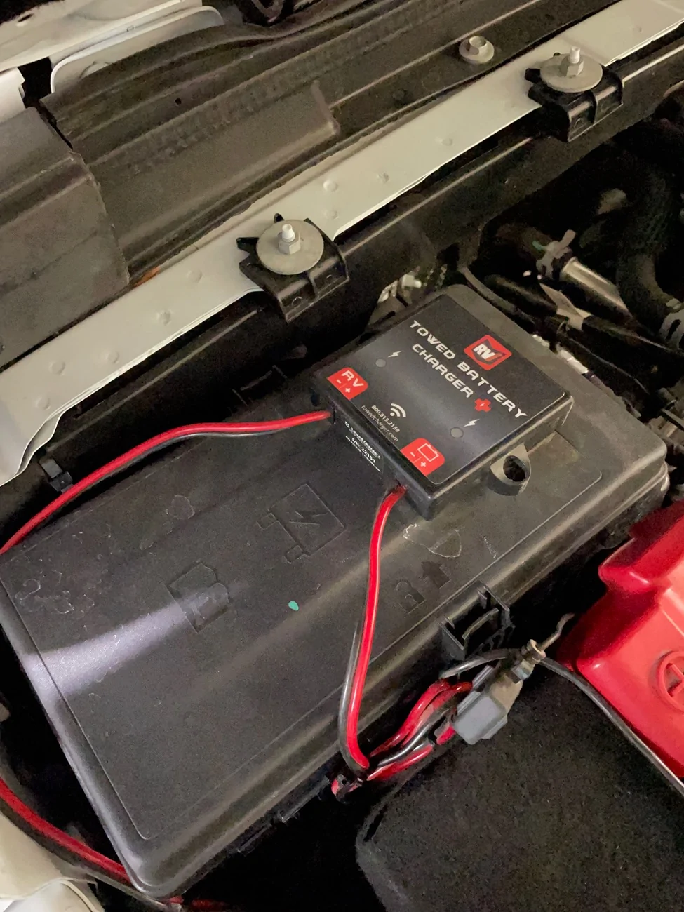

On mine I use a RVI Towed Battery Charger Plus witch can if needed supply 10amps to my batery. No issues.
GenY mega drop hitch 16k if needed to level
BlackHawk All Terrain 2 10k
Curt Towed-Vehicle RV Wiring Harness
RVI3 60 sec and your ready to go..
