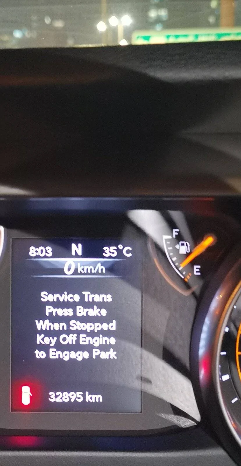

Hello everyone,
So this happened to my jeep, Check Engine light with Service Transmission.
Jeep won't move at all in Drive or Reverse. Towed to the dealer and after inspection, BOOM they told me everything is normal and nothing is wrong with the Jeep. I took the Jeep and almost a week of driving the issue never came back. So what was that?

Possibly a battery issue? These things start going crazy when the battery starts to die. If you don’t have the
e-Torque system then make sure you check both the main battery and the smaller auxiliary battery.

Check the fuses under the hood. All mine were loose and caused all kinds of weird sh!t. Press firmly and should feel a click.
