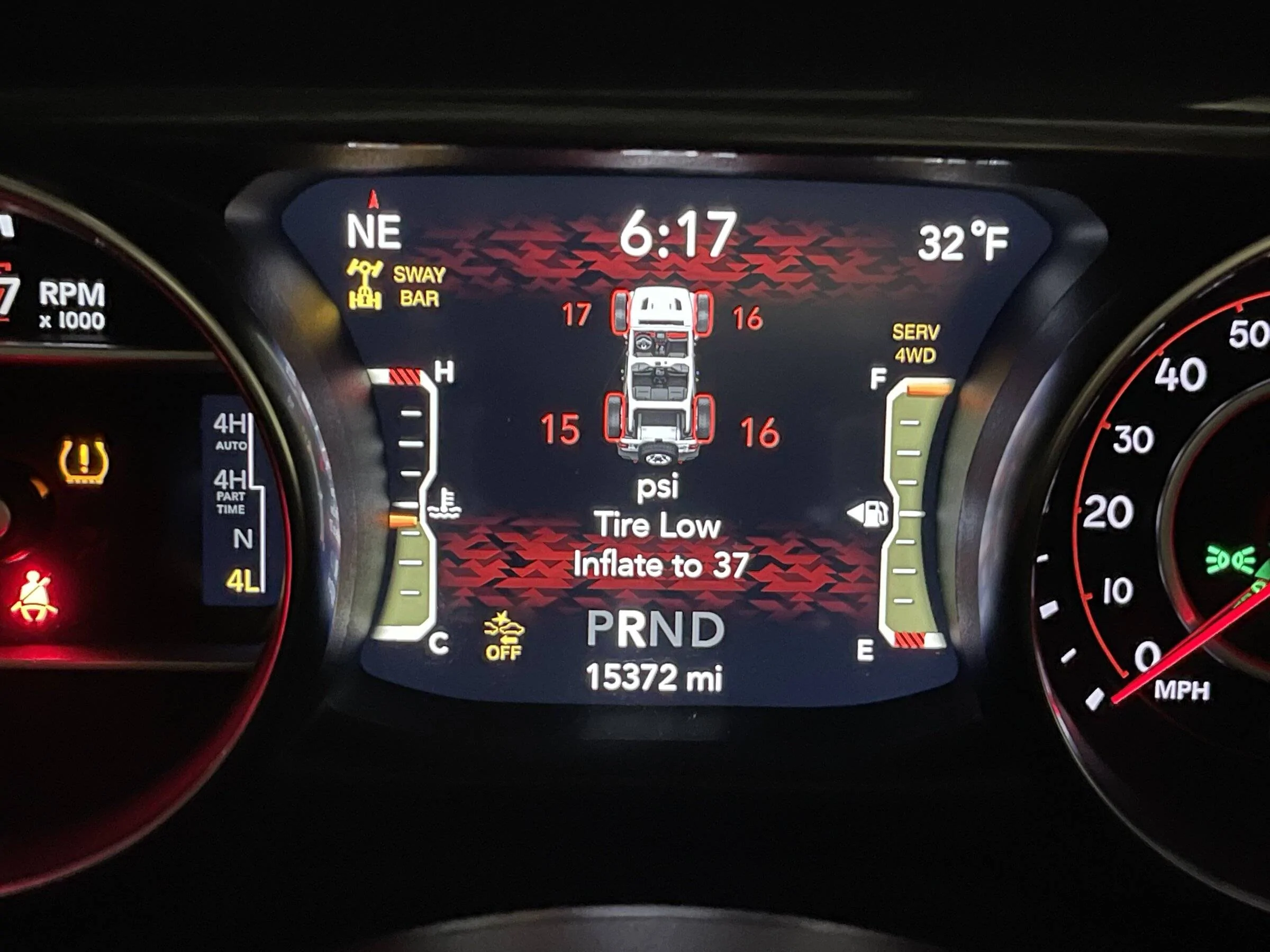

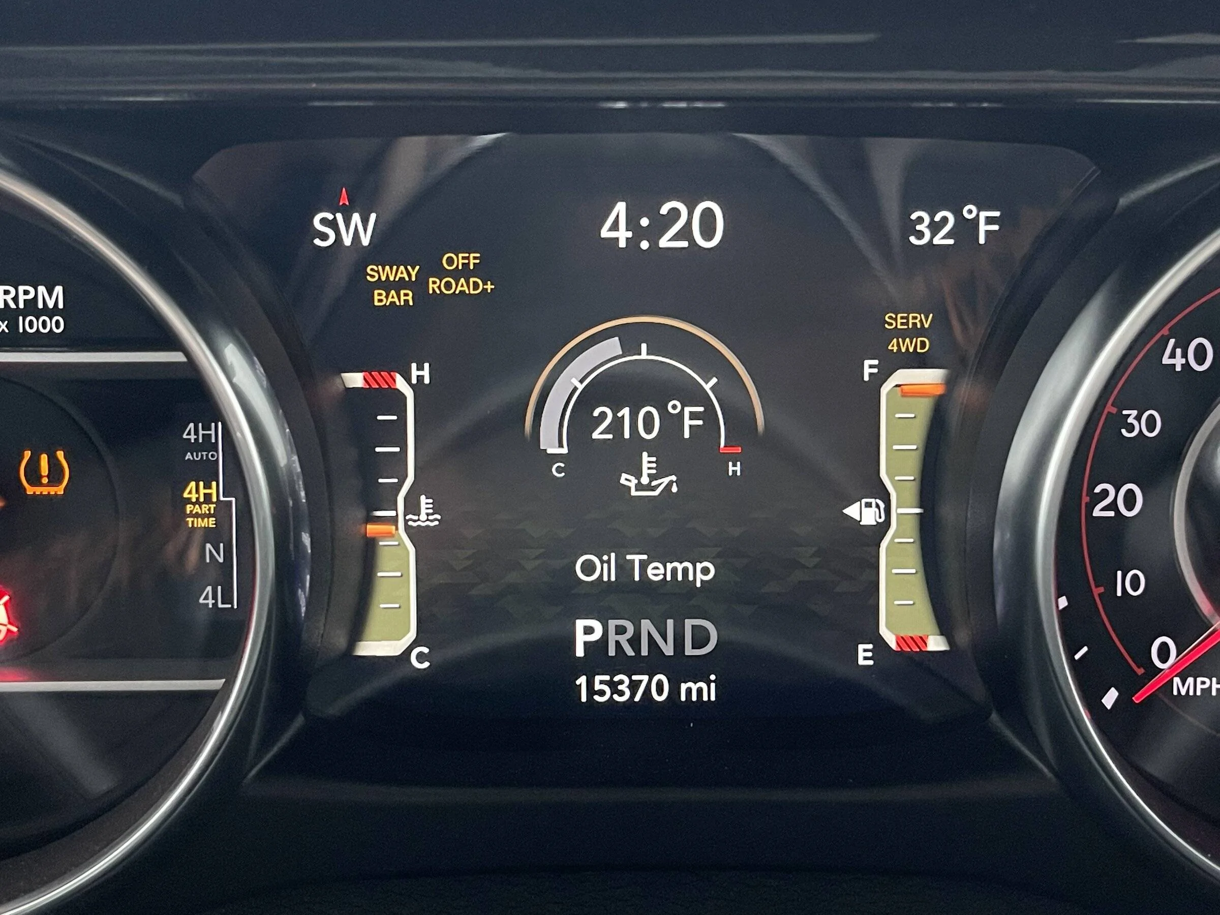

Have had the SERV 4WD light more than 3 times and tonight, when I need that damn Jeep to perform it failed me. Not able to lock either of the axle, it will show rear axle locker canceled, no 4WD. After shutting off the vehicle and restart I was able to regain 4WD but still no locker. Locker back online after couple hour doing nothing. So damn lucky I was with some competent friend and not get frozen in the mountain.

Are you running a Tazer? I was getting the same thing almost every time after shifting back in to 4wd auto (serv 4wd, no lockers, would fix itself after shutting off vehicle for a bit).
Was getting a C140E error (transfer case). Removed the Tazer and everything has been perfect since. Non-live functions work fine.
tazer was off, used it to change tire size then pulled off. Was always able to “fix” it after restart, but today is kinda strange, first time can’t engage locker..

I think every time I've got a serv 4wd I couldn't engage the lockers (but could unlock them if locked though). If your Tazer isn't installed I'd check the transfer case connector/wire (passenger side), and all four abs/wheel speed sensors.
Next time it happens see if the green 4wd status text disappears from offroad pages, should be a fairly good indicator it's a transfer case module problem.
Other than that, I'm out of ideas, sorry.
