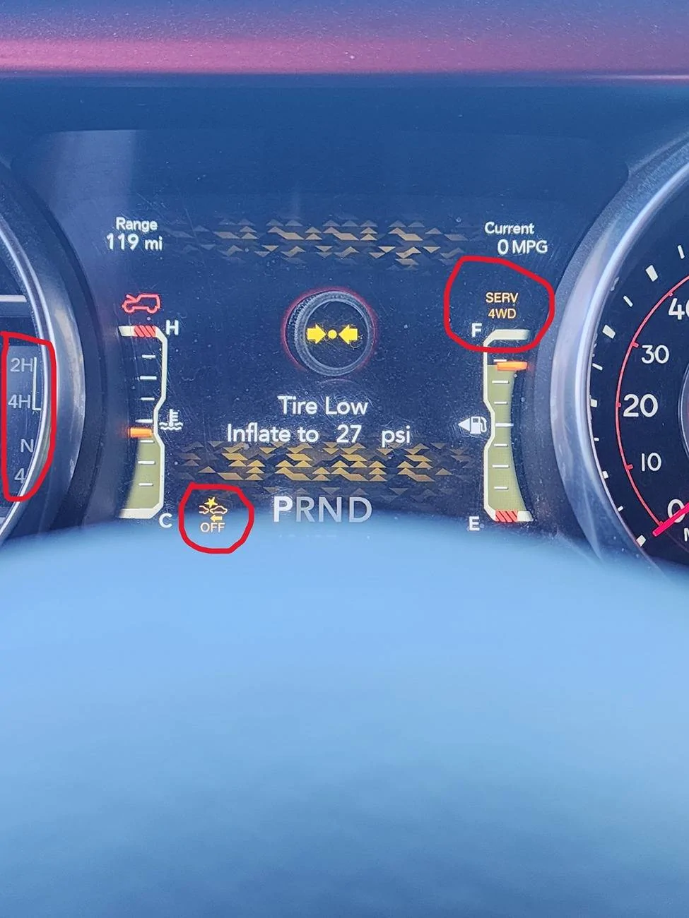

My vehicle symptoms:
  • Intermittent SERV 4WD light.
  • Intermittent going out of Transfer Case Dash Selector Lights (2H, 4H, N, 4L). Not necessarily going out when the SERV 4WD light comes on.
  • Traction Control Light coming on.
  • My SCAN Tool showed trouble codes with Fuel, CAT, EVA, 02S, ERG.
  • Losing function of taillight.

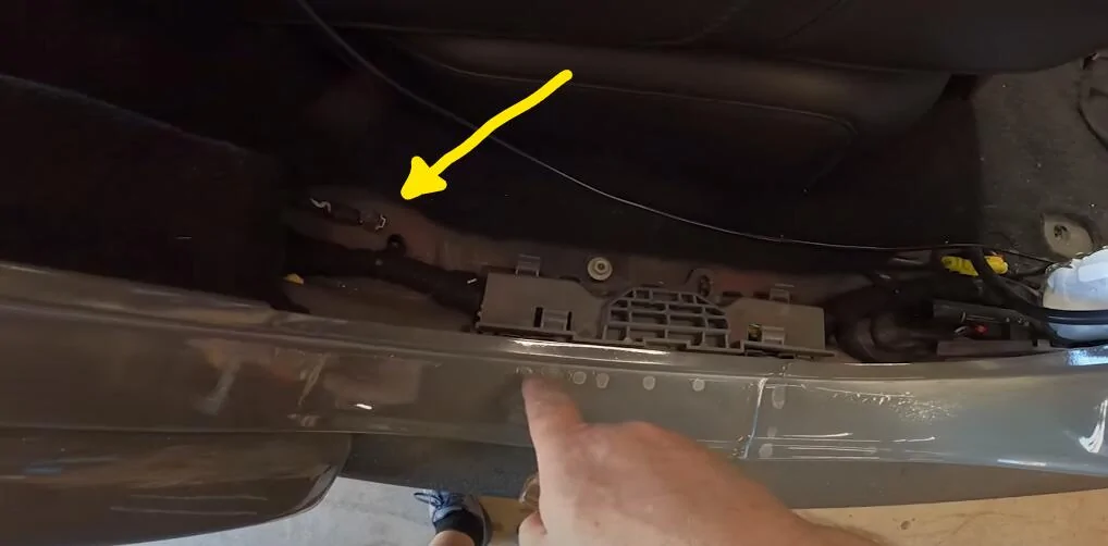

The solution at least for my situation:
I started checking ground posts and found that the nut on the ground connector located by the passenger side rear seat was loose. The ground post is beneath the plastic trim panel just before going up the wheel-well.
I was able to replicate the symptoms multiple times by removing the ground wire from the post. Once resecured, the symptoms would clear up.
It appears that even when this nut seems tight, it needs to be tightened down enough to where the inside base of the “U” wire connector is secured to the base of the ground post. I ended up torquing this 6mm nut to around 80 in-lbs., but it appears less (about 60 in-lbs.) would also do.
I don’t think it matter if it came like that from the factory, because apparently this ground post nut was secured enough for a long time until it either lost good enough contact or worked its way loose enough to cause all the above symptoms.

Wow great find! How did you think to look under the trim panel for a ground point?
You're talking about this guy?
Yes, thats it. I had a slight feeling the SERV 4WD, Fuel system codes, and taillight malfunction was related. Basically, why all these problems at once.
Continuing with my inspection I started at the back of the Jeep, pulled off the rear bumper, took out the taillights, took out the plastic trims.
First ground post I ran into was in the rear cargo area Driver side by the power outlet. Felt silly doing all the work, but pulled and cleaned it anyways. Next ground post I ran into was that one which was loose.

Incredible troubleshooting. Nicely done and thanks for the detailed information!
